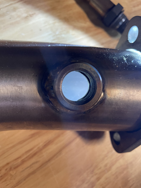

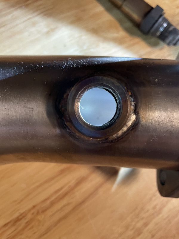

Just finished the install. It fought me quite a bit, and one of the O2 bungs was welded crooked so I had to do some dremel work, but so far so good.

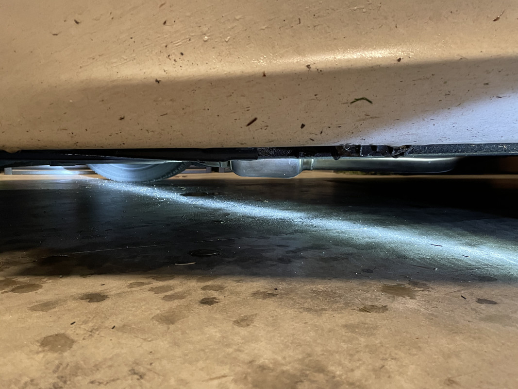

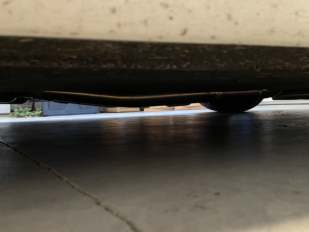

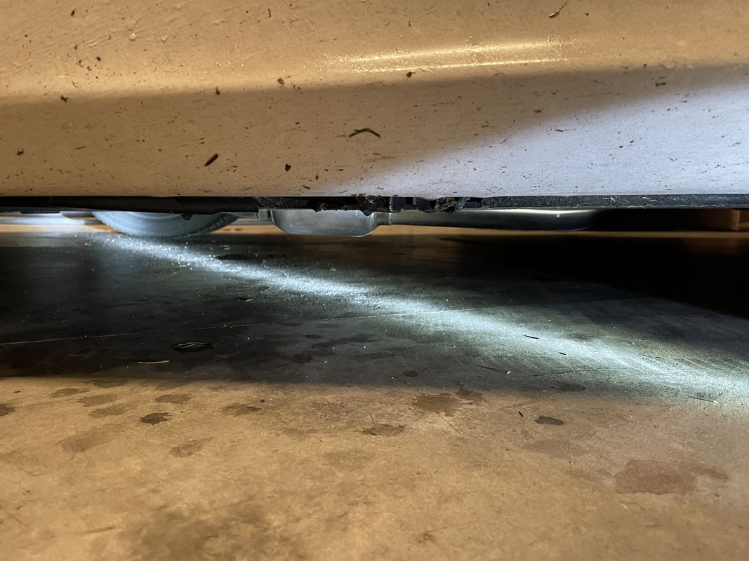

Did anyone else lose some ground clearance with this install? I never used to scrape leaving my garage but now the cats graze the concrete just slightly on the garage-to-driveway juncture.

^ Not sure I’ve read about AFEs scraping, but most replacement midpipes with cats in the primary position (eg ESS, Fabspeed, AA) do scrape because the cats are round and now hang lower. The original cats are pancaked shaped for this reason.

My car is relatively high for a car on coilovers (maybe 10mm lower up front than ZCP, if that) so I don't have any clearance issues that I didn't have before, but it's definitely about 1/2" lower than the stock pancake cats, and the cats are now the low point on the car. Going over the really big gradual speedhumps that the car has to straddle to cross is the only place I've had an issue, and then only once in 2.5 years, when I forgot to slow down and didn't go sideways either.
Fitment wise, that sounds about right. It wasn't exactly an easy bolt on/bolt-off. The good news is, once you've got it all put together in one piece, it will go in and out in one piece too. Was very easy to get in and out when I did my carbon driveshaft

Some pics from my install, including the necessary dremeling to get the driver front O2 sensor to fit (shitty weld alignment). You can see how far the cats hang down.
