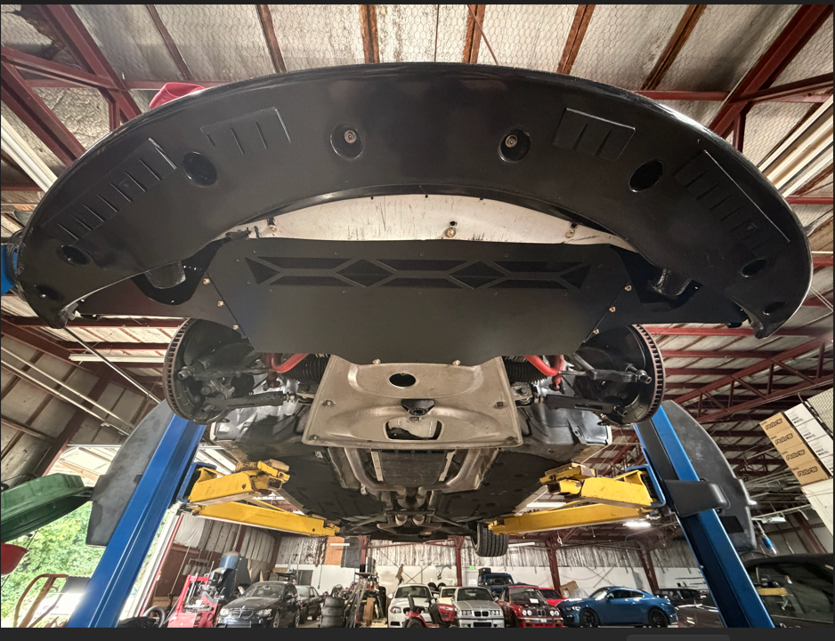

Door cards are 90% in and functional. Need to finish the fine tuning as the doors don't shut as easily as they did before the cards were in.
Very happy with how they turned out.
Also, got an EPM undertray and new front liners installed, so that's now out of the way.
Last small part is figuring out these sticky brakes. Driving they randomly engage and you can feel a slight pull on the car. I've bled the living daylights out of them 4 times (including the abs procedure) so I am going to swap pads before ordering a rebuild kit.
Next is Dyno Day this Thursday, any guesses from anyone what she will put down? Dyno Dynamics Roller Dyno.
