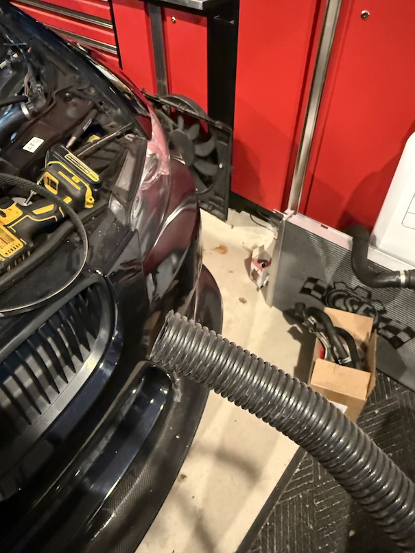

stop by any time! and yeah, my $600 electric bill this month says the 10KW heater is doing its job, but the new insulation isn't

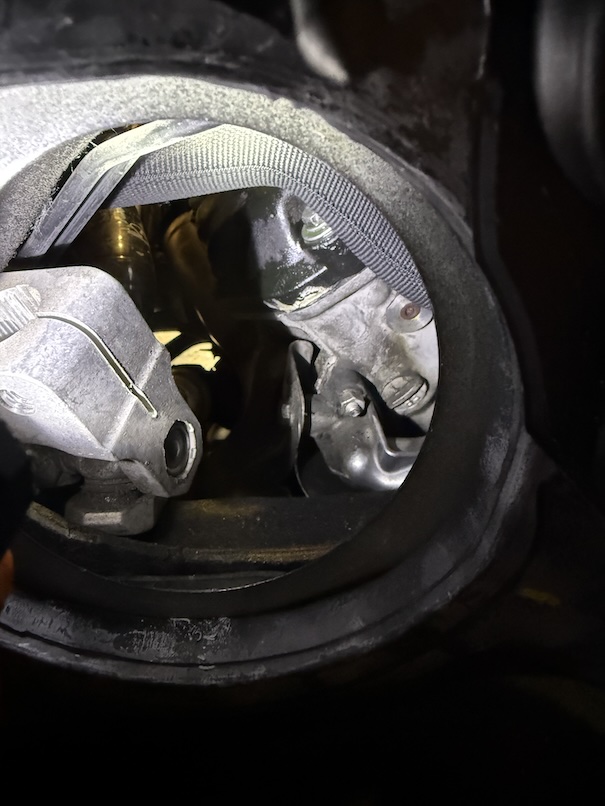

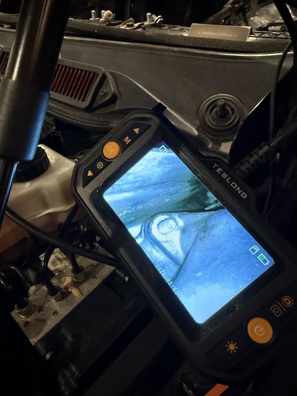

it's out! man what a pain in the ass. the only saving grace of this job is that it's not going back in. i don't want to think about having to put that back together if you were doing the heater core.
in other news, i spy with my little eye...
the harder to get to EGR valve. though cursory attempt at getting at the bottom bolt didn't work so i'll have to take a closer look and see if it actually makes anything easier.

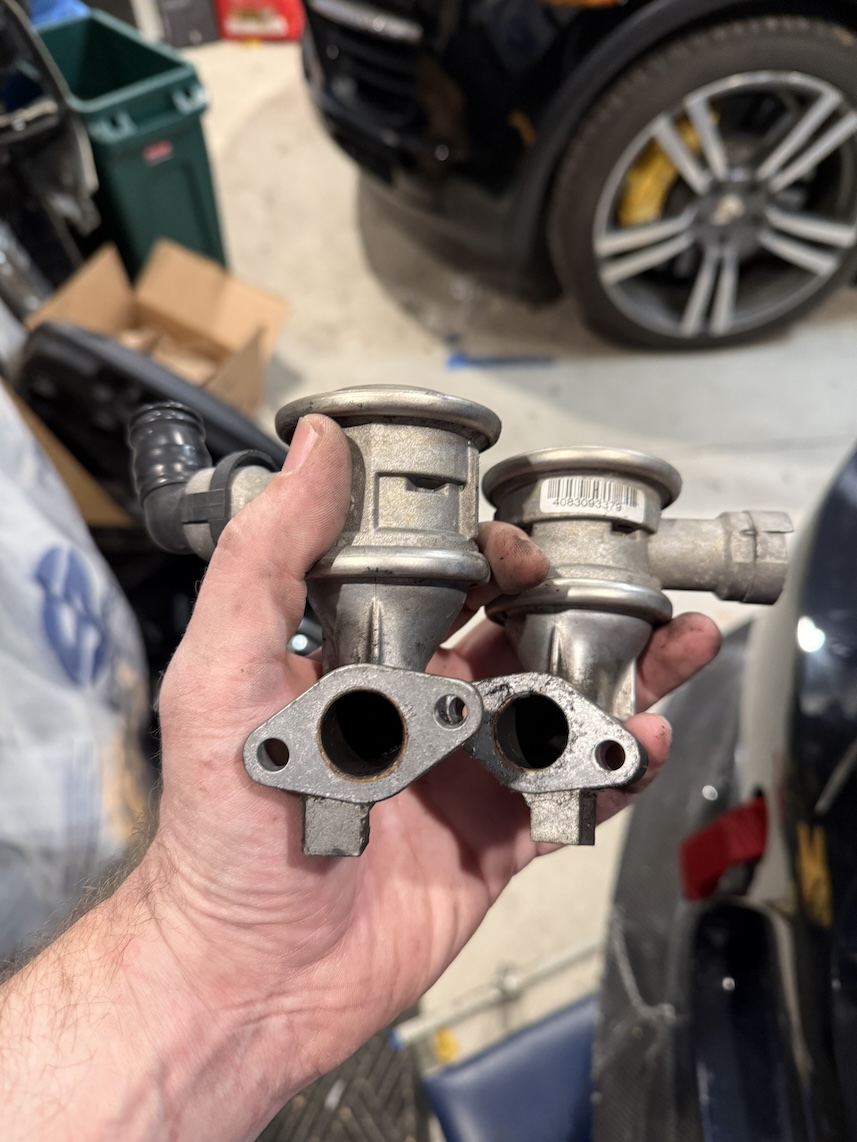

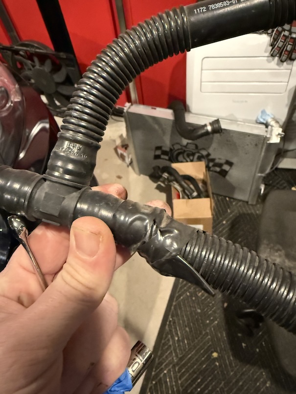

ok, so the cabin access didn't do anything for the EGR valve spelunking, but not having the hard AC lines, and the coolant hoses going to the heater core definitely did. i had started down the path of disconnecting the DME harness, but then stopped at just the coil packs. with those lines out of the way, i was able to get at both banks pretty easily. still involved skinned knuckles and macguyvered tools, but overall not as terrible as what others have had to deal with
oh and a possible explanation for my occasional SAP codes, since the gallery was pretty clean: a duct taped and cracked hose. sigh.

      12-18-2024, 01:02 PM   #93
Track/S
Track/S's Avatar
3457
2,582
Drives: M2C, M4 GTS
Join Date: Oct 2019
Location: Around the world
Cut with a cutter where I have marked and replace it with a silicone hose, those plastic ones dry out and crack over time.
DrFerry10035.50
      12-18-2024, 05:34 PM   #94
kolosy
3480
3,626
Drives: over potholes
Join Date: Dec 2008
Location: Chicago
But then I’d be throwing away the broken one and some perfectly good silicone hose
I’m doing an sap delete, I was just commenting on the crappy repair job by one of the POs
amg6975865.00
      12-19-2024, 12:26 AM   #95
Track/S
Track/S's Avatar
3457
2,582
Drives: M2C, M4 GTS
Join Date: Oct 2019
Ah if you're deleting it then it's okay

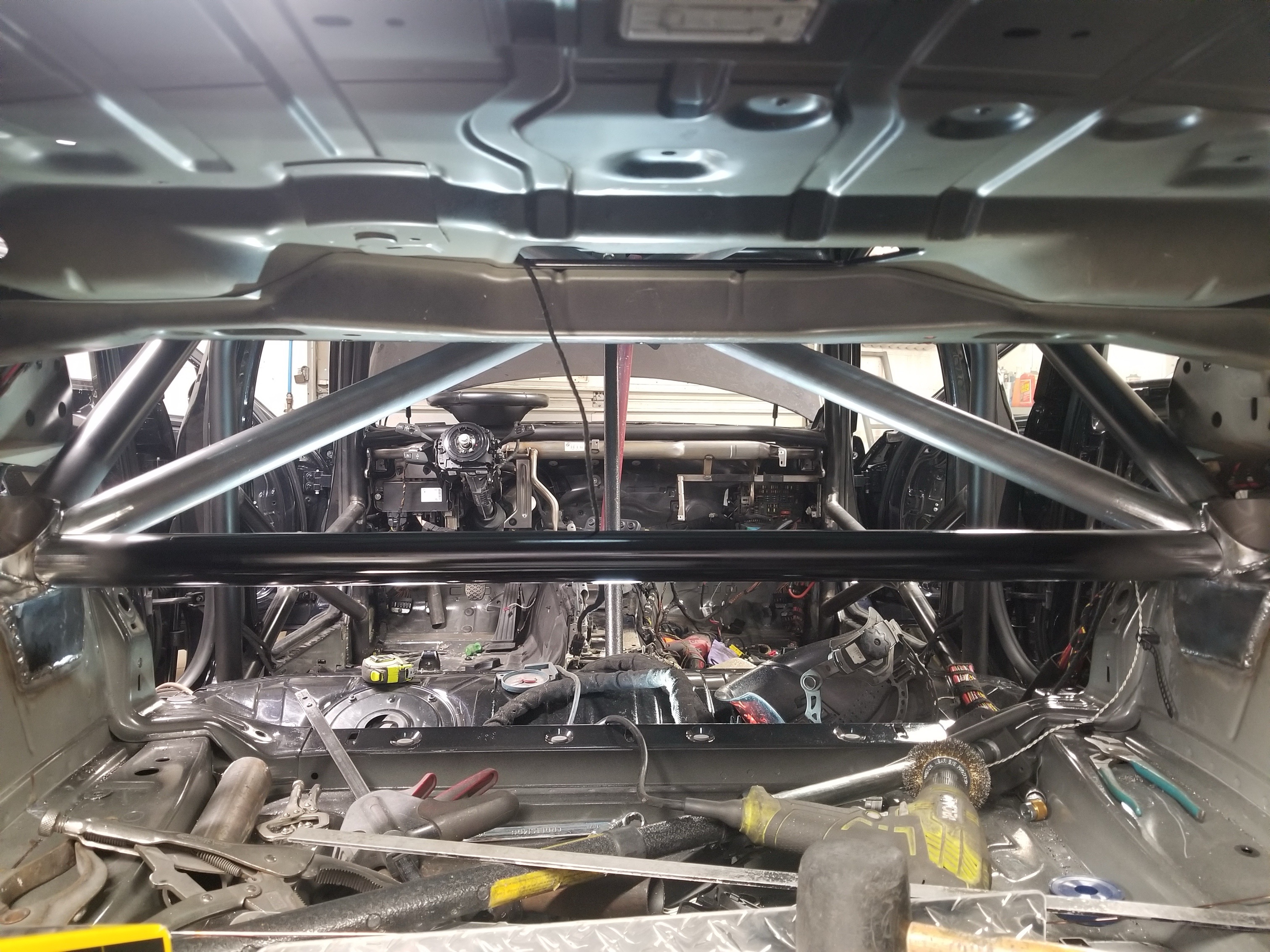

      01-06-2025, 03:28 PM   #96
kolosy
3480
3,626
Join Date: Dec 2008
Location: Chicago
It's gettin' close! Confirmed drop-off date with Mark McMahon in a few weeks, and I think the things I can do are just about done. So far, I've stripped the entire interior, ripped out the AC and SAP system, and found and swapped over a counter clockwise PS pump. Oh and the roof. I'm waiting on BK mounts (have been for 6 weeks now unfortunately), but finally have a tracking number and that should be here on Wednesday. Once that's here, I can put the seats in, button up a little bit under the hood, and it's off Mark for the cage. Very curious where we'll land weight-wise, but obviously won't know that for a while.
I also ended up ordering the aluminum floor plates from VAC. I talked to Mark and he figured it would be cheaper to do that than to have him custom fab one. Will need to figure out a dead pedal solution though. The OEM one is molded into the carpeting, right? I tossed it and can't remember if it was detachable.
Oh and I bought a tool cart. Because I spend 15 minutes out of every wrenching hour trying to find where I put the wrench I was using 5 seconds earlier. Maybe this'll help.
      01-06-2025, 03:48 PM   #97
berns
1849
708
Drives: '07 E90 335i
Join Date: Feb 2013
Location: Los Angeles, CA
I really like the Macht Schnell clubsport mounts but if you're doing a full cage you should have all your eyelets for harness points welded to the car anyway.
The OEM dead pedal is part of the carpet. When I first pulled the carpet out, I cut the dead pedal portion and reinstalled it but it was not pretty. Served its purpose but not meant to be used that way at all.
When I had my cage done I had my fabricator make a dead pedal and mount it to the floor & cage. Haven't driven the car yet but I think you'd want it to be further back and further from the pedal itself if possible, but things get very tight with the bars down there. We'll see how it goes. Will be better than trying to use that awful Carbon-Tec foot tray, that's for sure.
kolosy3480.00
CamasM3e934798.50
amg6975865.00

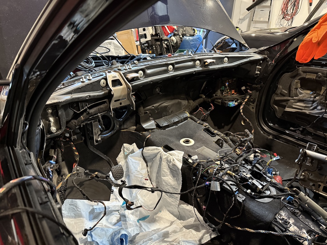

Before driving her over, I managed to pull the audio harness. It's pretty amazing how much wiring there is *just* for that. I started poking around at the other bits (airbag, seats and roof center) but all those require digging into the main loom and I just didn't have time for it. I don't think I'll have issues accessing them once the cage is in, so I just asked Mark to move any free tails to the dash area and I'll deal with them later.

      03-21-2025, 09:10 AM   #107
kolosy
3480
3,626
Join Date: Dec 2008
Location: Chicago
Oh man … it’s gettin’ close. Cage builder has been sending me teaser pics and car should be getting picked up next week. Looking pretty awesome so far.
a5m1593.50
CamasM3e934798.50
DrFerry10035.50

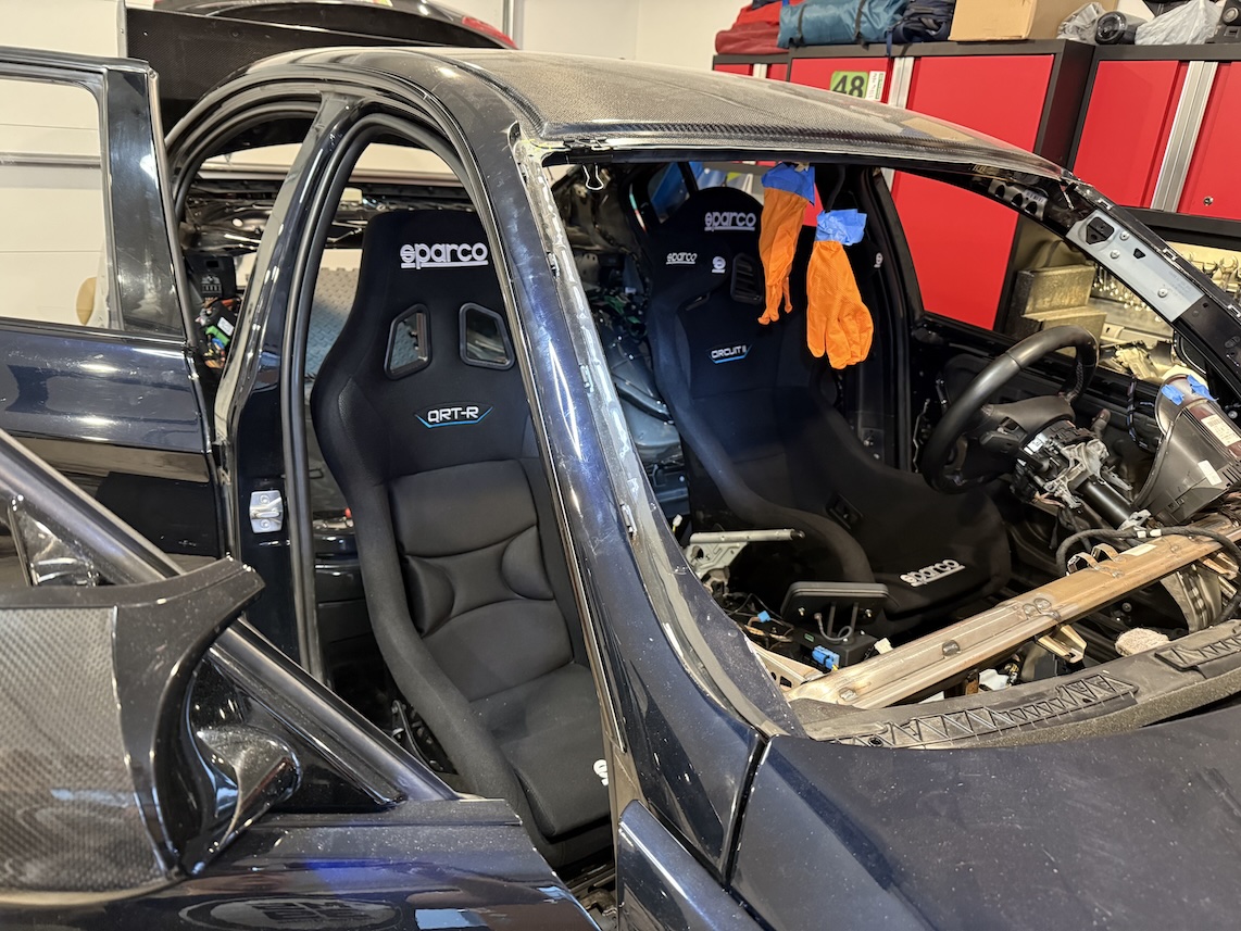

She’s back in action! After hacking through 2 dashboards, getting ripped off by my shop for an alignment and corner balance, and rushing to get everything back together, I finally got to the start of the track season. Went to my local 2 miler, and on the first session out (after a 6 month break because the Midwest), I PR’d. Not surprising given that it’s about 350 lbs lighter now, but still a nice welcome back.
Over the winter, I ended up doing a fair bit of prep and here’s where we are now:
- CF roof conversion
- Full interior stripout
- Sparco Circuit 2 driver/QRT-R passenger with Brey Krause mounts (OE slider for driver, fixed passenger)
- Mad-trace quick disconnect wheel
- Flight eGWS
- AiM Solo 2 DL + Corsa cam
- wing logic 72” wing (still to be mounted)
- li ion battery
- Heater core delete
- AC delete
- Single hump dash conversion
- Lexan rear windows
- VAC floor plates + matching custom dead pedal
- And of course the cage
With all that, car sits at 3380 with cage and 3/4 tank of gas. I was hoping for less, but the math maths. Cage added back a solid 150 or so.
