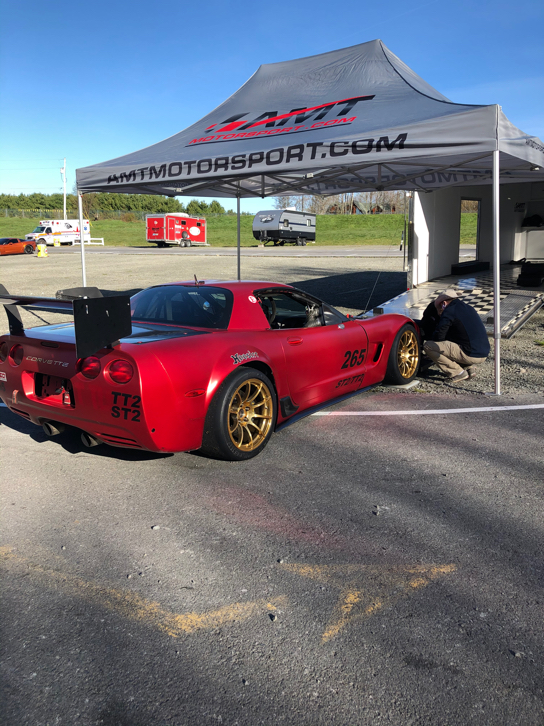

Beatiful day at NYST today.
Here is the 1:31 Corvette. He is going for the Viper record of 1:28.
According to the driver this is no excuse Corvette. If he does not do 1:28, he says it is on him.
315 Hossies on the front. One can only dream...

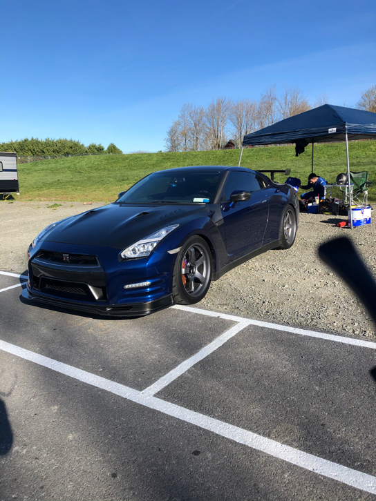

Beautiful GTR with R888R 285 front 315 rear
He says he is lucky to get one day on the fronts at NYST.
His best time is 1:37.

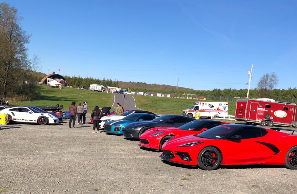

We got GT2 RS, the new Corvette, R8, GT3, GT3 RS and bunch of exotics. This is going to be a fun day.
Thats a gorgeous lineup!
