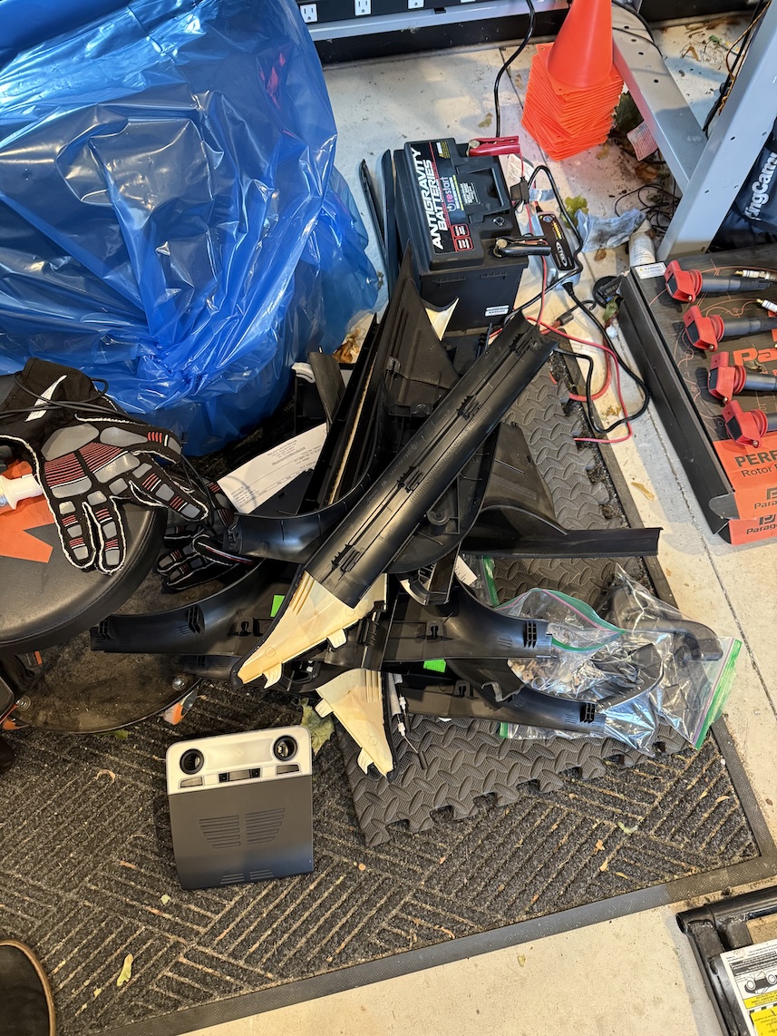

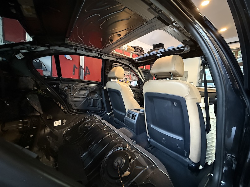

Making some progress since taking it down for the season. Most of the interior is out, and the HGK roof came in. Having a mobile glass guy come by tomorrow to take out the front and rear. Going to try to reinstall the front when I'm done, but go plexiglass for the rear.
Attachment 3597347
Attachment 3597348
Attachment 3597349
Attachment 3597350
Are you installing the roof cross support, the one that comes with slick tops? How are you anchoring it in place? When I was penciling this project it looks like the piece is surprisingly available, I figured it was something I would have to source from a junk yard or eBay used.
I was thinking about welding versus jb weld versus bolts. I’m sure welding is preferred but not a skill for me…..yet.
Mad respect taking this on yourself!

I’m starting to think the availability is a mirage, first place I tried to order it from listed 1-3 day availability and then cancelled as nla next day. Will try a few others, but also not super worried since I’ll be putting a cage in and DRLane makes the point that the main hoop serves the same purpose. I think rivnuts are the way to go there, unless you have a spot welder.

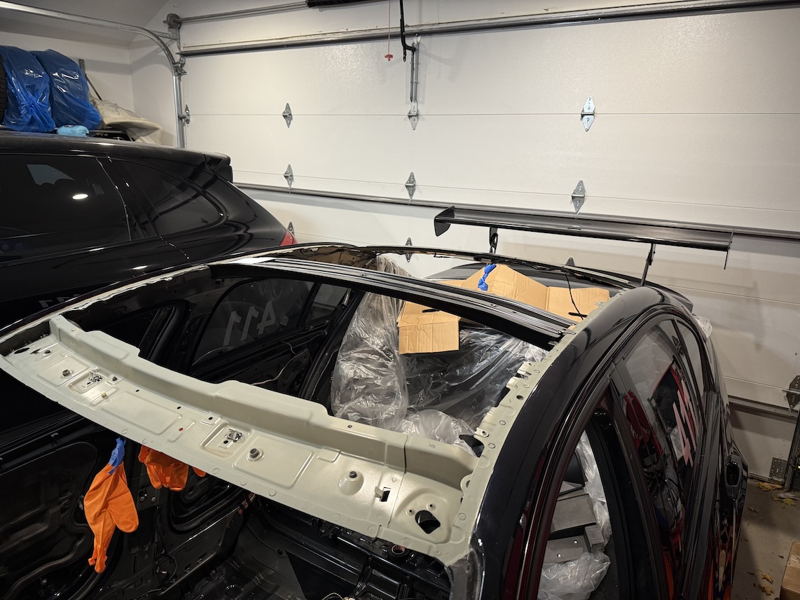

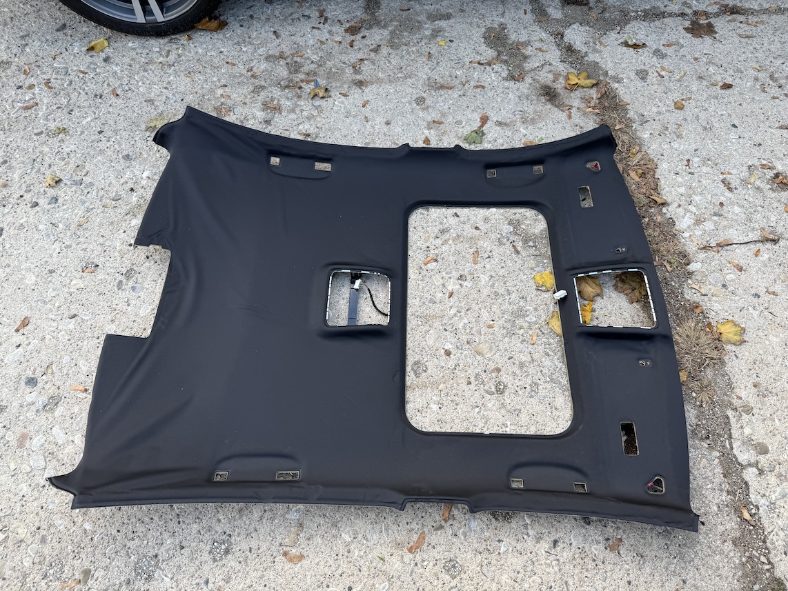

more gunk working its way out. have the sides of the roof drilled out too, and ground down the front and rear edges to expose the spot welds. hoping to drill those off this eve and maybe pop the roof off.
i will say, i don't know how people pull that sun roof out with the seats still in place (or the windshield for that matter, that's the route i ended up taking)

it's out! spent almost as much time fighting with the secret adhesive as i did the actual spot welds, but it's out.
now i've gotta decide how and if to fill in the handful of spot welds where i went too far through. looks like most that went through are harmless, but there's one or two where it's a triple stack and there's something underneath that's also welded on.

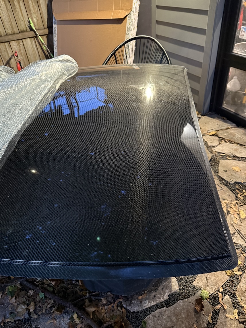

spent the last couple of weeks waiting for the roof bow to show up (actually two, the one i found as available first still hasn't arrived, but then a rando ebay seller got one to me in under a week).

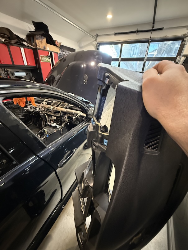

but now that it's here (and after talking with DRLane ), i'm having second thoughts about it. i think i'm going to with his suggestion and drill the 4 holes for the roof and secure it that way for the time being (no glue yet), then ship it off to the cage builder that way so he can do his measurements and take the roof off. he can also then decide if he wants to install the roof bow (and ostensibly he could just spot weld it in then instead of me messing around with rivnuts), or have the main hoop perform the same function.
i used the wait time to press on stripping the interior. the dash came out today!
i'm going to ship the car off without a dash, and then stick a single hump one in when it comes back. wouldn't have messed with it but the cage guy wanted it out so i might as well use this opportunity to do the conversion and also yank the heater core.
