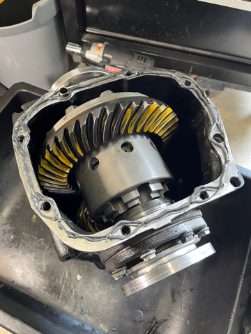

Pattern looks central and uniform enough for my satisfaction. I think this matters a lot more when you swap a ring/pinion out.
Checking both sides also.

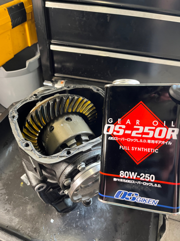

Not the best gasket bead but getting smashed anyway.
Installing plugs and then fluid in and the top goes on!

Using Giken diff fluid for break-in, see link in my first post for the reason why. Fluid in, diff sealed up, and installed! Less pictures here but the motorcycle/transmission lift was key, also used it to reinstall my x-pipe. Of note, the third differential bolt does need to go in a certain direction or at least I maintained the direction from the factory, see parts photo below.
