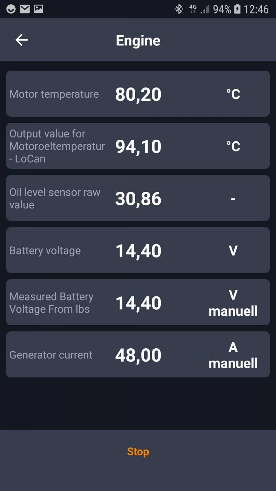

Last time i checked my coolant temp through Carly it read this. Same speed/rpm and no traffic (this was before I adjusted my Speedo digital reading)

Believe you've picked the wrong parameter mate. Bit odd but the coolant temp is "engine temp", while the engine (oil) temp is "output value for motoroeltemp". See attached. The "coolant temp" parameter clearly doesn't work the way one would expect, while the "engine temp" def show coolant.
Edit: lol, just realized you obviously measure in F, the high numver got me confused. Yeah, like Mike day further down, coolant need and should be around 80C as long as youre driving/have proper airflow.

Coolant temp sensor is likely fine. 205F coolant temp is exactly why you are seeing the oil temps you are - as I previously suspected.
The M3 has a 79C thermostat = 174F. You're pushing 97C.
If you want to bring your oil temps down, you need to solve cooling system or airflow issues, and also ensure that the electronic fans are operating as designed.
Once your coolant temp is 79-85C, you'll see the needle nearly center.
