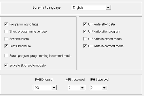

Originally Posted by SaNGRia View Post
Make sure your cable set correctly. Check the Latency Time make sure it is set to "1" then make sure winkfp set like this :
Attachment 2536564
If you still get error, and if you didnt damage the module yet i can help remotely. DM me!
I can't recommend to connect with SaNGRia enough!! I am new to using BMW tools and got an Error 211 when I attempted to flash the DME and it rendered my car useless. It would not start since the fuel pump would not even prime and a ton of warning lights flashing on the dash. I connected with SaNGRia remotely and after a lot of troubleshooting since the Error kept popping up during the flash he determined I was sent a defective Bimmergeeks cable! After getting a replacement cable and a successful flash the car is alive again and running much better. Don't hesitate on contacting him for help. He is a true expert and professional and will not quit until he solves your issue.
SaNGRia1435.00
