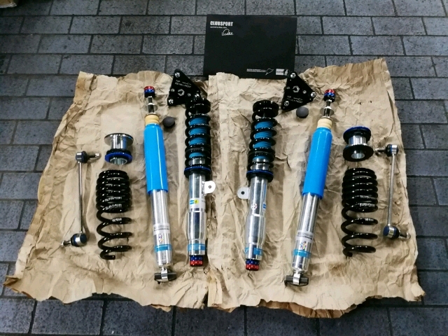

Got them installed today. Left all the Rebound and Compression at 3 to run them in. The ride has firmed up, kind of like leaving the EDC at Sport. The car is firm but not crashy or jumpy. There's more feedback of the road coming though the steering wheel.
This is my first set of new coilovers ever, so all these sensation is new to me.
