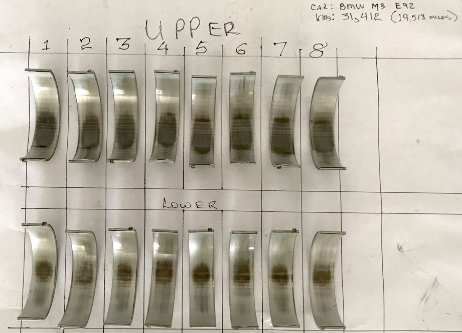

They show a wave wear pattern . This means that the S65 was running out of balance (and very likely also the crank) suffered from serious internal vibrations.
I agree they look better . But the cause of the wave wear pattern is no good .
I don't know what you're talking about with a wave pattern... None of the bearings I see show any signs of failure due to excessive vibrations.

Ok, I'm confused
Helmsman, what do you mean by "high level" shells?
///M-Power Belgium, "wave pattern"?
deansbimmer, what do you think about the wear shown by InTgr8r, aswy6, wickz80 or myself? Is it significant or not?
I don't see it either. Poster tends to always be on the attack about bearings it seems.
Many of these recent bearing swaps show OEM bearings still doing fine which doesn't surprise me. Some of these late model pulls above still look fine. Let's hope that long term the BE bearings work well and the mains enjoy more flow through them.
In Rich's case, I'm thinking here's a car with its original owner who has always warmed it up carefully, etc, and that's how a 2008 arrives at over 100k miles with still very serviceable bearings.

Brain slip, meant high mileage.
OK . It's really strange you don't see it .
Last year I talked with a race engine builder . And I showed him this thread and the blown S65 engine thread . So he saw the S65 bearings and the different wear paterns on the S65 bearings .
I said to him that I noticed sometimes , some strange horizontal lines over the inside width of the bearing shells and always in the middle of the shells !
He said to me....You are correct . I see the *wave wear patern* sometimes on the bearings from supercharged engines . The wave wear patern is caused by internal vibrations and by overload of torque on Turbo and supercharged engines .
And sometimes we can feel with our fingertip the irregularities (bumps) on the bearing surface.
When we rub with a fingertip over this bumps , they actually feel like a wave through the fingertip .
That's why we talk here about the *wave wear patern*
He said also..That the cylinder walls of the S65 and S85 engine are too thin . BMW was rushed by the research of engine weight saving. That's why they are easily susceptible for internal engine vibrations .
Check the horizontal lines in my red square in the picture below. But actually in all eight of the shells you can see this kind of premature wear .
Note : This S65 has only 19K miles on it !

OK . .......................
Interesting!
At first I wondered if it was just lighting playing tricks.
(I have several rows of exposed fluorescent tube lights in the shop)
I just checked the bearing shells and there are in fact waves as you describe.
nada

Interesting!
Yes. I know .
Thank you for the confirmation

Hogwash. If it were a realistic issue, it would be a major topic of concern between actual engineers who focus on the S65...And we'd see a LOT more broken crankshafts and other symptoms actually attributed to vibration. Per a discussion with a bearing vendor I had at SEMA, small visible striations in the babbit layer of the shell are the result of the manufacturing process and lacking mid-process QC which causes inconsistent thickness of the binding layer. They only show as the babbit is worn away and the high/low spots in the binding layer become visible- a non issue for babbit layers that wear normally (i.e. not at all).

Do you really know every single little random thing like that when it comes to S65 engine? I dont think people who make this engines know as much
Clearly they didn't or they wouldn't have designed in such piss poor bearing clearances...

Originally Posted by inTgr8r View Post
Guess I should add mine to the list.
Picked up the car late last year and did the bearings as a preemptive service.
I used BE bearings and bolts.
Very happy that I can now start trending the wear.
Attachment 1830778
Holy, those bearings look terrible for 19k miles. I am glad you got to them before they would have failed on you at the track! By the way, my friend sent me pics at Watkins Glen and I saw your car!
