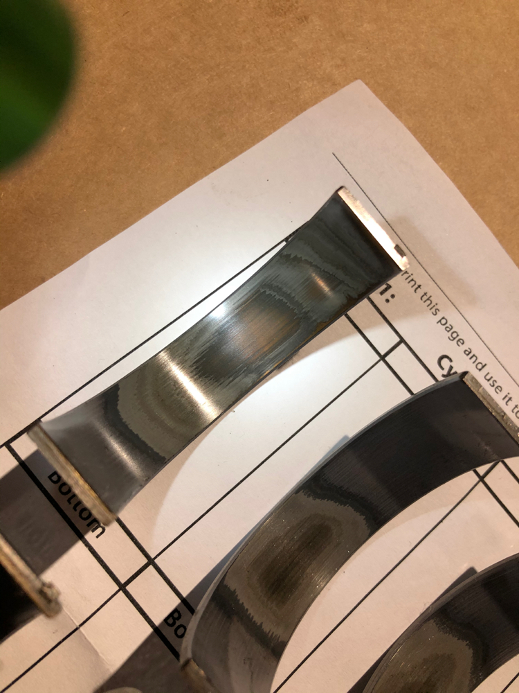

Just an update on my rod bearing services. I got a used M3 with 90k on it for a good deal. PO didn’t know if the rod bearings were don’t. I got a measured mixed ACL rod bearings from Mpower motorsport.
Got prepared and did the job on jackstands due to some delivery and timing issues. I pulled everything to find out I have BE bearings already in there with no real wear. So I button things up replaced the valve cover gaskets and finally done.
Some notes if you are going to do this on your back.
- 6 ton jack stand to get good height
- disconnect their steering lines to the steering rack and drop it with the subframe. It’s not that hard to do and just get new washers for lines.
- the more you let it drain/drip the better
-go slow it’s tedious work and you aching body will want short cuts
- special tools mentioned in the beginning are a must
All in all not a bad job. I now have a set of New ACLs and a few other items if folks you like a good deal on them I am happy to sell them off just pm me. Glad that I rest easy now!

Thank you for this thread. I did mine bearings during the weekend. It went very smooth. The upper bearings took more time to remove, but once i did couple of cylinders, i got used to it. For removing the fan, definitely recommend removing the airbox, it has so much more room. Lining up the steering column bolt wasnt bad at all, just have to line up with the tab and ur marks, approx the engine mount holes and all the subframe holes, slowly raise up the subframe and u are there. Not a hard job at all, just more time consuming than difficult.

Curious...why is it recommended to try to complete the job with one rotation of the crank/engine?
Danny, when I followed your E46, I used OEM bolts and I had messed up on 5 of them and had to get new ones. I learned that I should practice the 130 degree before using the new bolts. During this learning curve, I made about 3 full rotations of the engine. Like I mentioned in my other thread, this was back Nov 2017 and I've put 22k since then with no issues.
