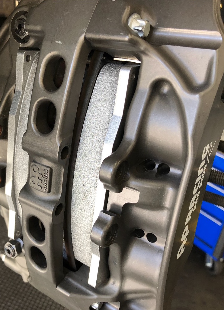

It's pretty amazing and makes a bold statement that you switched from one set of racing brakes to another, and felt such a big difference.
Same set of pads? How are they looking?
Yeah, I'm more impressed than I thought I would be. If you look back to my comments before I drove the Essex kit, I didn't anticipate much change. That's why I've tried to solidify what I'm sensing by showing data so that we can all see it (or not see it if there's nothing there.....)
Yes, I am still using the original 18mm pad that went into the calipers during the caliper install. I now have 4 days on the pads. I would say I'm still less than halfway down on the front pads.
I am going to predict that I will get around 8-9 days from the 18mm pads. I was getting 13-14 days from these same pads in the Stillen non-Radi-Cal calipers. But, as I have been clearly trying to demonstrate with my charts, I am pressing the brake pedal harder, using a J-Hook rotor that is more intense on the pads than before, and getting more G's from the same pads. Nothing comes free, and the price here is more pad wear. But it's not unusual or bad.
And, my kit is the 25mm kit, so for just a few bucks more, I can run the thicker pad that will last quite a bit longer. So, I'm quite satisfied that the wear rate is reasonable. I would love to slam the 25mm pads in there and just get going, but I'm keeping the 18mm pads in there as a test. If they start to get low and I want to drive fast, I may pull them out early. I've already proven to myself what I need to prove----that the 18mm can last a decent amount of time, and that the 25mm will be great.

hehe 28mm pad on the PFC....super beefy!! I just installed the 25mm pads into the front calipers of my Essex AP kit today. I hope that they last a decent amount of time.
Check this ridiculousness out: It looks like I stuck a thick-cut piece of banana bread in my caliper!!!!
