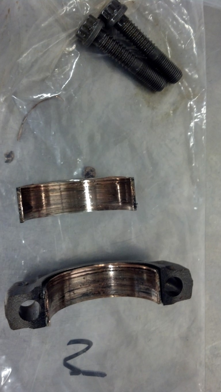

Figured I'd add this one - just found the pictures on a memory stick I misplaced..
2011 - 29K miles, stock car. Engine was replaced under warranty.
Engine oil at minimum level came on while tracking.
After leaving the track it gave out on the freeway.
Spun two bearings, Cylinders 1 and 2.
