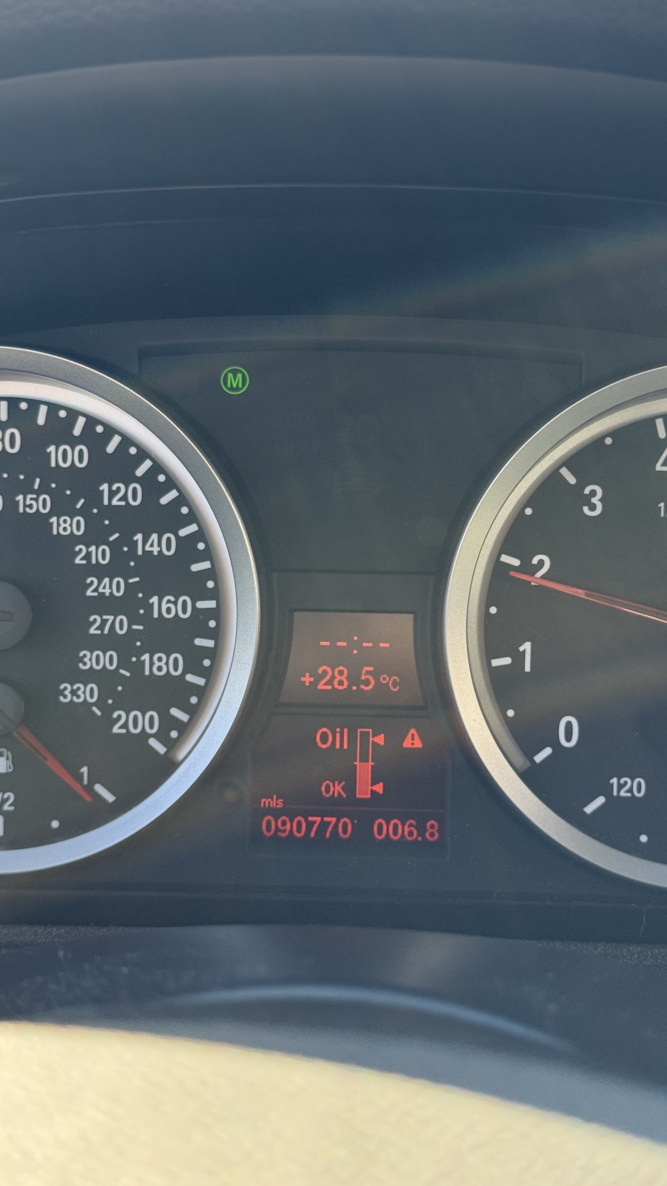

Lol ok. So alternator is great, reads between 13.6 and 14.1v. oil sensor is still doing the same thing, going to do a few mor drives today to see if it ever calibrates.

No change. Problem still exists. Even added a 500ml of oil, pretty sure it's overfilled now. Still getting low oil reading.
Going under tomorrow to check wiring harness again. Ordered yet another sensor. No codes at all, ac compressor may be on the way out. Car sometimes stalls sitting still with ac and sometimes the ac doesn't blast at all. Going back to driving the g82 for now.

Guys, it's working. Spent all day trouble shooting. All wiring were good, no short anywhere...however after probing the ground I got a code and cel. Sensor fault. Went back down, disconnected and saw that the terminals are way to wide when compared to a new terminal. Bent them back. Drove for 20min, got a reading. Lost my mind. Restarted car, got another reading, forced reset and after ten minutes got another reading. What a journey it's been. Was thinking of replacing the sensor plug and terminals but honestly might just never touch it again.
In the process of all this, found out my ac compressor is toast. 🤦🏼*♂️ It doesn't end.

Thanks for posting a follow up. It's good information for others to know i.e. loose or worn sensor connector plug terminals can cause a repetative "no read" oil level situation. Well done finding and fixing it. I'm glad at least this part has worked out for you. Along the way you discovered a low voltage output from the alternator and now an A/C compressor that's on the way out. Yikes... BMW is an abbreviation for Broke My Wallet.
