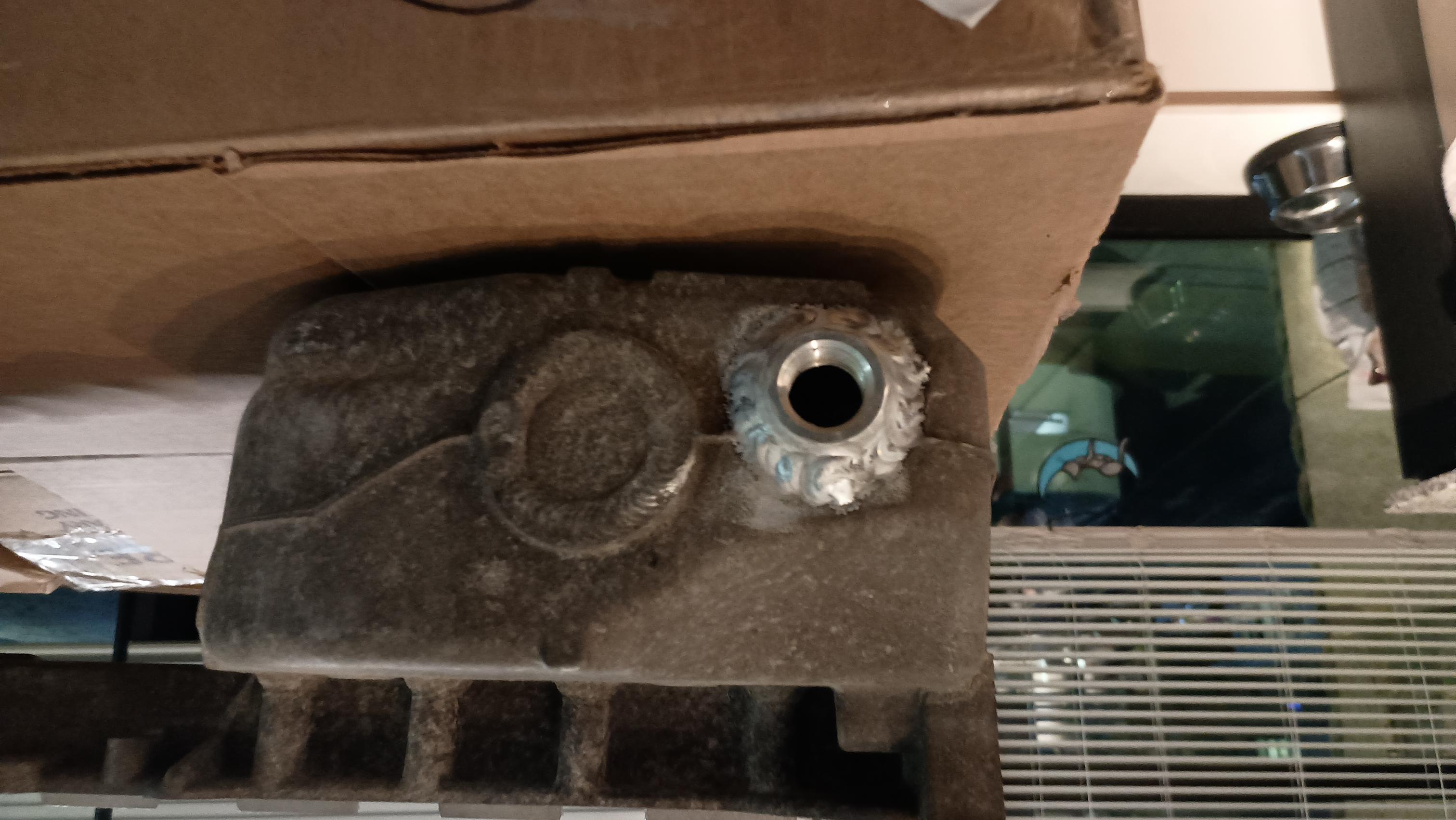

New (to me) oil pan is back from AAF. They did a great job, pics stink but it was near impossible to get inside the sump. They did the BW Dipstick Kit while there were there too.

New (to me) oil pan is back from AAF. They did a great job, pics stink but it was near impossible to get inside the sump. They did the BW Dipstick Kit while there were there too. Rubin
It looks great. I hope it works well for you. Slowly and surely wins the race... PS: You posted with a 9:11 time stamp. I hope it's not an omen...

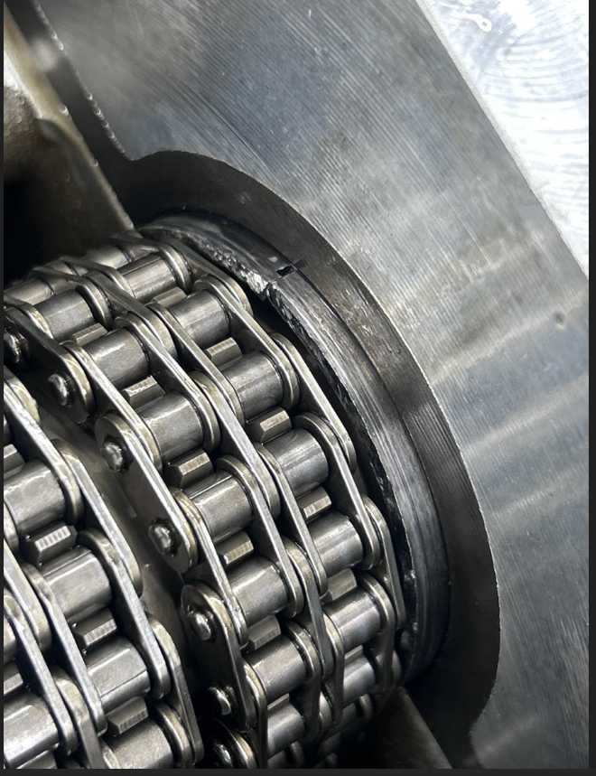

Well today was a buzzkill. Engine showed up at Rogue headquarters yesterday and today they took the bedplate off to see the mains. We found the full culprit of the failure, Main Cap 1 bearing failure. It only partially spun then blocked the oil feed to the crank causing the over heating issues to cylinders `1 & 5. The main journal cracked so the block is toast. Anyone want a paperweight?
Note these main bearings had 14k miles on them. Disappointing.
Found a new block that is just minutes from Rogue, so Ben can go put eyes on the unit before paying for it to ensure it's good.
Onwards and upwards.......... let's hope this is the last surprise I get on this rebuild.

Oof - this is just brutal to see. But, at least there's a pretty clear explanation for what happened on track. And from this result, it seems to clear the stock oiling system as the culprit, which is good news.
Such a bummer this happened, but thanks again for sharing your experience, and it's wonderful to see you rebuilding even stronger. Nice work.

Great news on the new block and it looks like the baffling was welded in very well.
The million dollar question would be, what caused the new oem main bearings to fail after only 14k miles since the rebuild?
I am not convinced the failure would be due to oil starvation. I think it's much more likely the rebuild was done poorly, there is a specific procedure to select the correct main bearings to use when doing the rebuild.
I know you said the PO did the rebuild, but it would be good to know what shop did it, and perhaps even reach out to do them to ask if they selected the correct main bearings based on BMW documentation, or did they just throw random main bearings in there.
IMO, after the first main bearing failure, it is still possible that the oil cooler, lines (or any other parts from the failed engine, vanos, oil pump, etc) were re-used and not cleaned / rebuilt properly which contain debris from the previous failure.
I agree with your assessment but would argue the failure was a multitude of factors including.........
1. Poor rebuild from previous shop - many inconsistencies were found during disassembly that could cause premature failure
2. Oil starvation - Road America is very difficult on engines. The carousel causes very high loads on the oil pan and mine was not baffled.
3. Oil temperature - although it wasn't hot for our engines I think the oil temps didn't help.
I am attacking each of the above issues and doing everything I can to ensure it doesn't happen again. The old shop (which I am still not comfortable naming) will never see this engine or chassis again. They had a good reputation in the Kansas City area but holes in that reputation are beginning to show, in my opinion.
