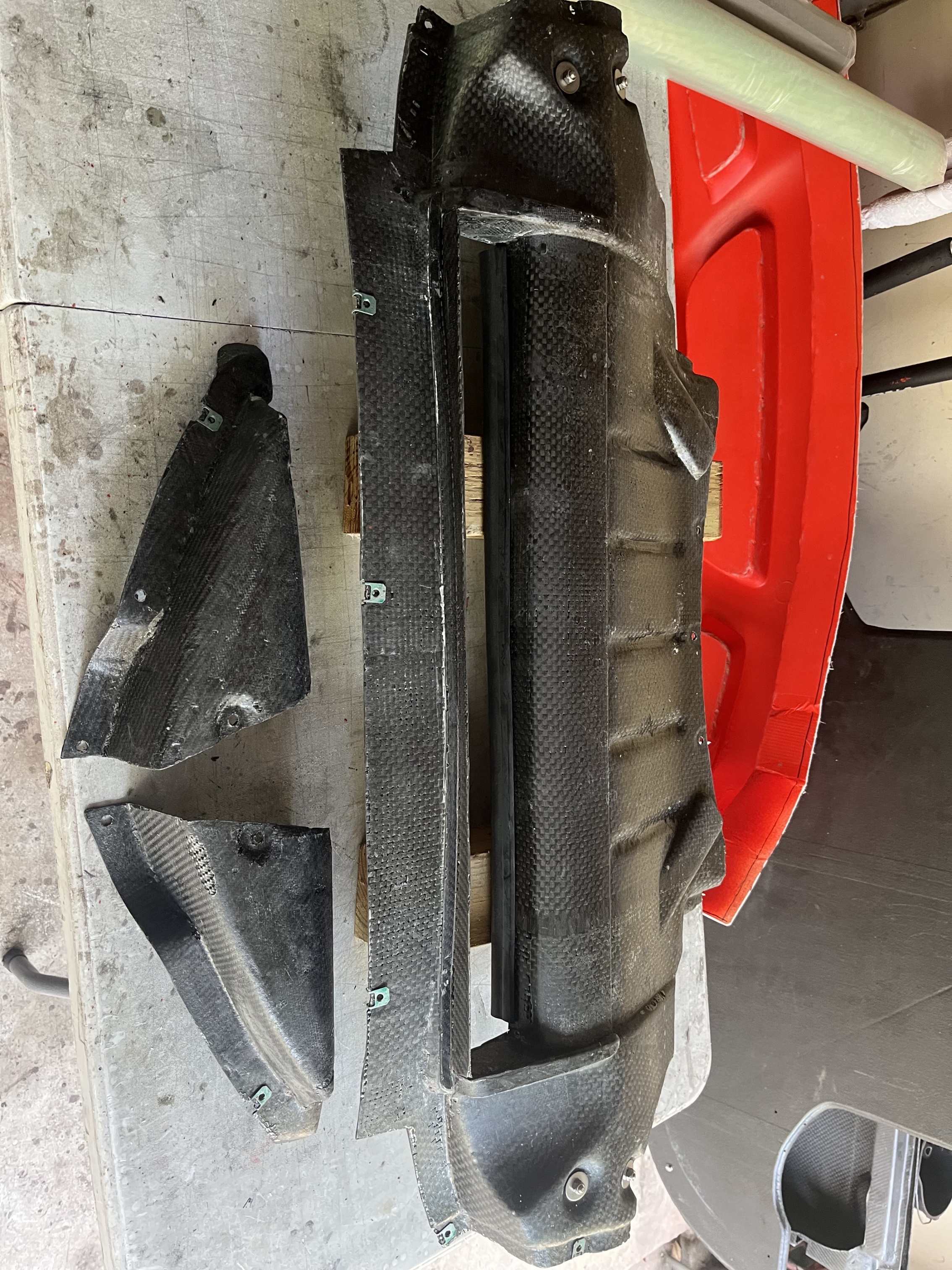

Those flat panel under trays will get a lot less extraction from the oil cooler.
The OE part sits closer to the ground which creates a lower pressure zone.
There is also a large gurney on the front edge of the oil cooler exit ducting. I made a carbon undertray where the gurney flap is bonded on. Just street driving there is a 5 degree improvement by adding the gurney flap.
Any pics of this gurney flap pls?
Hard to see but it looks the same as the OE part which has a gurney integrated.

I see what you mean. I have an Mporium metal undertray. I shall see if I can stick a piece of rubber trim in the front of the opening to create a low pressure zone to evacuate hot air faster out from the oil cooler outlet. Thanks!
