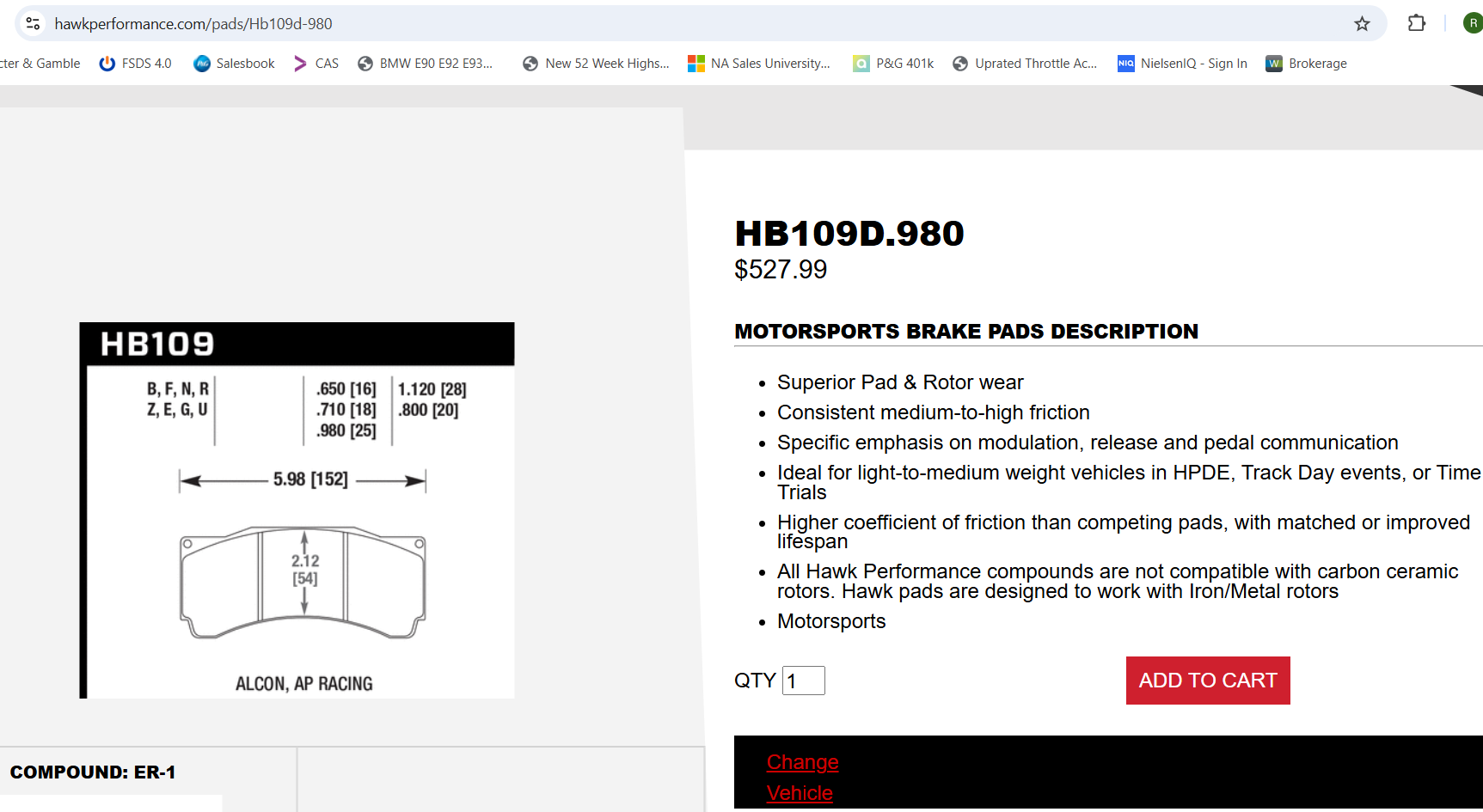

100% agree with your assessment on the DTC-70. The aren't initial bite heavy versus the Ferrodo 3.12 and it's a progressive pad in my eyes.
In regards to DTC-60 I think I found them for you....Hawk doesn't make it easy.
https://www.hawkperformance.com/pads/Hb109d-980
I looked up your front kit and looked for the pad shape. Hawk sets up their part numbers pretty logically......
Hb109d-980 109 shape/profile, letter is the compound and the last 3 digits are the thickness. If this doesn't work if you contact them and give them the image of your pad shape and dimensions they can usually hunt it down.
Hope this helps, Rubin.
