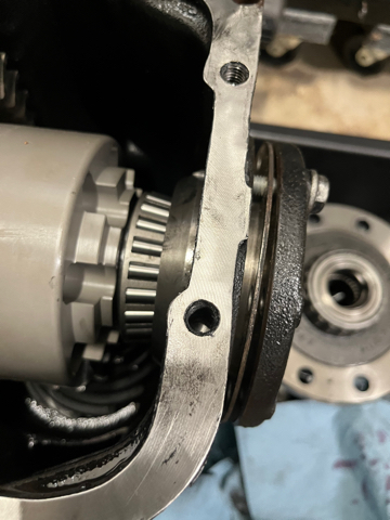

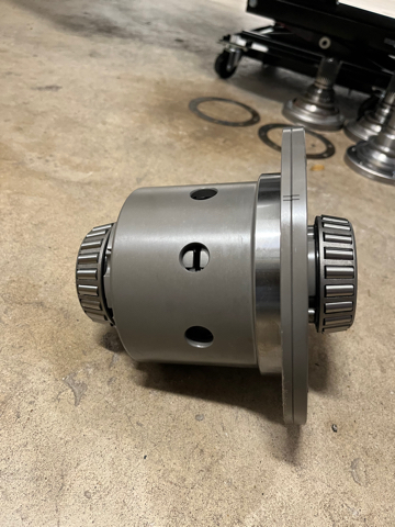

Practice tip, need a metal disc of correct size to fully seat the race. Second picture shows gap if just flat seated and not fully seated with the disc.

Getting lucky here as the shop happened to have the perfect metal disc sizes.

So same thing with the bearings, there was a slight gap beneath the bearing when pressing with the flat disc, need a circular piece of pipe that is just right for that middle ring of the bearing. One of the photos below shows the gap.

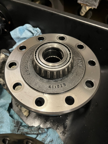

So I ended up buying the 250 ft lb Milwaukee M12 stubby and still couldn't loosen the bolts, thought a fresh tool would do it but nope. A buddy ended up coming over with his M18 high torque impact that does 1400 ft lbs, got most of the rest off easy but one bolt took a little work with that even, surprising. Got the ring off with a hammer and large screwdriver hitting the top of the screwdriver around the edges, tried a rubber mallet first but it wasn't enough.
Next questions, what should I torque the ring bolts too and should I red loctite them?

I just leave 4 bolts in and bang on the bolts to get the crown gear off. Probably wouldn't want to reuse them.
There's an angle torque spec. I can't get it done since I have no way to hold the carrier. I use a big M18 Milwaukee Impact and go with a couple of ugga-dugga's. No loctite.

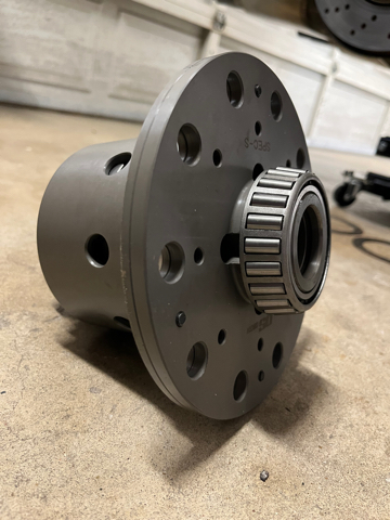

dogbone and Redd, appreciate the feedback from you both! I've chatted with a number of folks that have Spec-S units on multiple different platforms and they've all really enjoyed the cars behavior both on/off track (varying skill levels). I also spoke with the seller I purchased from, Jonathan at Shaftworks USA (who also used to work at OS Giken), and his indication was that for a street/track car on mostly 200tw tires and r-comps the Spec-S should work well. What he or Giken would change (and what would make the diff Spec-X) is to make the diff lock up quicker and be optimized for stickier tires like Hoosiers and/or slicks. They can also optimize the diff for increased power levels (such as supercharged cars). FWIW, I realize Giken has multiple behaviors they can revise (see the MotoIQ video in the first post for examples), so this is likely an over simplification. His indication was that if I ran a more aggressive Spec-X set up on the street I may hear some clunking noises and the diff would also be less optimized for that use. All that said, for a pure track car I'd absolutely go Spec-X (and I may still go that route long term) but for me, my car still sees the street for now and I also just wanted to try Spec-S to have that data point. I also may or may not add a supercharger, may or may not add bigger aero, so want to wait for those decisions before I customize. Granted it's a good amount of work to swap the diff so straight to Spec-X may be logical here if you know where your car is headed (I hear you Gabe!), just want to try Spec-S first and also keep changing my mind on where my car is headed so there's that also. Good advice all around and good to think through this at purchase.
Of note, these are the parameters for an e9x m3 Spec-S diff:
Ramps - 25/35
Lock Timing - 336
Total Plates - 20
Preload - 10S

Checkout the bolt ridge impressions on the original diff, telling about how much torque was used! I haven't been able to locate our exact torque specs for the ring bolts but also i don't think I'd be able to implement without a proper vice setup. That said I am going to red loctite as a safety precaution, did some research on the various red loctite options and ended up getting loctite 263. I believe the temp spec on it is ~360F (though the packaging says 300) and my research tells me diff fluid on track maxes out around 260-280. Also though, these bolts are constantly exposed to diff fluid and temp cycling so I do wonder if the loctite can even withstand that, figure why not though. Loctite 263 does also indicate some oil resistant properties. One other note, if you red loctite (and it's actually effective) and you go to swap the ring/pinion later it's likely you'd have to apply some heat to each bolt to get it loose. Maybe I should have done this for the factory bolts as well, easy enough with a butane torch, assuming the leftover oil doesn't ignite*!

Ring gear on. 10 minute set, 24-hour cure, may install in diff housing but then wait to add diff fluid until tomorrow.

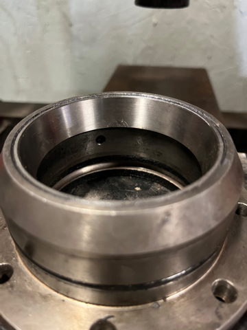

About to swap the o-rings and install new flange seals in the side bearing carriers. One thing to note here, the side carrier parts each have oiling ports, from some of the install videos I've watched there is a certain orientation these ports should face when installed to ensure they receive oil, will see if I can point to that in a subsequent post.

This video explains the intended orientation of the oiling ports at around the 1:58 mark. Thanks to Theodore for linking to this video in his DIY thread on how to fix your leaking diff - LINK
