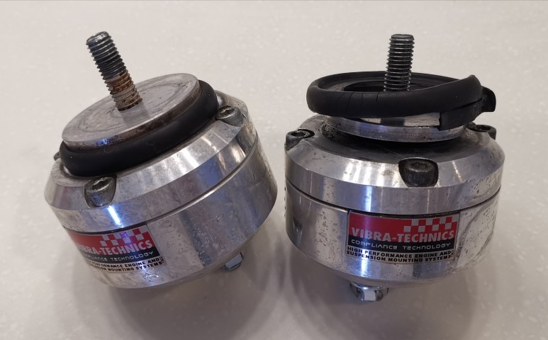

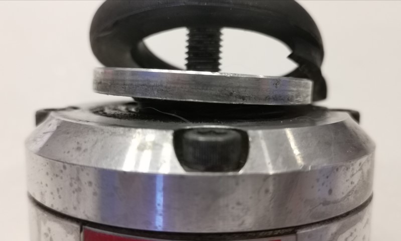

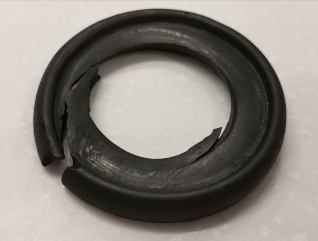

Got the old VT mounts off the car and they're not pretty. Left side mount is fine but the right side mount is completely toast.
Left mount. Rubber is a bit dry but otherwise ok:
Right mount. you can see that the top plate is at a weird angle and the rubber is completely ripped off:
I tried to open the top of the right mount but the allen bolts would not budge so I decided not to waste any more time with it. These mounts are going in the bin where they belong.

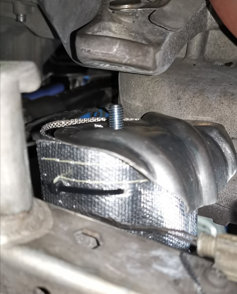

I'll be installing PowerFlex mounts with E46 engine mount heat shields and a DIY heat protection jacket. Hope they help the new mounts last longer.
Instructions on building the heat protection jacket here:
https://www.m3post.com/forums/showthread.php?p=27394293

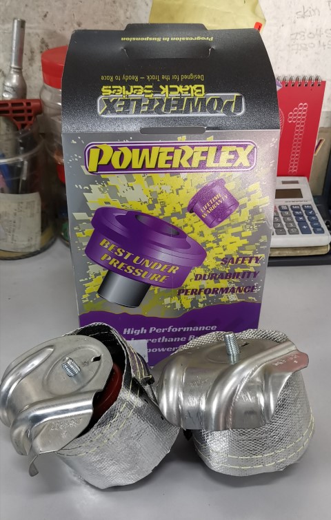

Quick update on the Powerflex engine mounts. These are called hybrid mounts because they actually utilize all the different grades of PU in the Powerflex catalogue. The main bush uses Red 65APU; the base has Purple 80A PU; the stiffening pins are Black 95A PU; and the retention band is Yellow 70A PU.
In the package:
Taken apart:
I ran these mounts without the stiffening pins as my car is a daily driver. Feel wise they are a lot like the VT mounts - there's slightly more vibration than stock at idle. Once there is a bit of rpm applied you don't feel them anymore. With the 4 stiffening pins installed, they are claimed to be 300% stiffer than new rubber mounts.
Hopefully these will last longer than the VT mounts.
