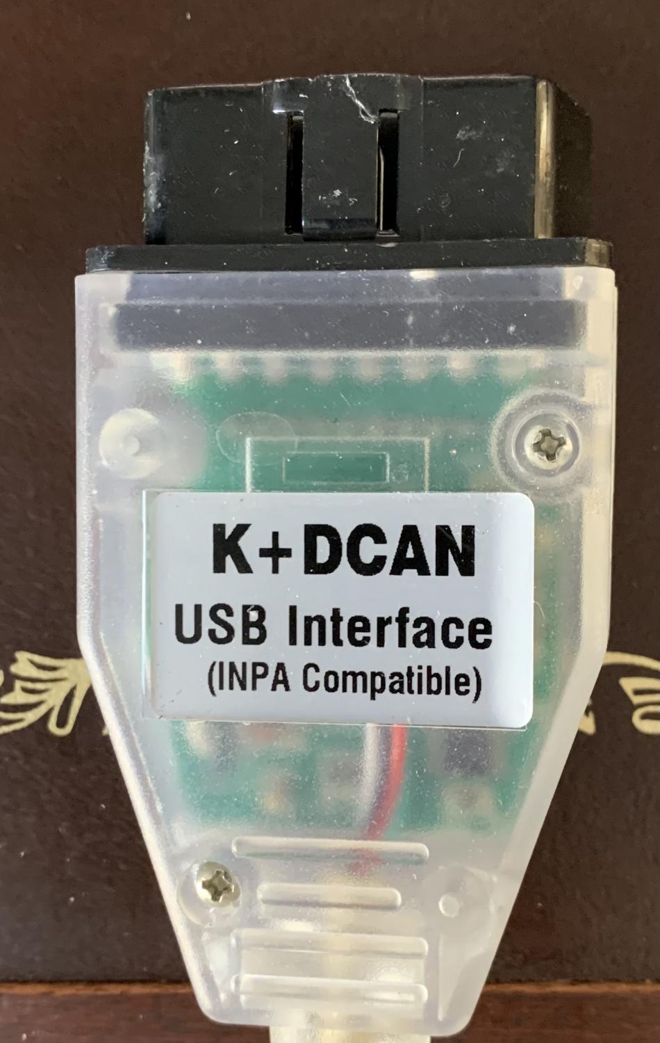

I have a ton of K+ cables lying around but bought the Bimmergeeks one anyway, it's way too risky when a ECU is involved!
Shame you weren't able to use MSSFlasher. That incredible, dare I say heroic push by people like Terraphantm is a before and after in the S65 world. Its true effects will not be fully understood for a while, but they are starting to trickle into the light.
The days of people buying """tunes""" that disable knock control, disable adaptations and other stupid things are going to come to an end and the S65 community will be better off.
I have an BMW INPA K+CAN cable laying around - would you recommend me purchasing the bimmergeek cable for safety purposes? I am not sure of the differences between the cable I have the bimmergeek Pro K+DCAN cable.
I would do it. It is not worth risking your ECU
Listen to Shadow, get the bimmergeeks cable. I have an perfectly good dcan cable that is capable of coding. Bimmergeeks seems to do everything twice as fast.
I built a power supply from a regulated cb radio power supply and 4 gauge copper jumper cables. Disconnect anything that can draw power prior to coding (after market amps, radar detector). I was surprised at the amp draw for this car.
I used a 75amp regulated power supply at 14.5-14.6V.

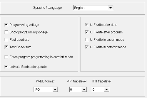

I was trying this and kept getting a UIF 209 error any thoughts on how to fix this?
Was running in comfort mode. Using pro cable from bimmergeeks too.
Details of error:
"Error in Ediabas or in ecu description file (SGBD) IFH-003 Datatransmission to interface disturbed 10FLASH"
"Error in Ediabas or in ecu description file (SGBD) SG_AIF_LESEN"

Make sure your cable set correctly. Check the Latency Time make sure it is set to "1" then make sure winkfp set like this :
If you still get error, and if you didnt damage the module yet i can help remotely. DM me!

Thanks Sangria! I had figured it out it was the latency timer on the com port. Car definitely feels better!

      02-25-2021, 03:22 PM   #66
CTMike
CTMike's Avatar
428
431
Drives: 2021 X5 40i MSport/2011 E93 M3
Join Date: Jul 2016
Location: CT
I can’t quite recall where I got this cable but does it look about right?
