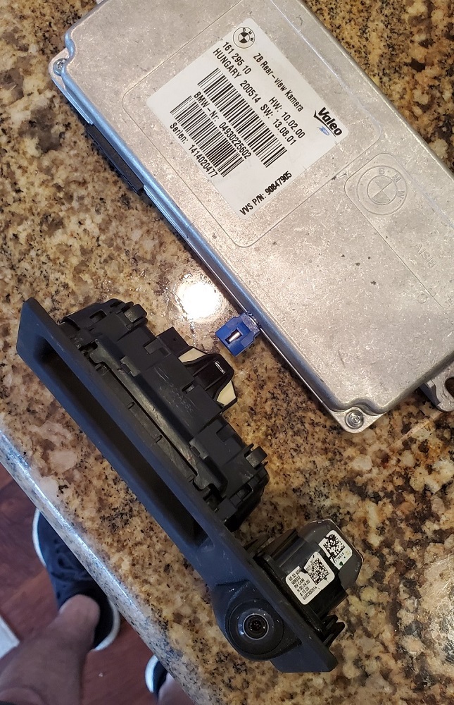

Based on the pictures I believe the e92 has more room in the trunk for the cable connector.
The parking aid lines came after the calibration with inpa and a short drive.
I used:
e70 TRSVC
cable harness from the ebay seller
chinese ebay backup camera for e90
f25 oem backup camera (modified to fit on the chinese camera handle)
x1 pdc
JBE "M" version
Where did u install trsvc module?

Originally Posted by unrulyteach View Post
Ok install jbe m today and I'm still having the same issue, Pdc is not communicating with car with i borrow power and can h/l from it to power tr module. Is it a possibility that Pdc can't supply power or can h/l for tr module?
Maybe the fuse is blown for PDC? While you grab power for TRSVC.
Before I installed all correctly, for testing I grab power from Combox and can from PDC.
When you disconnect the TRSVC, the PDC is working?
Yes when i unplugged trsvc and return oem wires to pdc. Pdc works as it should. I just ordered oem wiring harness to see if that fixes the issue if it doesn't then I'll be stuck. This last time when. I connected the wires and scanned with ista p it showed up yellow and not red so i made progress. The code i got was a k can. Oh btw the doesn't recognize trsvc at all it doesn't show up in ista or inpaw
hey there, I installed the trsv below the combox/media bracket with a nut and secure it with a zip tie.
I don't have more pictures of the oem camera and the chinese handle, but I had to dremel a lot of the inside where the chinese camera was to make room for the bulky oem camera.
The end result looked very similar to Sangria's camera fitment.
SaNGRia1435.00
