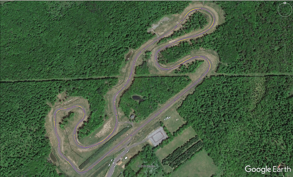

      04-04-2020, 08:42 AM   #65
rhyary
1637
2,883
Drives: 2013 M3
Join Date: May 2015
Location: Albany, NY
What a sad thread. The plan was by now to have one trackday data and getting ready for a second trackday April 20th. Instead, nothing.
Substituting real data, I made my own race track and collecting data from this. Not perfect, but something to do.
This is AiM overlaid on Google map
      04-04-2020, 09:01 AM   #66
rhyary
1637
2,883
Drives: 2013 M3
Join Date: May 2015
Google map of my best lap and the one that follow.
best is 1:35.7
next lap 1:36.7 (so one second a part)
