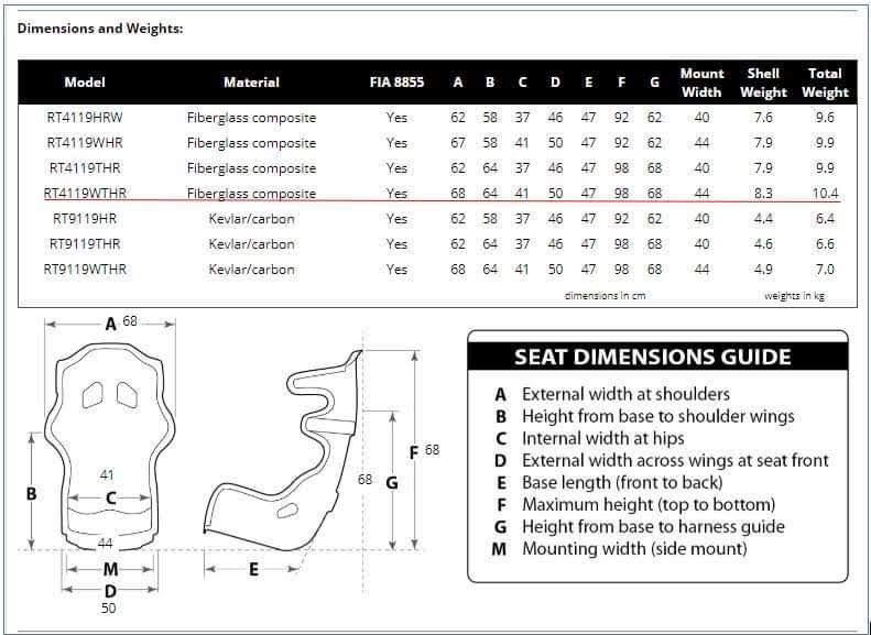

Tall fat guy checking in.
I'm 6'2, 315lb. 48 inch pant waist. Fitting into most seats can be a challenge. I use a RaceTech WRT4119W. Most comfortable seat I tried. Can drive 3+ hours in it to a track and not get any back or tailbone pain (which is rare for me in ANY seat). Love this seat.
Downside, it's $2k.
Downside, it's $2k.
got a link? the only internet searches of that part# bring me back to this thread.
https://racetech-usa.com/shop/seats/...WT-racing-seat
This is the exact one I bought, they also offer a version with the head restraints, but as a big guy I couldn't easily get in/out as quickly as I would like (for safety reasons) with the head restraint version.

The racetech RT4119 WT (Wide & tall) seems the most accommodating, albeit they're 3 x times the price of the sparco's and quite a bit more serious looking with halo etc for my predominantly street car...
