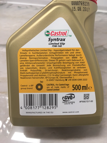

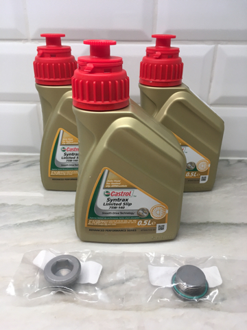

Thought I would share a few pieces of information regarding the OE GKN Visco Lok differentials that came in our cars.
GKN Visco Lok Tech Sheet, LINK.
Apparently 2008-2010 Dodge Vipers also used a GKN Visco Lok differential and this link has some interesting information regarding the recommended fluid for the Viper version, LINK. You guessed it, Castrol Syntrax Limited Slip 75W-140, pre-configured with the right amount of fm additive for a GKN Visco Lok diff!
I emailed GKN Driveline to see if they would recommend this same fluid for our cars but haven't heard anything back yet.
Since I plan to visit COTA a few more times before I trade out my diff, I may as well try the Castrol Syntrax fluid out first (my car currently has the BMW SAF-XJ fluid with FM Booster). Will report back.
And thanks driftflo for recommending this stuff in the first place.

Purchased from ECS Tuning and apparently this stock came from a Mercedes dealership in Germany. Going in next week.

Dis you notice any change after running this fluid vs OEM's fm variant?
