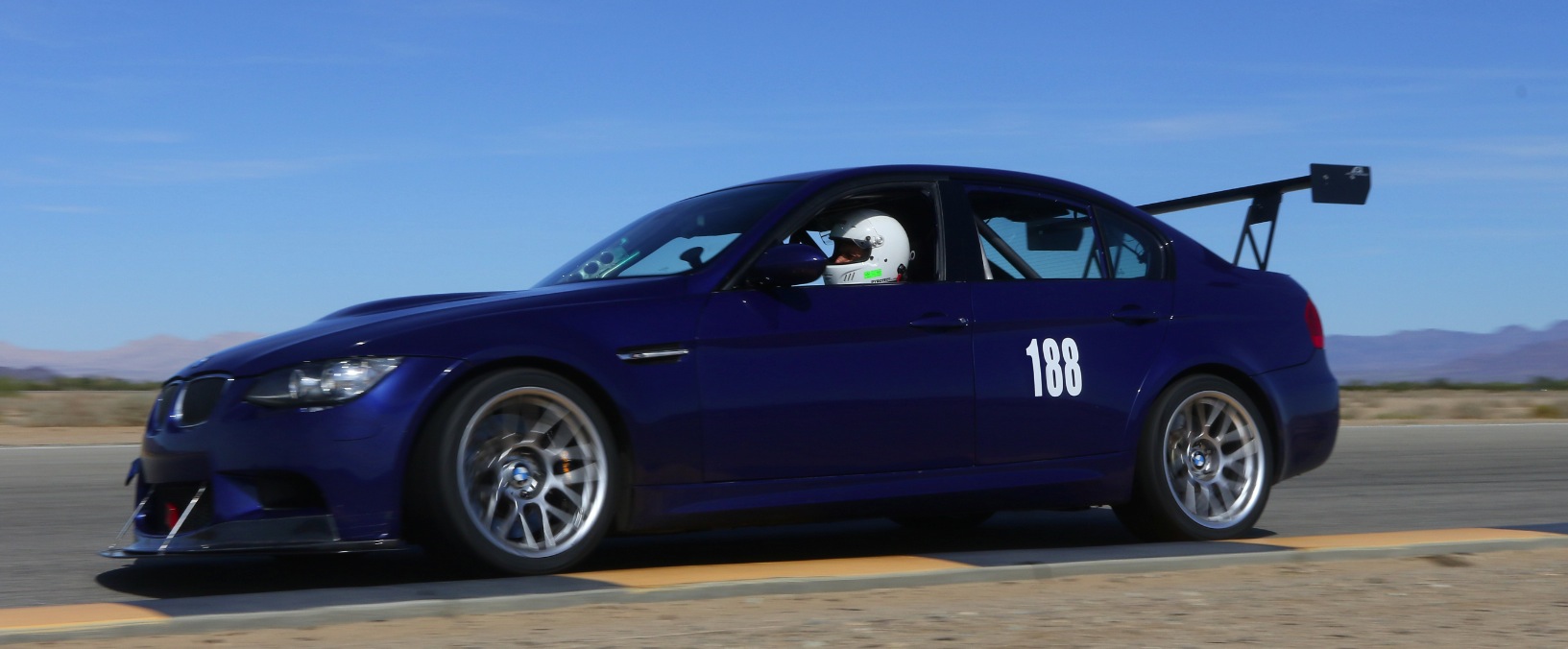

Ok, time for a little update since there's a couple new things in the car.
I went to the PCA San Diego's Chuckwalla 2-day event this weekend. I used this event to test some new stuff on the car.
1. Front lip and splitter. Yay! Finally! I love the aero on the front! It balances out the car. I was focused on trying different settings of wing angle and suspension settings every time I went out. I think I found a balance that works for me. Car feels really good. (Someone has already looked at it and said I need canards…..c'mon gimmes a break here! ok ok i'll do it…. ) One of the pix below shows how close the splitter gets to the ground in the Bowl at Chuckwalla.
Speaking of feeling good----PCA-SD requires racing suits if your car is modded enough. This weekend was 85-90º. I've only been wearing my fire suit sporadically since the cage went in this summer---mainly because I don't really enjoy wearing heavy flannel pajamas in the middle of a hot day……so----->
2. Ultra Chiller water cooling shirt system - I decided to buy the Ultra Chiller brand over Cool Shirt. One of the main reasons is that they have a canister that can securely fastened to my cage, versus an ice chest that's webbing-strapped into a holding tray. (check out the pix) Man, I really enjoyed wearing that cooling shirt. It works GREAT! No heat issues whatsoever when the system was on. I rather enjoyed hanging out in my racing suit. By comparison, I did end up having to sit in the car for 15 minutes with the engine off, so the cooling system was not running. I was miserable. The difference of when it is on and off is stark to say the least. And since I have a sedan, where we positioned the canister makes it the easiest thing in the world to add ice, remove water, etc. I don't even need to open the door. I just reach in the window and I'm good to go. Anyway, I am quite happy that I decided to give the cooling shirt a try. It does add one more thing to deal with though----keeping enough ice around.
Chuckwalla was a good test for the splitter. My main complaint about the car was that it would start to significantly understeer beyond 80 mph in wide rounders like Riverside at Buttonwillow, or Turn 2 and 9 at Big Willow. Chuckwalla is all about rounders. I went with a time-attack-legal 5-inch-from-the-nose-of-the-vehicle splitter. I think this will be enough to balance the car out. I have continued to change suspension settings to see what the net result is. I had the opportunity to run both beat-up old TD tires and brand new TDs this weekend. With new tires, the understeer was virtually gone. With old tires, you still get a bit, but nothing like before.
And I'm happy to report that I've run my first new PB with the latest new setup, along with new tires. I dropped 3 full seconds from my previous best at Chuckwalla CW----from 1:58.8 to 1:55.8. And this was in 85 degree heat. Put up some cool weather and get me a few more days at Chuckwalla and there's plenty of room to improve.
Oh----and I have my first picture of my wheel in the air after jumping off a berm! I am so LEGIT now!

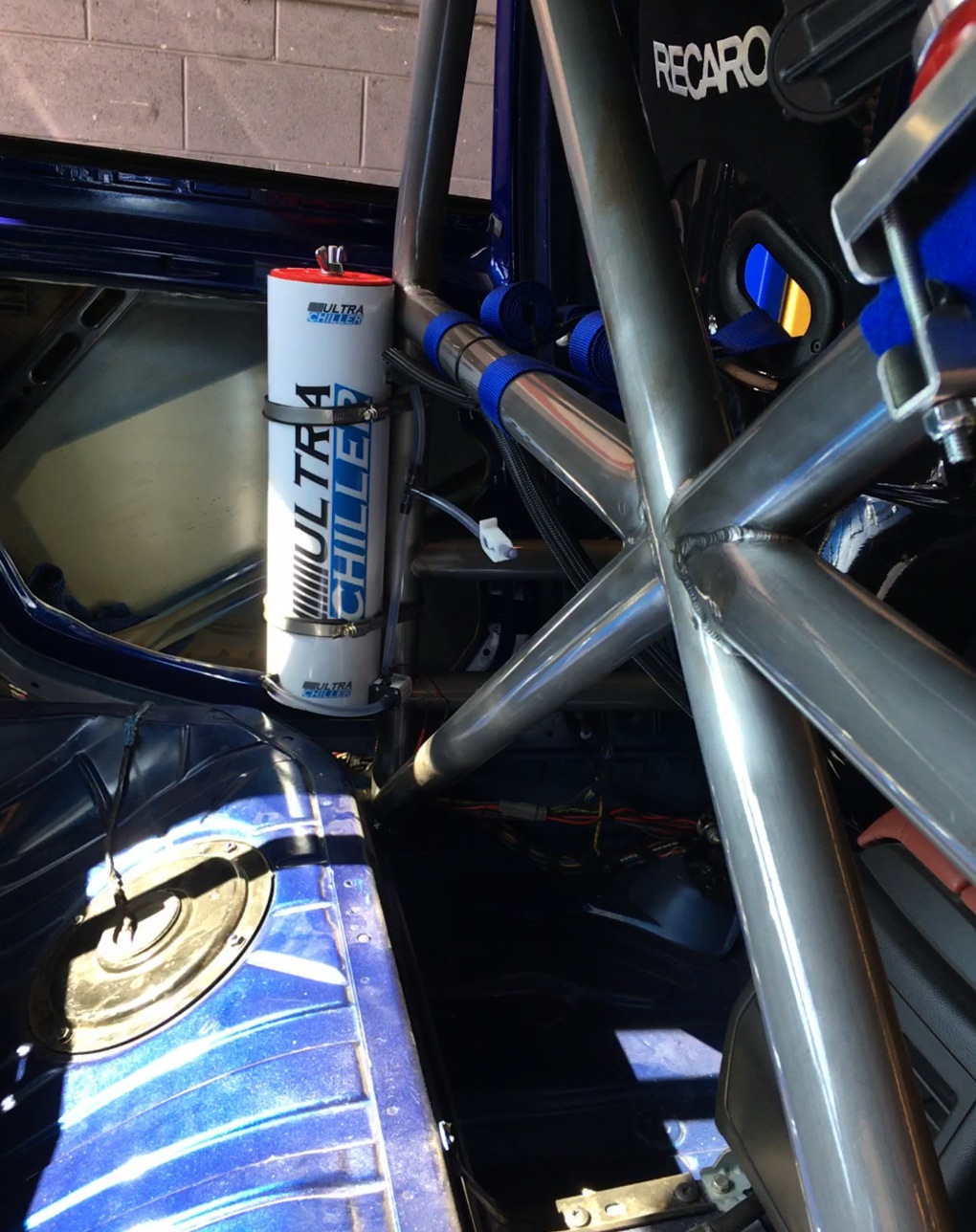

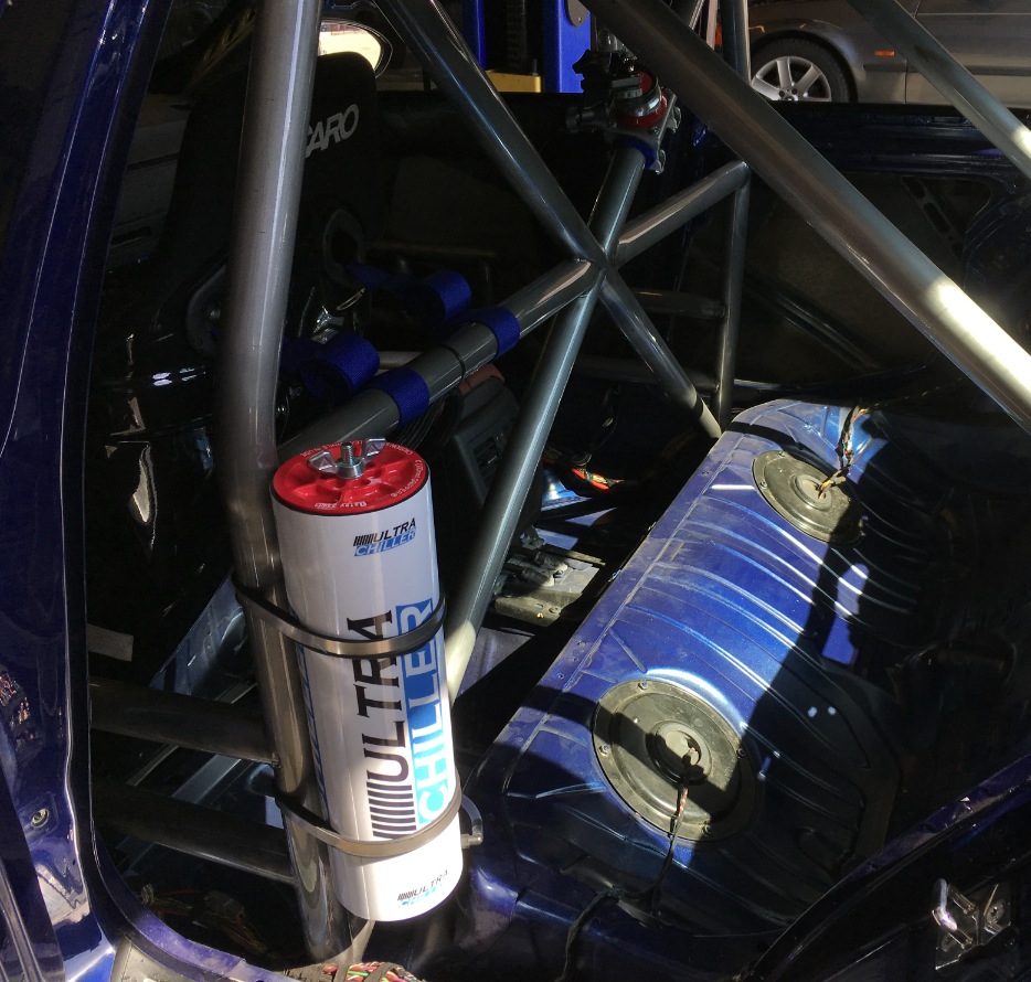

dogbone - tell me more about Ultra chiller - vs typical cool shirt w big 12/24 qt box - Obvious diff is the size. How is the longevity of the "coldness"?
      11-03-2015, 12:04 AM   #64
dogbone
dogbone's Avatar
5576
2,866
Drives: '09 E90 M3 - IB
2009 BMW E92 M3  [0.00]
2009 BMW E90 M3  [0.00]
I was considering both Cool Shirt and Ultra Chiller. Currently, the UltraChiller system cools for about an hour, but they are working on a mod to the system that will allow it to cool a LOT longer. From what they told me, they may have the cooling upgrade in about a month or so. For me, longevity of cooling wasn't an issue because I'm just an HPDE guy who does some time attack.
Ultimately, the thing that really drew me to the UltraChiller was the canister that straps to my cage. I've heard the stories of ice chests coming loose and bouncing around during a bad wreck. That's the last thing I want----20+lbs bouncing around…..So, for me, the canister seemed better than an ice chest that's webbing-strapped to a plate. Plus you gotta undo all that stuff to pull the chest out…..blah…..The UltraChiller has a red top that simply screws off and you can scoop some water out quickly (or have drained it) and dump ice in and you're good to go.
I got mine with the optional power switch. Very glad I did that. It's nice to have the option to turn it off and on.
The UltraChiller shirt has the water lines extend out from the front middle bottom. Cool Shirt has the tubes on the side. Cool Shirt recommends cutting a hole in your racing suit pocket to get the lines out. UltraChiller has you unzip the suit from the bottom to get the lines out. I preferred the UltraChiller method. Cutting the pocket liner is perhaps not deadly, but it's still an odd mod.
I believe UltraChiller is a little less money than the same Cool Shirt system.
Hope that helps.

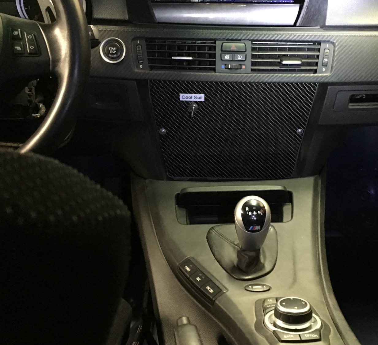

A few more minor updates:
-Powerflex Front Tension Arm to Chassis Bushings - minicorsa installed these bushings for me. I've driven them at Chuckwalla and Big Willow. I can't say I notice any difference with them. But I wanted to replace them since they are rubber-only bushings and they've seen plenty of action.
-Casey at RWE made a blank panel from carbon fibre to fill in where the radio controls used to be. We're using the panel to house switches. It looks quite nice! The first switch to go on there was for the cooling suit. I would also like to add another switch for the misting system. Currently the misting system does have a power switch, but it lives in the engine bay.
-I went to Big Willow this past weekend with full aero for the first time, and I was able to reduce my personal best by 2.4 seconds, down to 1:28.44. The aero offers amazing stability. It's so awesome that as I was coming into Turn 9 and braking and turning in---without any effort or drama, the car went instantly from the outer edge to the inner edge of the track without any problems. I was like….uhhh what am I doing over here already? hmmm I guess I don't need to slow down as much or turn in as early. It's going to take awhile to get used to the grip.
So, Buttonwillow is next. I'm really curious what's possible there. In addition to full aero for the first time at Buttonwillow, I will also be trying BFGoodrich R1S too. They're supposed to be grippier than TD's……we'll see!
