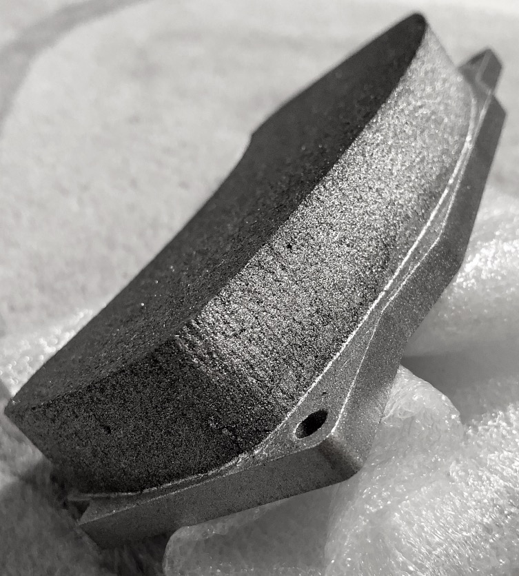

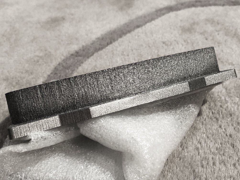

Well, let's just file this one under----BEEEFY!
The 25mm Cobalt Friction XR2 pads arrived today for the 9668 Radi-Cals. Holy cow! Can you say beefy? (Did you see what I did there?)
Anyway, I have some 18mm XR2's on there now. I'm debating whether I run those out and count the days to compare wear rate to the old kit, or just slam these babies on there and get going.
I had the same reaction to the 25mm pads they are huge! Can't wait to feel the difference of this kit on track. Still can't believe these are 12 lbs lighter than the st60s!
Yeah 12 lbs less than the Stoptechs is pretty awesome.
Looking forward to hearing how you like them!

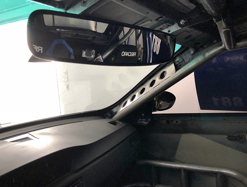

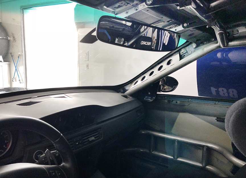

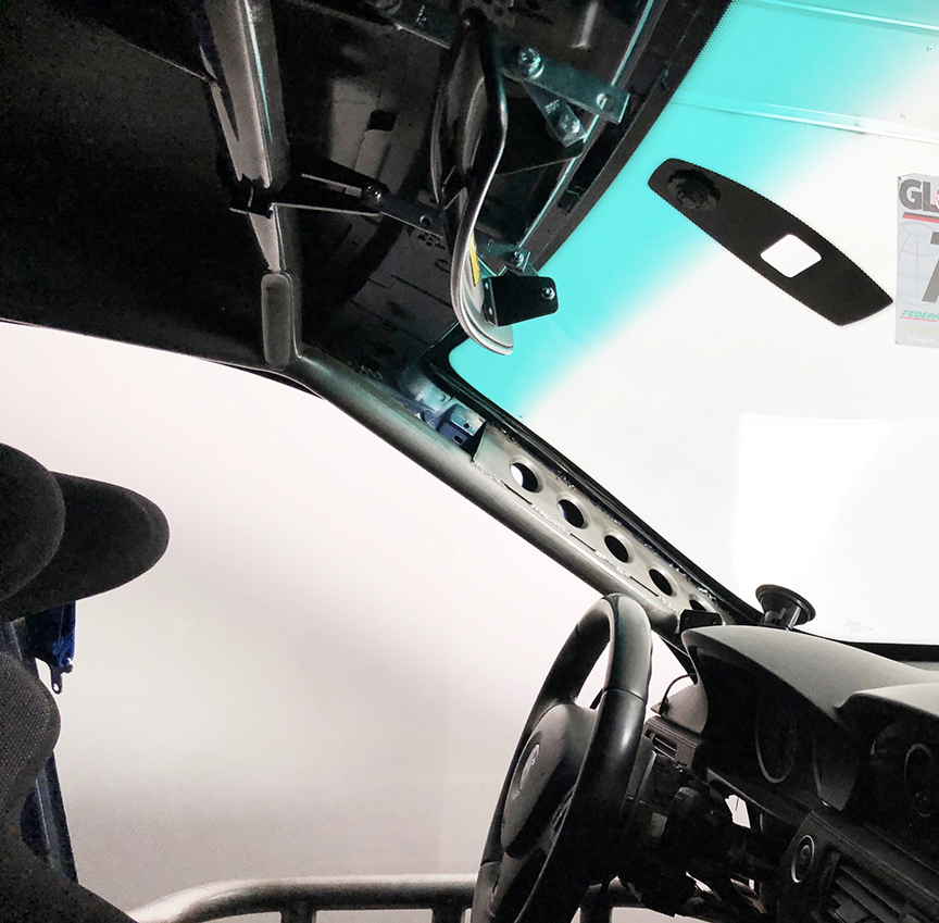

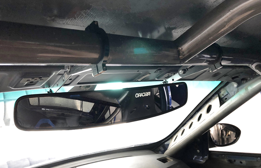

A small mod, but one that will get constant use: Convex Rearview Mirror!
As I've been experimenting with video camera placement in the car, the OEM rearview mirror has been blocking the view of the track. This was finally the push I needed to experiment with a convex mirror. Due to the placement of the overhead cage tubes, I knew I couldn't just use a mirror out of the box because I would need to somehow extend the arms holding the mirror.
So, I went to a hardware store and bought a few sturdy metal bars to use as extenders. My goal was to keep the mirror as high as possible, and as far forward as I could. I think I fashioned something simple that will work. It feels sturdy when I pull on it with a fair amount of effort. Hopefully I can get out there soon and try it out.
Now, I'm wondering if I can get that black stuff off the windshield that was behind the OEM mirror. Anyone ever try razor-blading that off? Or have any better ideas?
