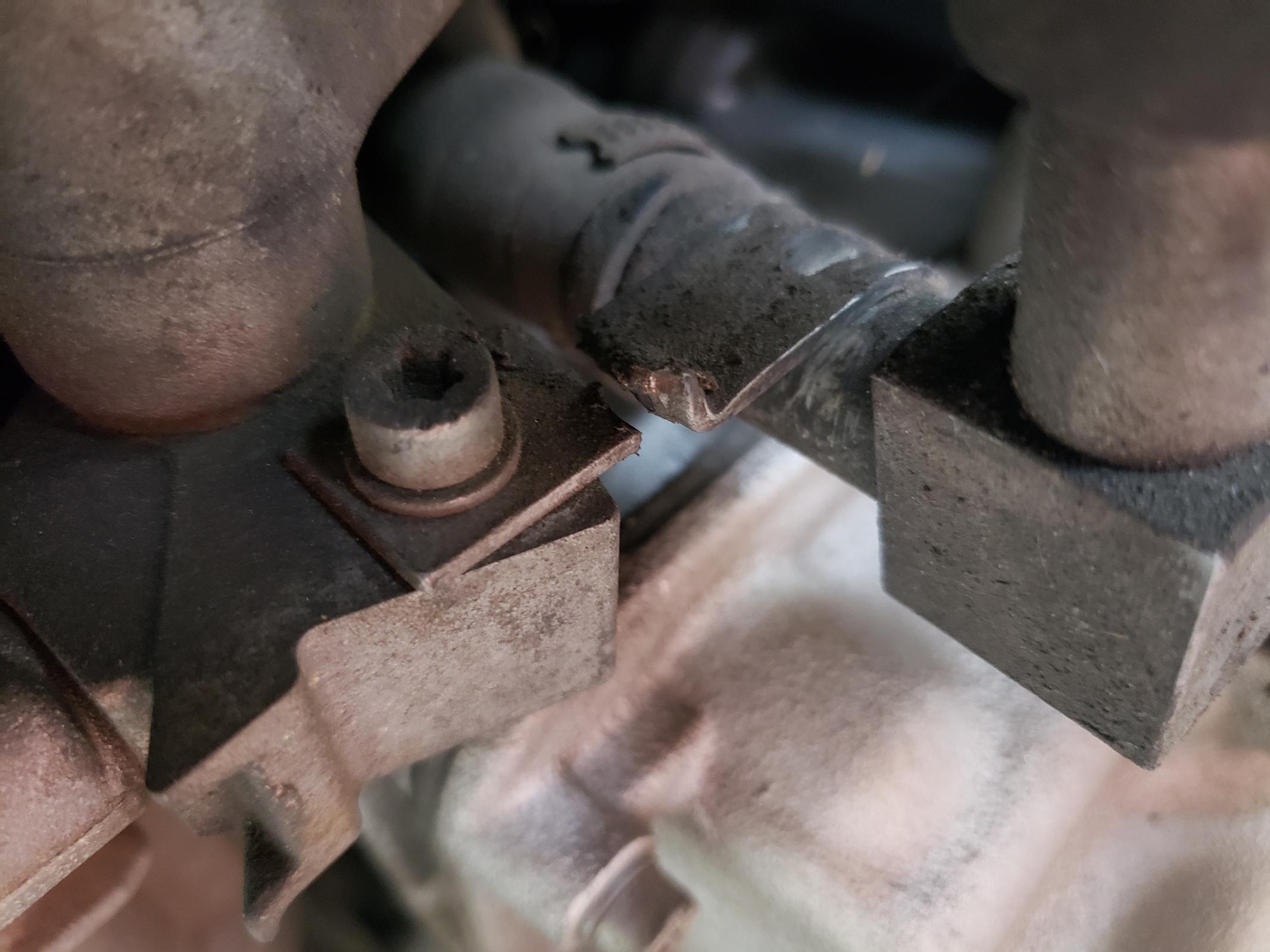

Yes totally normal for it to be wet. I mean it had its tip in, right?
The heat protection shouldn't look like that. Something ate it or something
I had some problems with mice
But they're gone.

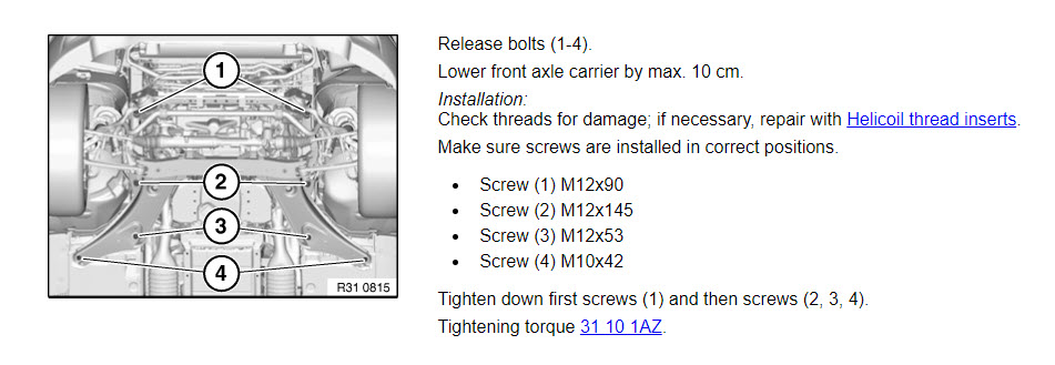

Guys, during this procedure, I can't help thinking everytime on how awesome is this DIY guide, excellent idea of the member SYT_Shadow, great help to a huge amount of people. Thanks alot to him and to everyone who is always here answering questions and sharing knowledge. This is BMW!
About the subframe bolts, the guide says 6 bolts, but I found 2x 16mm bolts and 3x 18mm bolts each side, which sums 10 bolts total. Am I misunderstanding?

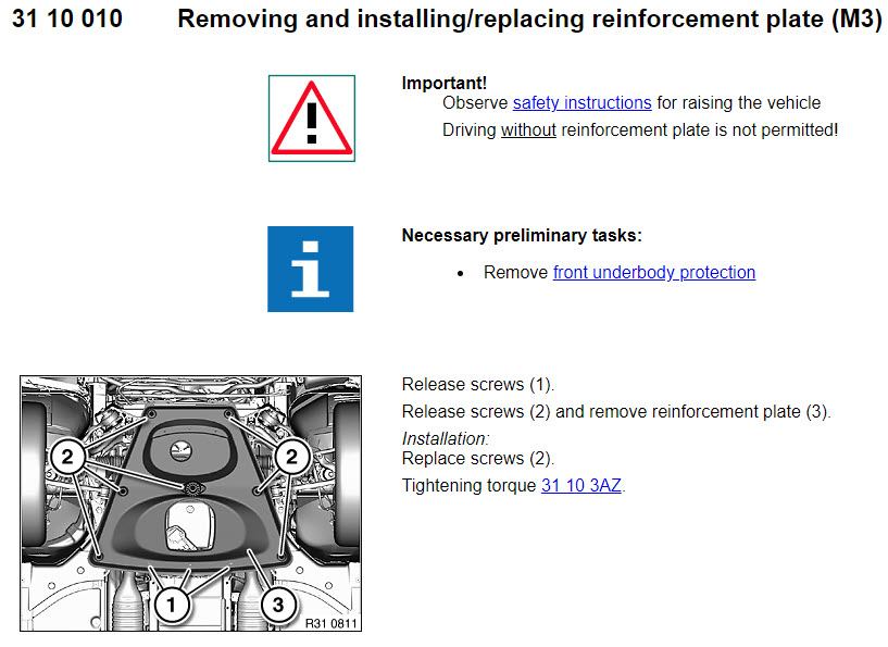

ummm... You really do need that reinforcement plate
Also, I attached the sub-frame info. There are a total of 8 fasteners for the sub-frame and 7 for the reinforcement plate.
Yes, I know. But it simply doesn't exist here in used condition, a new one is absurdly expensive buying locally, and - not absurd - very expensive buying from USA.
For now I focused the money on changing the bearings.
The plate will be the next acquirement.
By the way, what you see that is the danger of not having it, during street driving?

Maybe a local shop could sell you a flat piece of 1/4” aluminum and you could make one. Or you could weld up an X brace out of steel or aluminum.

I'm posting images of the engine mounts, in awful condition. May have never been changed, 12 years, 41,000mls.
I'm also posting pictures of a hose bracket I found broken in front of the ac compressor. Can't know what part number of that, and don't know what hose is that for. Helps are welcome.

A metal hose clamp could replace the broken one. Something like this:
https://www.lowes.com/pd/Hillman-2-P...E&gclsrc=aw.ds
Or you could make one out of a piece of flat steel bent and drilled. The idea is to reduce movement so it does not move enough to rub something or does not stress any joints or connections in the piping before it turns to rubber that can absorb movement.

The reinforcement plate is there to ensure the lower suspension parts do not flex the sub-frame when loaded. Not sure if it is critical if just driving around normally but if it was not required, BMW would likely have not installed a big heavy metal pan under there.
Amazingly enough, the plate does not look too expensive. No way for you to get someone to ship one to you?
