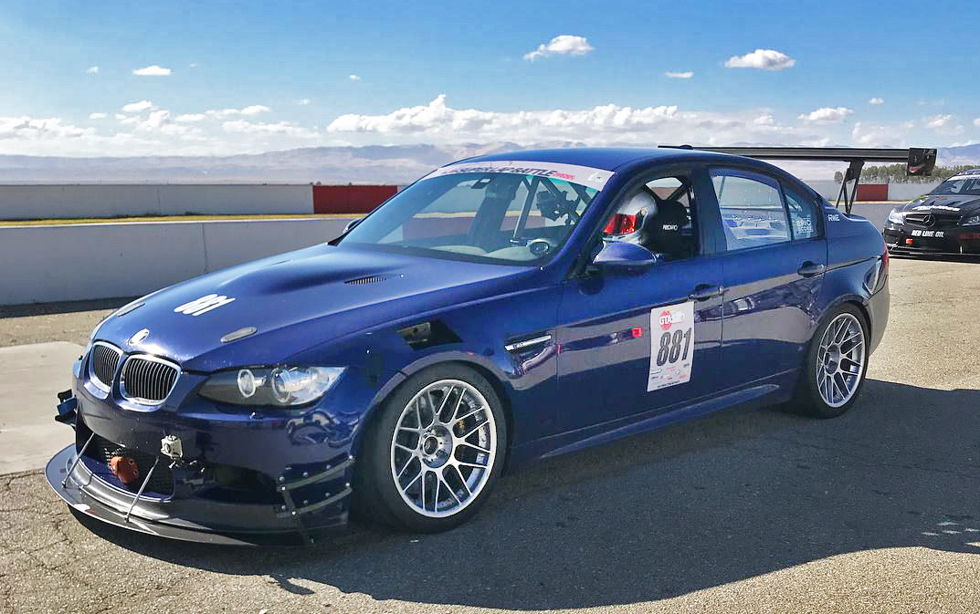

Another Super Lap Battle has come and gone. As usual, it delivered ups and downs and everything in between.
Ultimately, I got 4th place in the Unlimited RWD category with a 1:49.5. And while I'm unhappy about my lap time performance, the competition was stiff enough that regardless of how I could have driven, there was no way for me to move higher in the standings. 3rd place was a 1:47.2. I have never driven that fast. So, 4th was as good as I could do. But overall, I drove poorly, several sessions were hampered by other cars breaking down which prevented running clean laps, and I had some nagging tech issues that ultimately forced me to end early. hehe Motorsport----it can be challenging, exciting and rewarding, but it can also chew you up and spit you out pretty dang quick.
On the Sunday prior to SLB, I went to Buttonwillow to practice. I put on good tires and rolled a 1:48.3---no fuss no muss. I felt like I was ready. I even hoped that a 1:47 was possible. I have yet to roll a 1:47 and I was hoping that this could be the time.
During the SLB practice session on Day 1, I was patient and built up speed slowly on slower older tires. Rolled an easy 1:52. Things felt good. I was optimistic.
However, the first timed session of the event with the coolest air of the day was a waste. On the first hot lap of the day, a car broke down and parked off the outside of Riverside and they Yellow flagged the session for a lap or two. And then they left him sitting there for the rest of the session. If you hooked at Bus Stop, you would have hit him. Combine that with drivers that wouldn't let me by, and me flying off the track and my best lap time was a whopping 2:02 during the first session. I'm glad I could waste my good tires on that ridiculous session. And the next session wasn't until 1:30PM.....too warm to do anything great in my car.
Day 1 overall was frustrating.
And Day 2 was full of pitfalls too. I went out with some fresh R1S tires, and I was driving a 1:48 lap through the final turn and onto the front straight, and I look at the Start/Finish Flag worker, and he's waving a Red Flag to stop everyone on track because a Miata was having a fire issue near Turn 1 on the front straight. I stopped on track and smoke was just POURING out of my brakes. I had done two full-on hot laps and then came to a sudden stop, so the brakes were super hot. With Red Flags, you're supposed to be within sight of a flag station. I couldn't see the Start/Finish worker, so I decided to slowly backup so I could see him. I also figured that would allow me to move the brake rotors. So, I start creeping backwards super slowly. As I do that, I start hearing yelling. I had ear plugs in, so at first I didn't know what it was. But then I hear my name being yelled. It was the Start/Finish guy yelling, "Gabe, your car is on fire! Get out of the car!" I'm like what???????? So, I immediately exit the car, and the fire crew leaves the Miata and comes over to my car. He looks at my rotors and says something is flaming inside the rotors. I was down on my hands and knees and did not see any fire. He guesses that some track rubber caught in my rotors has flamed up because the brakes are so hot. At first he was thinking of spraying water in there, but then he decided not to because it would most likely crack the rotors. I was glad that he didn't. He finally decided that whatever he saw in there is fine and he tells me to do a lap under the Yellow caution flag to cool things off and just check it out in the pits.
I got to the pits and checked everything out. It was all fine. I talked to several people who had witnessed the event, including the Start/Finish worker. They all said that when I went in reverse, some flaming bits dropped out from under the car. Everyone now believes it to be track rubber that lit up inside my brakes/rotors and fell out when I slowly went in reverse.
Anyway, that was very indicative of how my SLB went----going from a 1:48, to a complete stop under a Red flag, to igniting track rubber in my hot rotors and having to jump out of my car......not how I had hoped it would go.
And I haven't even gotten to my nagging tech issue yet!! I run wide tires on the car. The front tires have been rubbing all kinds of things, including the intake tube for the supercharger. It's been rubbing the side of the tube enough that part of the tube is worn away, which makes it hard for a hose clamp to keep the air filter's ducting attached to the supercharger intake tube--especially if a fat tire is jamming up against it and tugging on it (Damn that Off-Ramp corner!). In fact, at the end of Day 1, the clamp fell off in my paddock area and I didn't notice as I was putting the car in the trailer at the end of the day. But at the start of Day 2, I looked behind my trailer and I saw the hose clamp sitting there on the ground. So, I reattached the clamp before session 1. After session 1, I checked it and it was off again. So, I reattached it and drove session 2, and it was of again after session 2. After session 2, I cut an entirely new section of air hose, used a new clamp and basically started over with fresh equipment. I was actually proud of myself for fashioning a new air duct right there in the paddock. And then in session 3, I am going through the Off-Ramp turn and I see my brand new hose clamp sitting in the middle of the turn. (Damn that Off-Ramp corner!). Time to go home!! So, now I need to sort out some kind of permanent solution for the air duct since I want to keep running as wide tires as possible. And at least now I know which turn was the major culprit! That Off-Ramp turn is nasty in so many ways!
A Miata took 1st place this year, surprising everyone by displacing the RX7 from last year. The RX7 dude thought he had it in the bag again this year with his 1:45.2 and packed the car before the event was over. He didn't run the last session. And then in the last session of the event, the Miata went out there and dropped a 1:44.9 funk bomb on the RX7.....haha! It just goes to show you, it ain't over 'til it's over! I have found that to be a typical strategy---holding your cards close to your chest until the last session and then letting it all hang out. It's a bit risky, but it paid off for the Miata. If the RX7 comes back next year, I'm quite sure he won't be packing up early figuring the victory is assured.....hehehe (Everyone who hears that RX7 is convinced it has a Corvette/LS swap in it. It sounds like big American Muscle jam packed into a light Asian chassis. Pretty wild car. Any RWD car dropping a 1:45 is moving.)
A couple other performances that were notable:
-A 991 Cup Car was out there. I was told it was stock. It was turning 1:41 laps.....holy cow!
-A Miata in the Limited RWD category was dropping some crazy times given the tires on the car. GTA's rules state that Limited can only have a minimum of 100 treadwear tires. The Miata was doing 1:48 out there on 100 treadwear tires!!! yikes! The closest car to him was 3 seconds off his pace! It seems like every year more Miatas show up with crazier and crazier mods. Given their low starting weight, I'm not surprised. (As a comparison, a gutted E90 M3 weighing 3185lbs with bolt ons, full aero and a competent driver was at 1:54 on NT01 in that Class.)
-An Evo ran a 1:40
-The YimiSport STI caught fire in the practice session on Day 1. Those guys left the track and came back in the middle of Day 2 and still dropped some 1:42 laps!! I don't know how the hell they put that car back together overnight, but I'll bet no one got any sleep!
-The BMW M4 that took 3rd place in Unlimited RWD was built by Racewerkz Engineering which is my race shop. In fact, Casey co-drove the car with the owner and Casey was the one who drove the 1:47.2. So, I was competing with my own race shop! hehe That's ok. I'm happy to keep 3rd and 4th place in the Racewerkz family. It was nice to have two Racewerkz BMWs near the top of the list. We were fending off Mazdas, Hondas, Mercedes, other BMWs and Nissans.

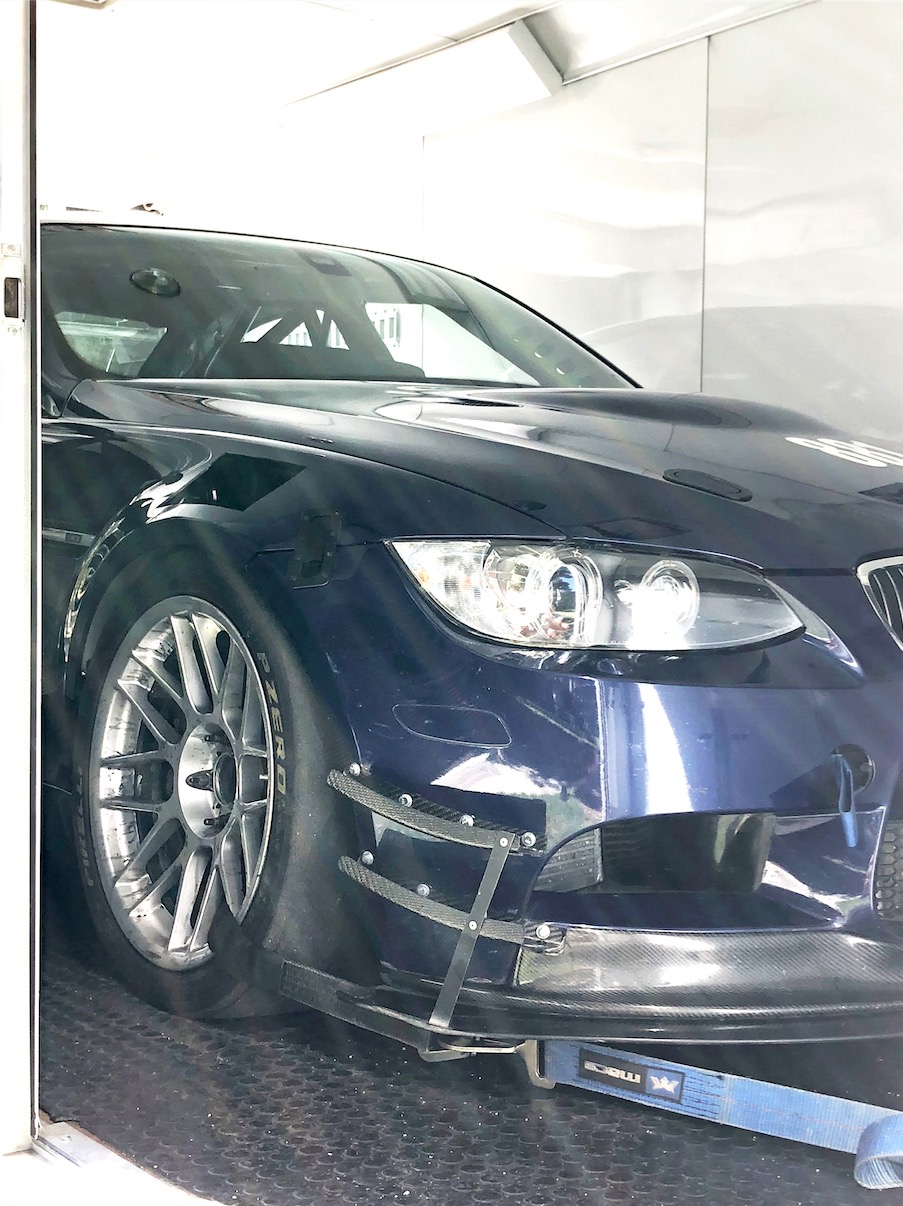

Argh---I almost forgot! I had one mod on the car to show you! We did this two days before Super Lap Battle.
So many race cars I see have vents over the front wheel to relieve pressure and increase airflow. I figured why not try it? So, I had Racewerkz cut some simple vents in there.
To be honest, I didn't think it would net much difference. And I didn't feel any difference while driving. But I was distracted at SLB with flaming rubber bits, broken down cars and rude drivers. So, I'll take some more time to see if I can feel a subtle change like this.
Photo Courtesy of GTA Facebook page:
I took this shot the day before SLB after washing the car:
M3runner346.50
