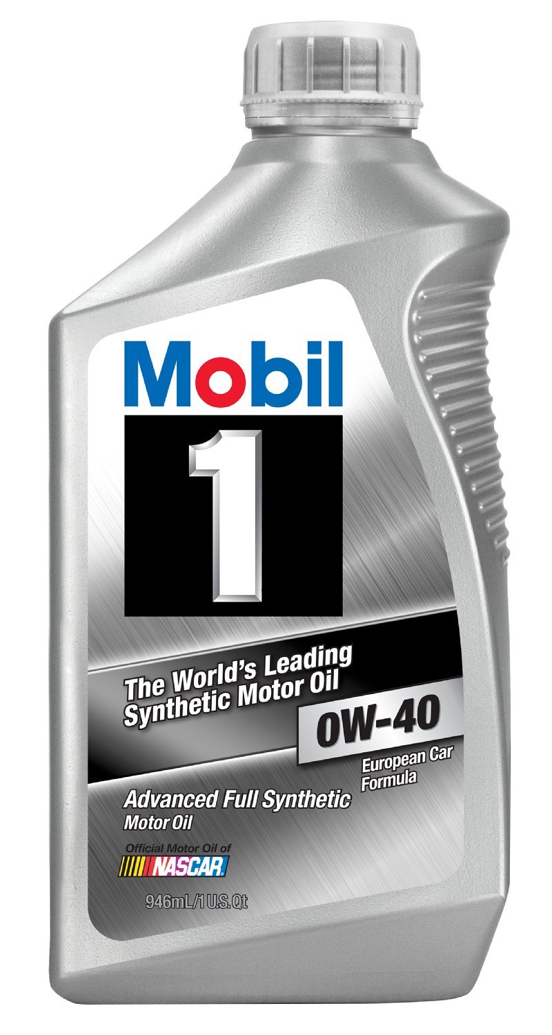

I'm assumung the Mobil1 0W-40 is the one on sale at Wal-Mart right now for $22.47 for a 5Qt jug? I never thought I would see a $60 Oil Change on this car.
Much applause to all of you gentlemen. I've been lurking and following this thread from the beginning and chatting with B767Capt a bit for the last month or so on this.
I'm ordering my bearings soon for a preventative swap in the next month or so. Scrounging the cash though to replace the VANOS high pressure pump with the new style while I'm in there (you S65 guys got the better end of the deal on that part).
Will post pics of mine here when it happens as well.
One final question though. Assuming an S65/S85 sustains the premature wear earlier in its life, is it possible that through switching to a thinner oil and being more conscientious about warm-ups and lugging that the engine could survive a much longer life without spinning a bearing? Obviously, better behavior would prolong the life of any engine, but I guess I'm asking is it possible that once a motor has wear along the lines of what B767Capt had, proper engine care would have prevented it from ever coming to an engine casualty?
oooff deep breath...likely will go M1 0-40 on the next change as well. First time going away from factory recommendation.
Yes, agreed, TWS is about $13, M1 0-40 is about $4, (did I see that price right $22?!) big difference since the M3's mulitplier of number of bottles needed on this is about x10! Saving over $85 per change. Holy cow.
I believe Walmart should carry it, there's only one type of M1 0-40 offered in the US, should look like this:
http://www.amazon.com/Mobil-96989-0W...mobile+1+0w-40
http://www.mobiloil.com/USA-English/..._1_0W-40.aspx#
Yes, agreed, TWS is about $13, M1 0-40 is about $4, (did I see that price right $22?!) big difference since the M3's mulitplier of number of bottles needed on this x9! Saving about $81 per change. Holy cow.
It is a big difference, it takes no more than 20 minutes to change the oil on this car. 45 for oil and 17 for a filter. At the price point I am changing it every 4k miles. I was in wally world last night and saw that price, in my area it is a price cut not on sale so that will be the price going forward.
Buy 2 jugs, the walmart version is 5.0qt, the advance version is 5.1qt and the autozone version is 5L.
I have a pyrex 1L graduated container from the kitchen ware dept, I pour 1qt out of one of the jugs which makes 9qt and it puts the level meter at 7/8 full.
9qt=8.5L
Remember I have brought this up before, this car was designed in 06/07, oil technology has changed a bunch in the past 6 years. What was absolutely necessary back then is not always the case now.
Mduso,before my ///M3, i had a 325 i for more than 15 years and i run 315,000 km's with it,and without any problem !
And i used all the time this Mobil 1 0W40 oil but in the golden packaging(SuperSyn)Protection Formula !
It seems also that the engine is quicker warmd up with the Mobil 1 than with the Castrol TWS!
Also...i have found this,a comparison between this 2 oils brands, and with Blackstone oil reports....interesting data ....http://www.m5board.com/vbulletin/e39...il-1-0w40.html
thanks, but I noticed on the external forums that US and European bottles are different labels, so thanks for the picture, but I don't want to confuse people here that there may be some gold label in the US, as you're in Europe.
Also, the 325 engine tolerance are different than the M3's S65 tolerances, so it's hard to say your experiences using 0-60 in a 325 will also result in great protection on a S65/S85 engine.
