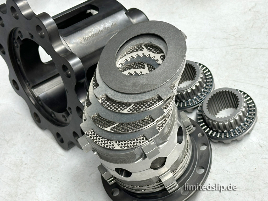

... and also working on and developing new lsd stuff. carbon friction material, lightweight cores and the likes... more coming soon!

30° is something i would not build at all. this is an aggressive low budget/high pressure ramp. no driving style will want/need this.
think of a big old turbo with huge delay and massive torque explosion.
does not make sense concerning drivability. no one would build such an engine today (except straight line driven cars maybe)... development went on!
there is only one advantage for such a ramp: the diffbuilder can get/sell high lockup values with low parts costs... at the expense of drivability and durability.
Originally Posted by Track/S View Post
I hope it's not because Drexler doesn't make or sell those ramps
if drexler does not make the ramps i want, i have them made these ramps for me ;-)
i have/sell a lot of rampsets that they do not have and manufacture exclusively for me... because i think i need them to build the perfect setups.
but i do not think i need a 30/60° rampset for a bespoke "limitedslip.de" m3 lsd.
talking about 30° ramps is pretty basic, very old school stuff tbh.
zf themselves went on to steeper ramps in the 90s already.
things move on in lsd development quickly in the last time. friction materials, oils, ... there is a lot of development going on to make things even better in various aspects. but as this is quite complicated and most people do not know and care about how this stuff works, nothing of this gets published/advertised.
i.e. the new 992 gen gt3rs features carbonfiber friction material. but not even porsche does advertise this in any way. but it adds a significant bit on how this car performs.
now i have these discs adapted to be fitted in my new lightweight e46/e92 lsd cores.
the first of these units are running perfectly already. i just did not have time to photo-shoot and advertise this stuff yet.

Originally Posted by m3s65b4.x View Post
Which setup is dream goal ultimate setup with those new light core LSD's, carbon baked discs and newly developed oils?
lightweight core
lightweight internals
special heat/hardening treatments
special surface treatments
needle bearings
carbon discs
custom ramps
...this is how a next gen clutch type lsd for e92 m3 looks like ;-)
so a 1989 m3 e30 is/was a great car for sure... but this is how a 992 gt3 lsd looks like nowadays... plus a bit more in this "ultimate" configuration pictured above adapted for the bmw e92 m3! (developed and exclusively available from limitedslip.de)
