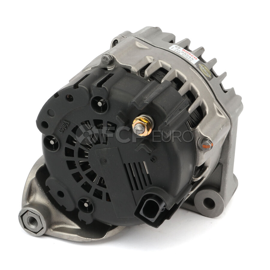

Found something odd on FCP's website for the refurbished "Bosch" alternator. Two brand names are shown in photos of the unit...
https://www.fcpeuro.com/products/bmw...ch-12317837981
https://www.fcpeuro.com/public/asset...-AL9454X-1.jpg
probably just how it's remanufactured.
