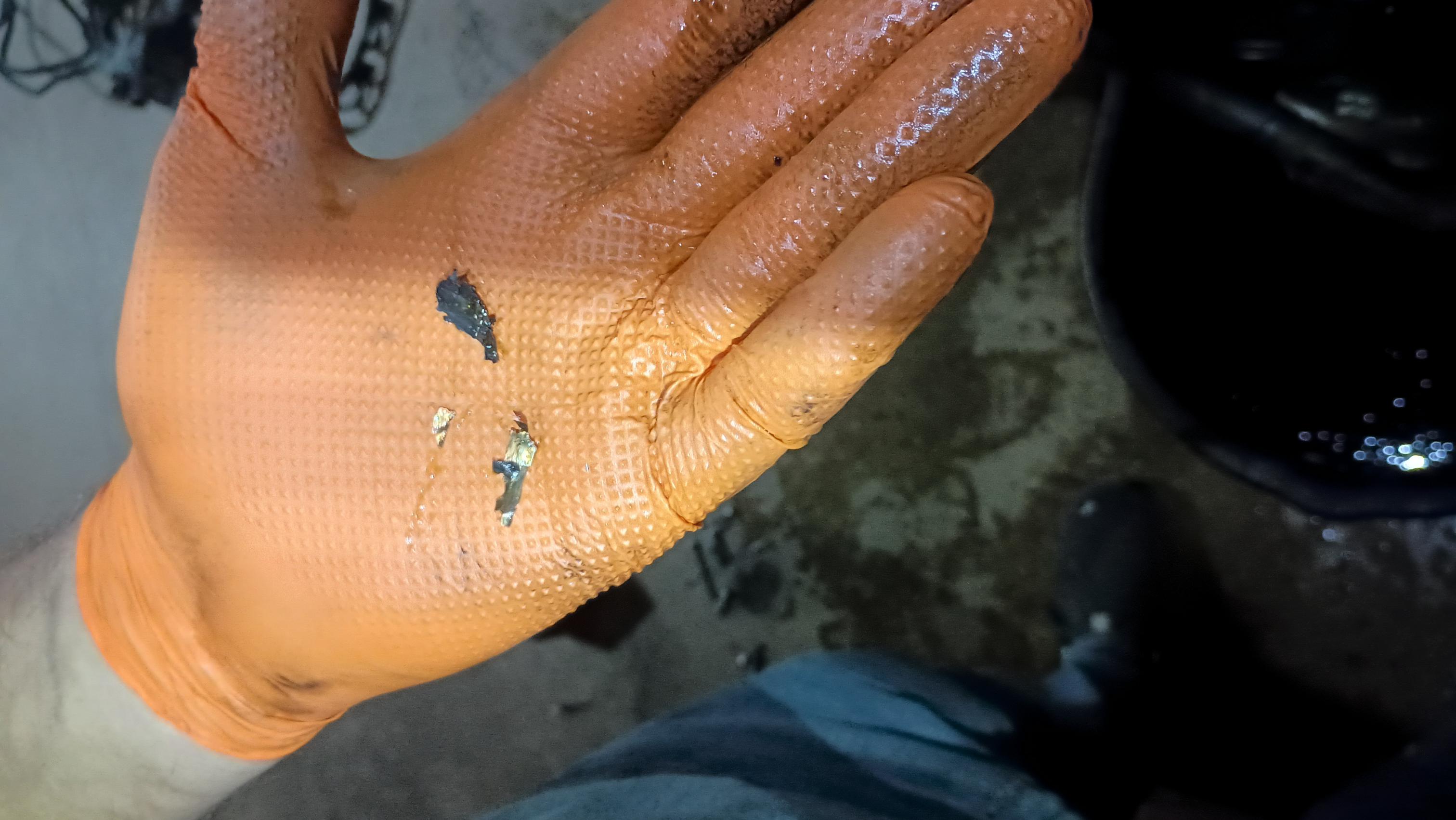

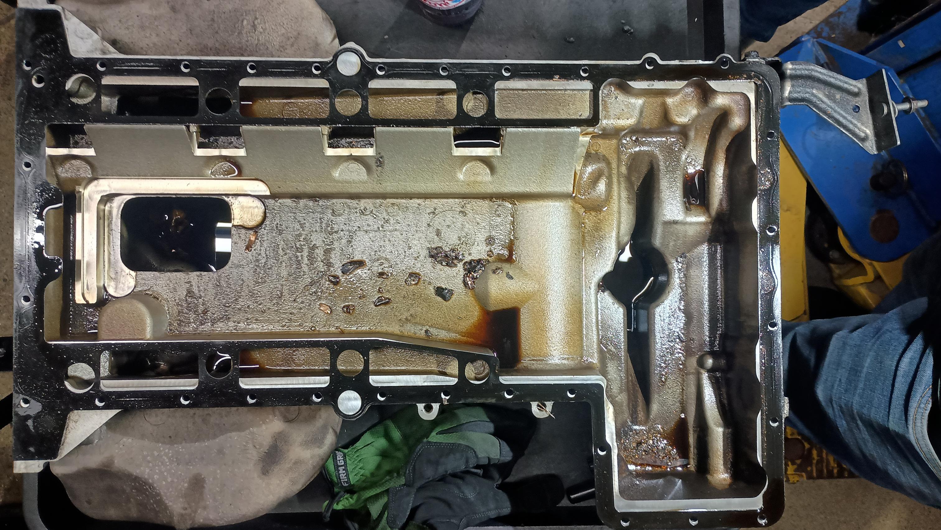

Small update:
I have got the engine out and on an engine stand now. Had just enough time to pop off the oil pan to quickly inspect before having to stop for the weekend. Definite heat issues at the front of the engine on the ROD caps for Cylinders 1 & 5. We pulled the bearings for Cyl 5 and this is the result. Unbelievable the carnage given the motor had a near perfect oil analysis before the event. The heat is leading me to believe it was oil starvation but more inpsection obviously needs to be done.
More to come but wanted to share the results thus far. So far I have a new used crank, oil pan, AAF pan baffles, oil diverter kit, Mahle Motorsports Forged Pistons, and Bimmerworld Oil Dipstick kit on order. Plan is to break down the engine and send the short block to Ben at Rogue Engineering. I don't trust anyone more and am super thankful he is willing to jump in on this project. He already has my extra crank and is measuring out the journals to ensure proper bearing clearance with the new ACL bearings. We may also machine the upper bearing on the Main Bearing 1 to help with the extra stress that bearing gets on most S65's.
Lot's more to come, this week I'll be tearing down the engine and inspecting the rest of the rod caps/bearings before preping the motor to be shipped to Ben.

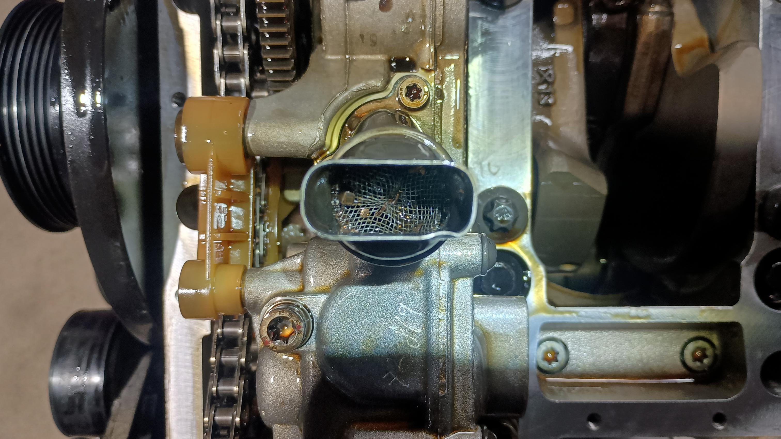

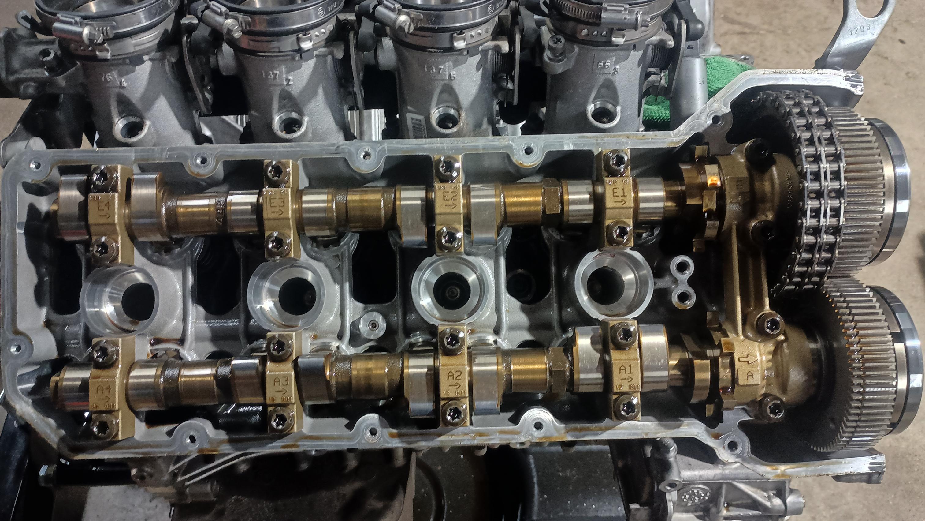

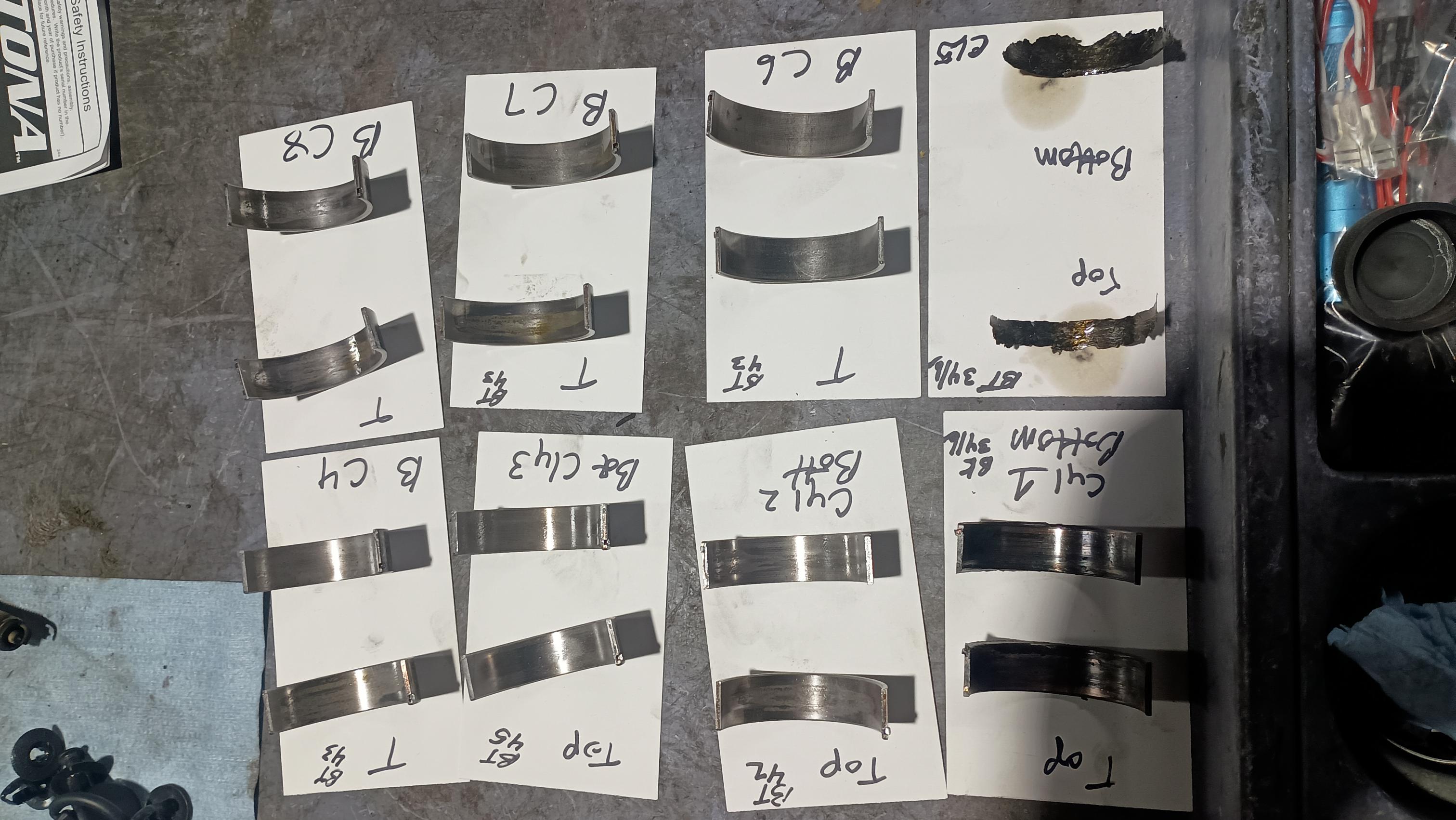

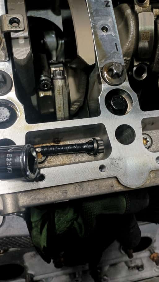

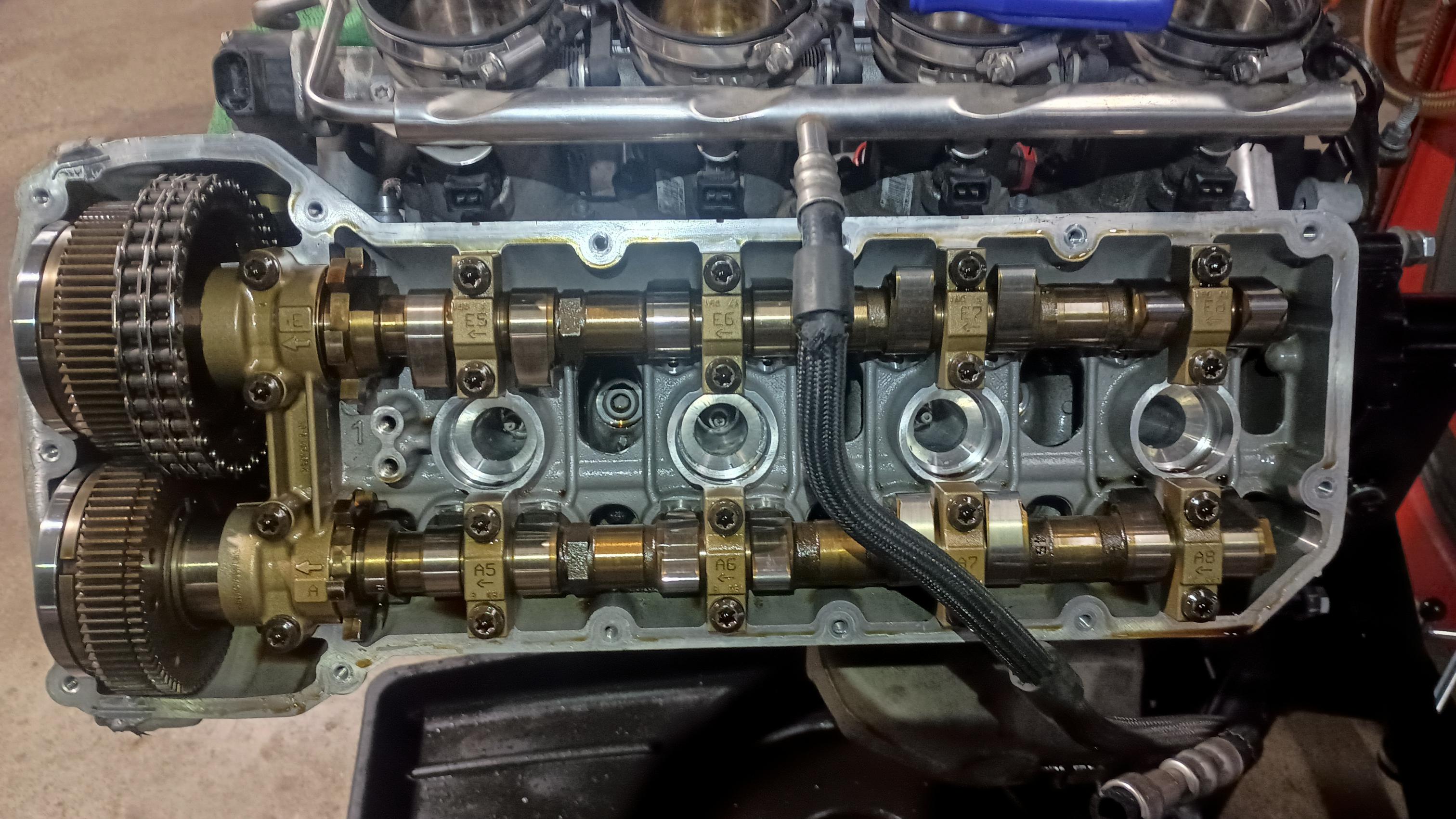

Tear Down Update:
The tear down is done. It took four days to get the engine out of the car and get to the short block. Now it's off to Rogue Engineering to do some work.
Failure Hypothesis: Road America is brutal on oil systems. From what I can deduce is that the engine oil starved multiple times during my warm up laps (5 total). Each time this happened the front cylinder (5&1) rods and crank became super hot. When the oil would flow back the heat from the RODs would pressurize the oil out the front main seal. This section of ROD's so huge color change versus the rest of the engine. With this repeating up to 15 times (true number not known) it emptied the pan of oil and caused the bearing to spin.
Additional Note: This vehicle has had 3 engines with 3 different drivers. Each engine has experienced rod bearing/main bearing failure. The only common denominator is it had the same engine builder for all 3 engines (performing at a minimum rod bearing service.) During the tear down I found inconsistencies I would not expect from a reputable shop. These included....
1. Breakaway Torque values ranging from 35(ish) ft lbs to 45 ft lbs on rod bolts.
2. Un-torqued oil pan bolts
3. Stripped bolts
4. Motor mounts finger tight
5. Failure to consistently lube EVERY rod bolt. 2 of the 16 had zero assembly lube.
6. Potentially misclocked vanos gears
I am waiting to say the name of the shop still as Rogue needs to inspect the main bearings. I want the tear down to be completed before I potentially affect the reputation of a shop.
Learnings these past few weeks:
I have learned a metric ton of information about the S65 and BMW's decision making to compromise the construction of this engine to make it a better street friendly setup. At the end of the day the weekpoint of this engine has always been bearing support, however a few items are really worth noting.....
1. Oil Temp -
Higher Oil Temps are fine for street use. You don't stay in the high rev ranges like you do in track. With the increased temp the lower the viscosity of oil. This affects oil volume flow rate, especially as RPM's increase to redline. Keeping oil temp in the low 200's is ideal for viscosity. We are talking 220ish.
2. Oil Flow -
Oil flow rate is more important than oil pressure, as oil pressure is a direct result of oil flow. The OEM oil pump has trouble keeping oil flow at desired ranges the higher the engine revs.
3. Bearing Clearance -
Tight bearings are fine for street use and help keep oil flow strong at lower RPM's. Unfortunately when you track your M3 as hard as we do these bearings are counterproductive for oil flow at high RPM's. BMW figured this out for the bearing changes but never went far enough.
My Fix:
Ideally I would be running a dry sump system, but I unfortunately don't have $10k laying around in my couch. So with this I decided on the following:
1. Rogue Engineering is now selling SRD S65 Oil Pump Gearing - These gears utilize the OEM gear pump chain and overdrive the pump +21%. There is a 15 page engineering brief on these gears and their development, you gotta read this yourself!
2. Epic Motorsports Oil Diverter Kit - although this negatively impacts street driving it's a must for aggressive track weekends
3. AAF Oil Pan baffles & BW Dipstick Kit
4. Custom machined OEM crank to be matched with ACL Race Bearings - Rogue is doing the measurements of my crank with the physical bearings I will be running.
5. Accusump - this system has been proven to help with oil volume during oil starvation situatons.
6. Epic Tune - Will have this tuned by EPIC and I will be LOWERING RPMS to 8000-8100.
7. Potential relocation of Oil Cooler to trunk - This helps weight obviously, makes the accusump install much easier, and keep the cooler away from the hot engine. I am going to run a fan and have a section of the trunk cut out for flow.
Here are the links to the parts I am going with that I have figured out thus far, let me know your thoughts and please keep it constructive lol!
Rubin
SRD Oil Pump Gears: https://www.rogueengineering.com/SRD...et_p_2518.html
AAF Baffle Kit: https://advancedautofab.com/p/aaf-s6...-w-aaf-baffle/
BW Diptsick Kit: https://www.bimmerworld.com/S65-Oil-...Parts-Kit.html
Epic Motorsports Oil Diverter Valve Kit: https://www.bimmerworld.com/Epic-Mot...it-E9X-M3.html
Accusump Kit: https://www.pegasusautoracing.com/pr...p?Product=1241

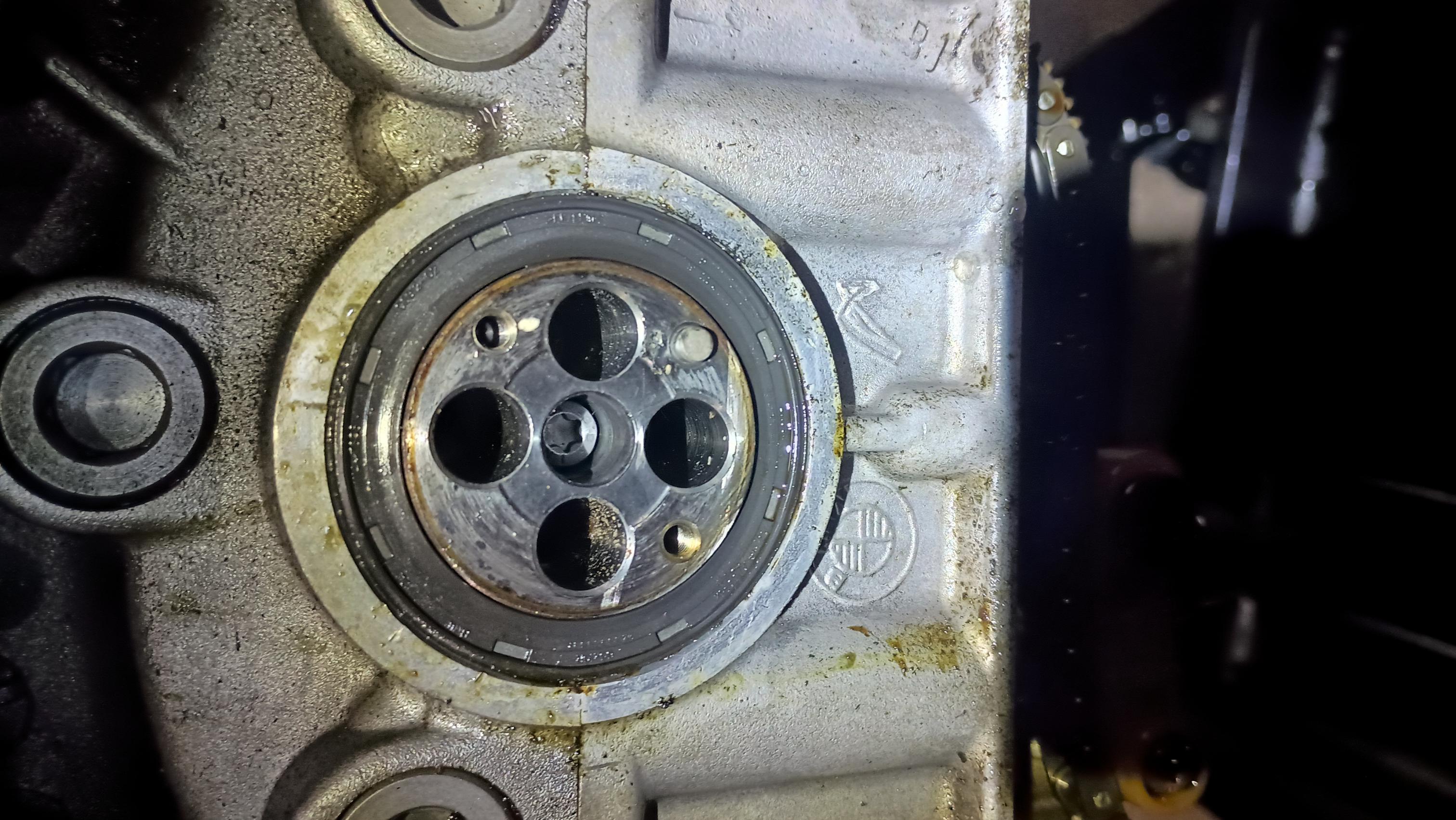

Chris at Partee had mentioned that just the act of bolting on the crank pulley expands the front of the crank enough to reduce the clearance of the first main. Lots of subtle things add up to an unfavorable stacking of tolerances
DrFerry10035.50
It's definitely a challenging diagnosis.
-Bearing clearance too tight
-Super thick oil
-Long crank snout
-2 double timing chains
-2 serpentine belts
-4 bolts on the front of the snout for the crank pulley
-8400 RPM

tdott brings up a good point. I've seen a main bearing spun to the point where the oil passage on the bearing itself was smeared shut preventing oil ingress altogether to the journal, starving it of oil.
      11-11-2025, 01:11 PM   #44
former 240 s14
former 240 s14's Avatar
559
511
Join Date: Jan 2007
Location: Cincinnati Ohio
Main bearing failure is a great point, we'll know if its the case here soon enough. Given the main bearings being new and having 14k miles on them the probability they were the culprit is small IMO, but still could be the case.
