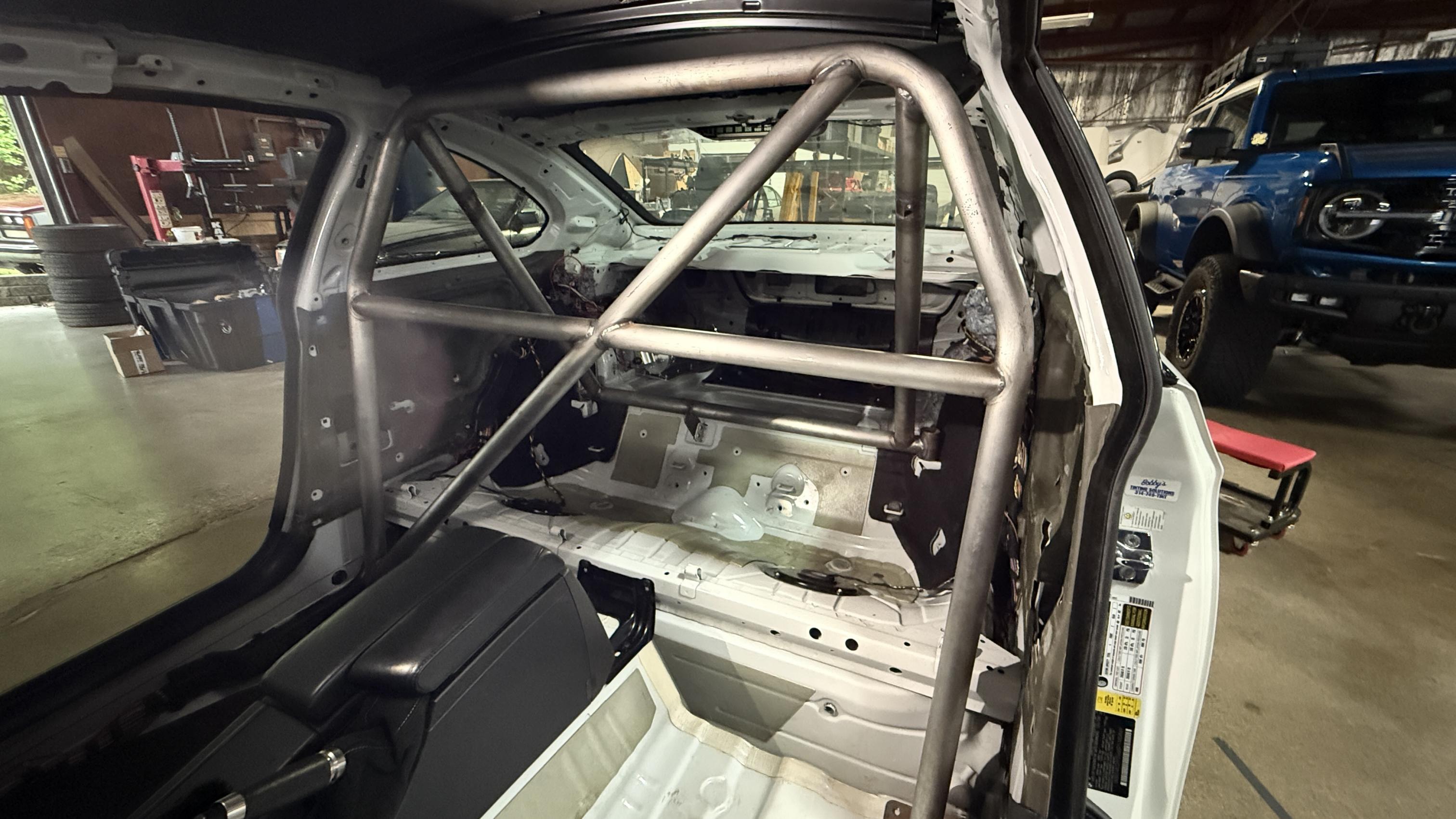

If you’re going to thin the wiring, pull it all out now and do the thinning and rerouting before the cage goes in. Assuming you already know what you’re keeping.
Very good reco! I am done at this stage of weight reduction (happy enough with the result) as I am trying to make sure that I can revert this back to stock. That said I have zero cut wires in the harness and like 3 or 4 broken clips I would need to fix if I go back.
Feel like this is about as good as it gets to keep the daily aspect of the car. With a half a tank car will weigh around 3225 is my guess, that's a good spot considering I will have a/c, front carpet, and sound deadening still. Once I go to a full W2W setup (which won't be for several years as the car is too nice) more weight reduction would be had.

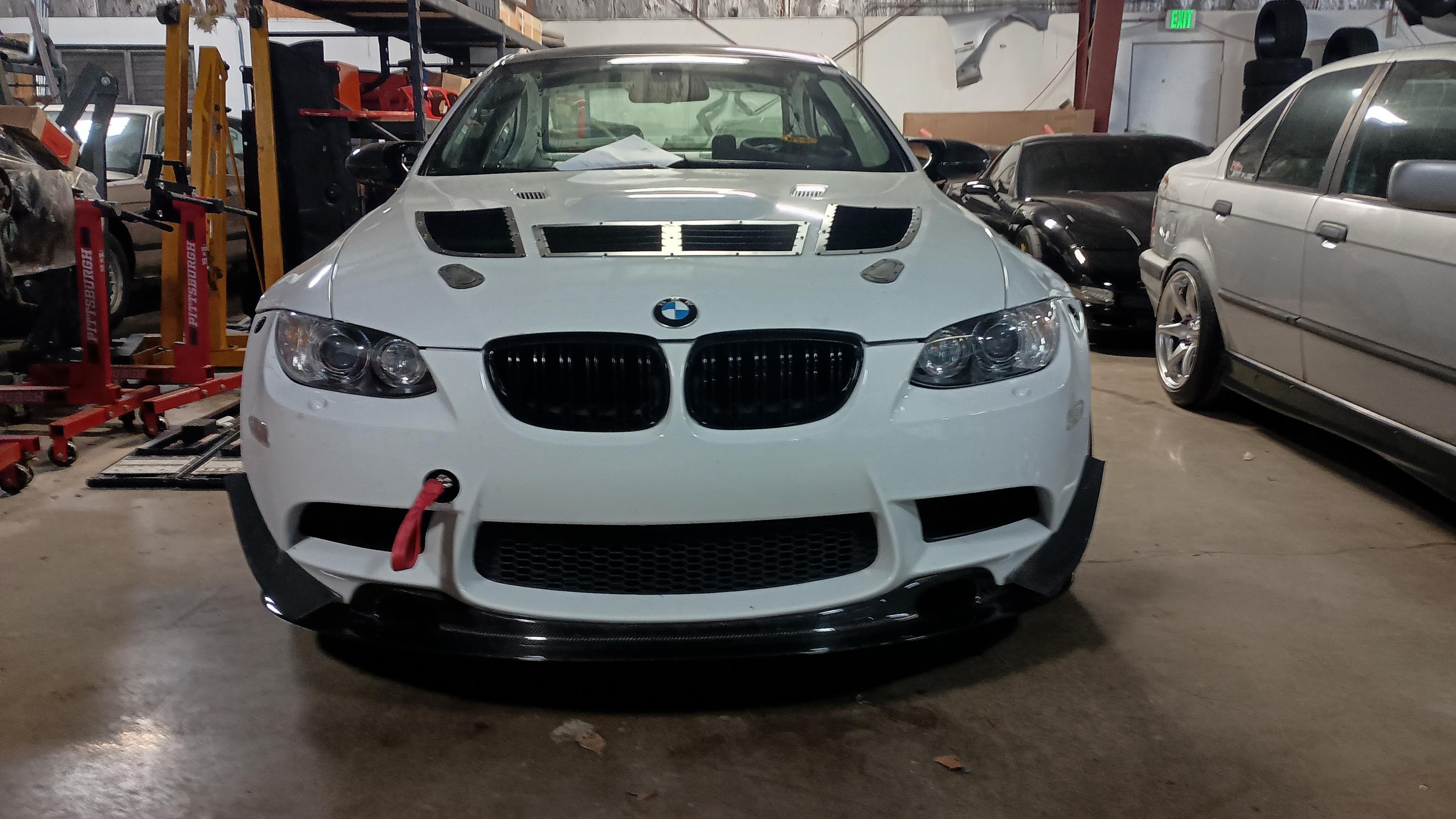

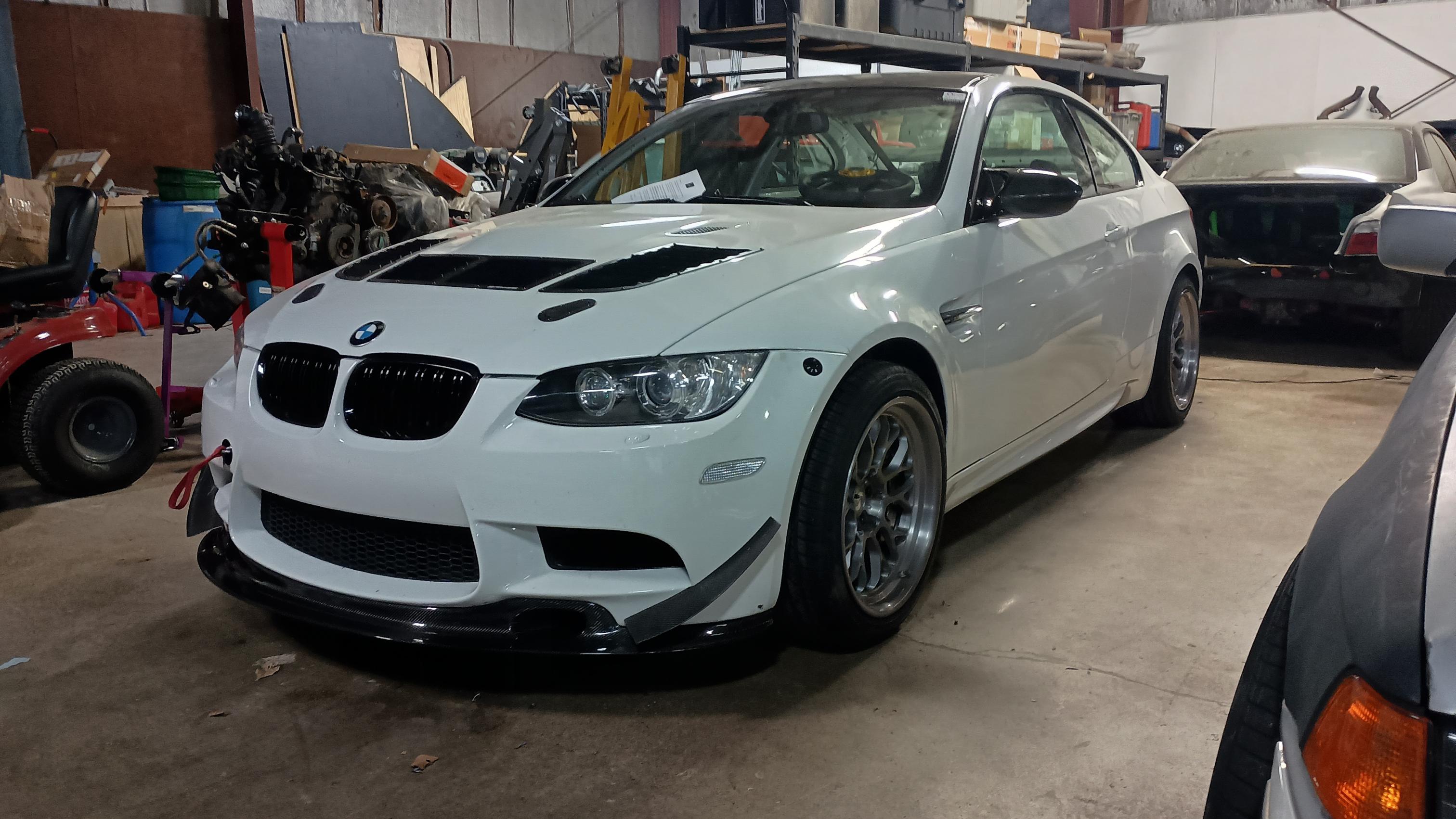

Finally done with the exterior of the car for the winter. New GT4 front lip, Quick Release tabs for the front bumper, and new (to me) Wing. Looks like its Ridgeline for the uprights and center piece with custom end plates. Very happy with how they turned out.
Car looks funny without the rear diffuser (gotta get the engine and exhaust back in first).
Last bit of work before engine and cage gets here to be done this weekend. Need to reinforce the trunk and put a new seat mount on the passanger side.

Ring spec wing? It looks great!
I thought you were going with an APR?
Thank you! I think it's a Ridgeline but bought it secondhand so not too sure. The APR was TOO much wing and the car didn't have enough front Aero to justify. Maybe down the road but this was too good of a deal to pass up.
Rubin
Rubin
Ah, that makes sense. Either way, the wing looks great, the extra width is really nice!

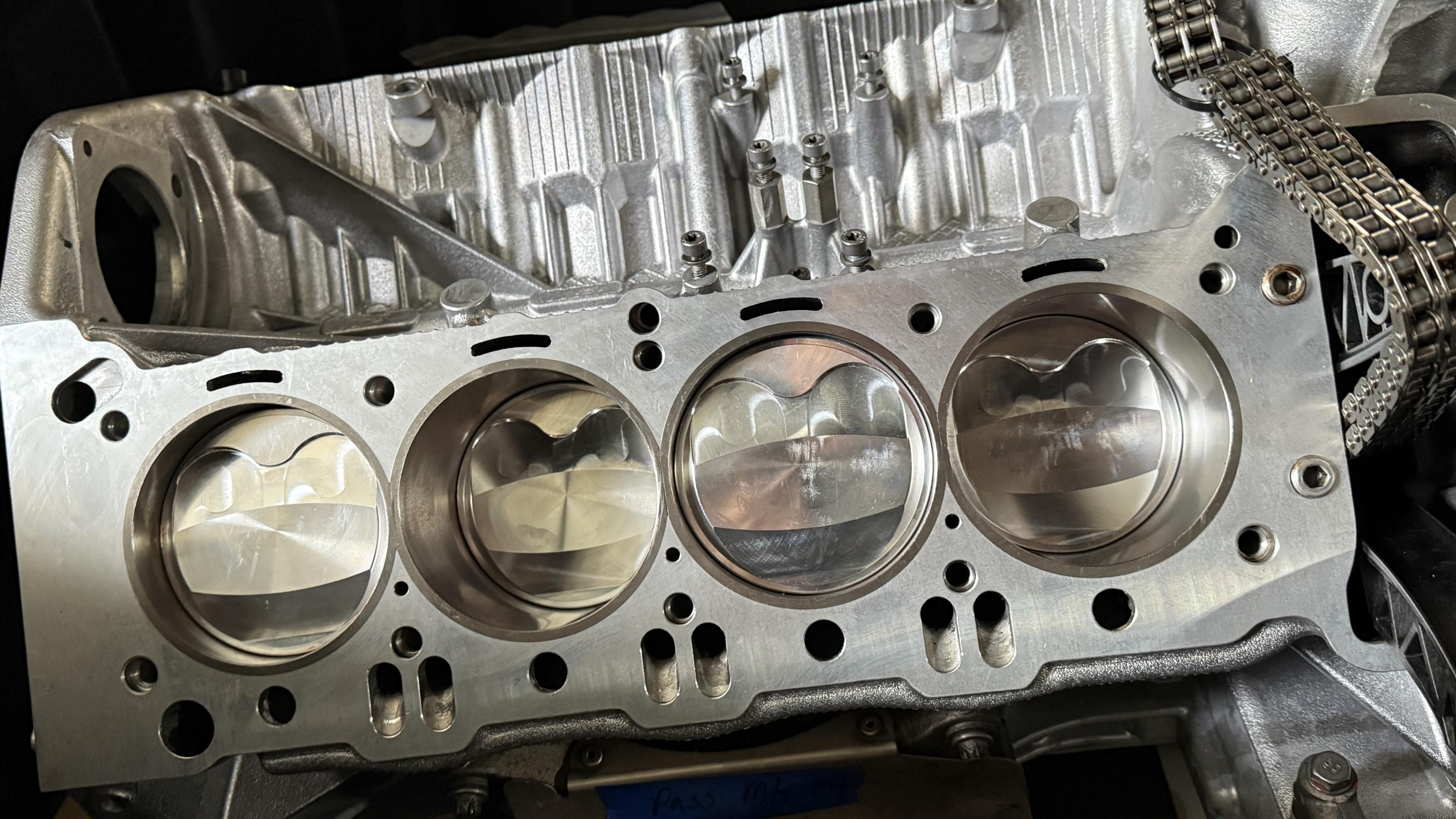

Rogue Engineering is making good progress on the short block. Pistion rings were gapped and filed down to spec, then the rods and pistons were slapped into the sleeved bores. New ARP bolts to compliment the ACL bearings. Just waiting on some remaining bedplate bolts and we should be ready to torque everything down to spec. Short block should be done next week and sent out to me here in Cincinnati to throw on accessories and heads.
I am getting super nervious/excited to get to this point, can't thank Ben and Josh at Rogue enough for all their help and expertise. Very cool I will have the first built S65 from Rogue in my car.
