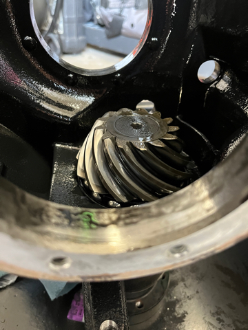

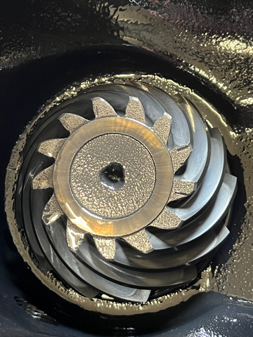

Originally Posted by ///Mobbin View Post
In case anyones curious what the factory vLSD looks like. Bunch of 16mm bolts securing the rear diff cover then pried it open with a large screwdriver.
Once everything is cleaned up, please post close up pics of pinion and ring gears so we can see wear on teeth. Mileage would be helpful as well.

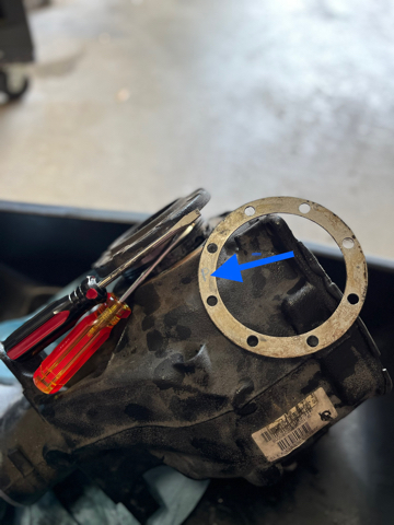

Side cover pries off with two screwdrivers, some light hammering on one of the screwdrivers helped get things started here, side cover came out pretty easy. Don't forget to label your shims driver/passenger as they are likely different widths on each side. You can also see the o-ring that will be replaced inset in the inner portion of the side cover.

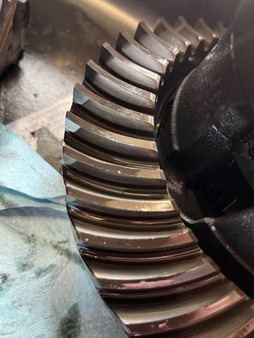

@admranger some wear on the ring and pinion, 90k miles, I think they still look good to run, what do you think?
Full send. No need for a float test. I'm looking for pitting, chipped, cracked, and severely uneven wear on the gears. I don't see anything like that.
