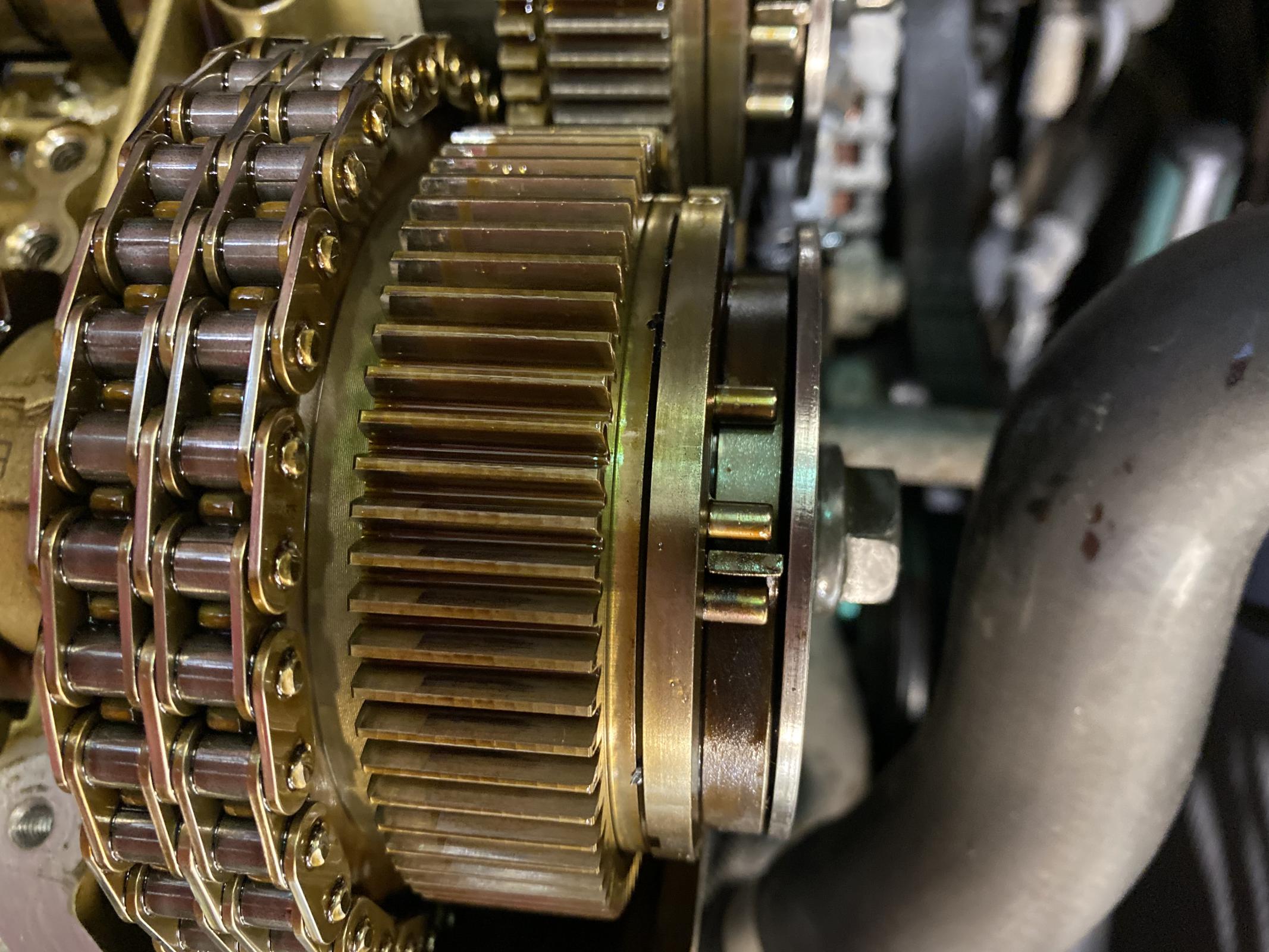

Here are some pics with the covers installed and pics without the covers just for everyone's reference

Anyone knows what is this cut hole doing here?

figured i would update this for anyone feeling lost with regards to the replacement of these plastic covers.
I was able to speak with Carbahn/Dinan and source their metal "covers".
Some photos are attached below.

So...their special "covers" are large stainless "washers", then.
Are they completely flat plates with a simple center bore, or do they have any pins/protrusions, of any kind, on the rear surface...?
Interested in what some of the s65 pro guys here have to say about this...
-Mark in St. Louis
Flat washers - interesting you own an S65 and haven't heard of Dinan before lol

I guess if the main job is just to keep the VANOS spring from unseating itself that would be a great cheap long term fix. But without seeing the underside of the washer it's hard to say if its completely flat or if there are any additional stuff under there.

for anyone that couldn't figure it out, yea, they're flat steal washers and i've had no issues with them
there is no instance where the plastic cap will retain the spring if the spring itself fails.

Are Carbahn still selling these?
You won’t find them posted on the website but I phoned and was able to acquire a set.
I mentioned they should post them as I knew of nearly 10 people that were looking for a set.
