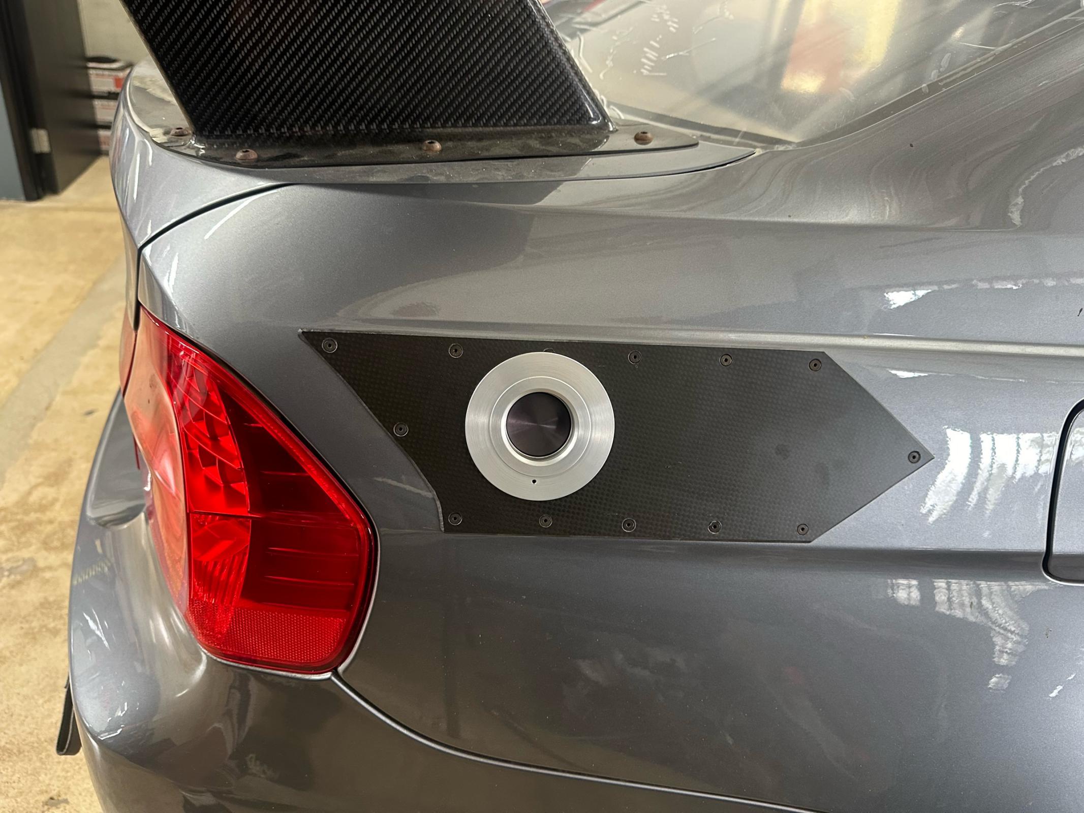

Update on body panels:
Doors are fully gutted and back on, as is the hood. Racing screen has been added to the front bumper and it's back on the car too. Making progress!
[IMG]https://lh3.googleusercontent.com/YT...799fRnbE=w2400[/IMG]
[IMG]https://lh3.googleusercontent.com/rs...D_Vi14aI=w2400[/IMG]
[IMG]https://lh3.googleusercontent.com/Wh...OdWd66i4=w2400[/IMG]

Custom fuel cell/bladder complete. 27 gallons. Dry break system in the rear quarter window panel will feed the tank. This is about as low as we could go without one of the FIA stock tank replacements, but those are silly $$.
[IMG]https://lh3.googleusercontent.com/2f...XOhgFJSs=w2400[/IMG]
[IMG]https://lh3.googleusercontent.com/8Y...vhefoGgY=w2400[/IMG]
http://s345.photobucket.com/user/alextcampbell/media/untitled_zpsnyjbqmoc.jpg

Fuel system and cell are complete and the sheet metal is reinforced for the dry break system.
We are ready for some dyno tuning likely later on this month to dial in a TT3/ST3 tune and a max HP track day tune.
