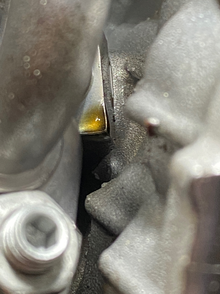

After several month without the friggin code...it turned up again. No code on the replaced aux water pump, cooling system seem to be running fine. This is a tricky one...

Do you recall the conditions and any notable behaviors when the warning popped up? I went on a pretty hard 8 hour total drive in 90f weather a while back and didn't have any issues besides the persistent o-ring weep that I've been tracking since February. I do have that recurring aux water pump code but it doesn't trigger any lights.
Hey man,
similar to others really i.e. typically at low speed (where I assumed water pump/coolant should help compensate for lack of air cooling). Did a 200 mile round trip/high way during the weekend without issues.
Missed your mentioned o-ring leakage, what sealing is this?

The o-ring sandwiched between the thermostat and the transmission body. Probably gone flat over time. I doubt it was swapped out at the last full transmission service at 88k miles.
Ah, got it. Had my Tstat replaced together with fluid and filters some year ago, and yes believe I had some weep there as well. Wouldn't worry if tiny.

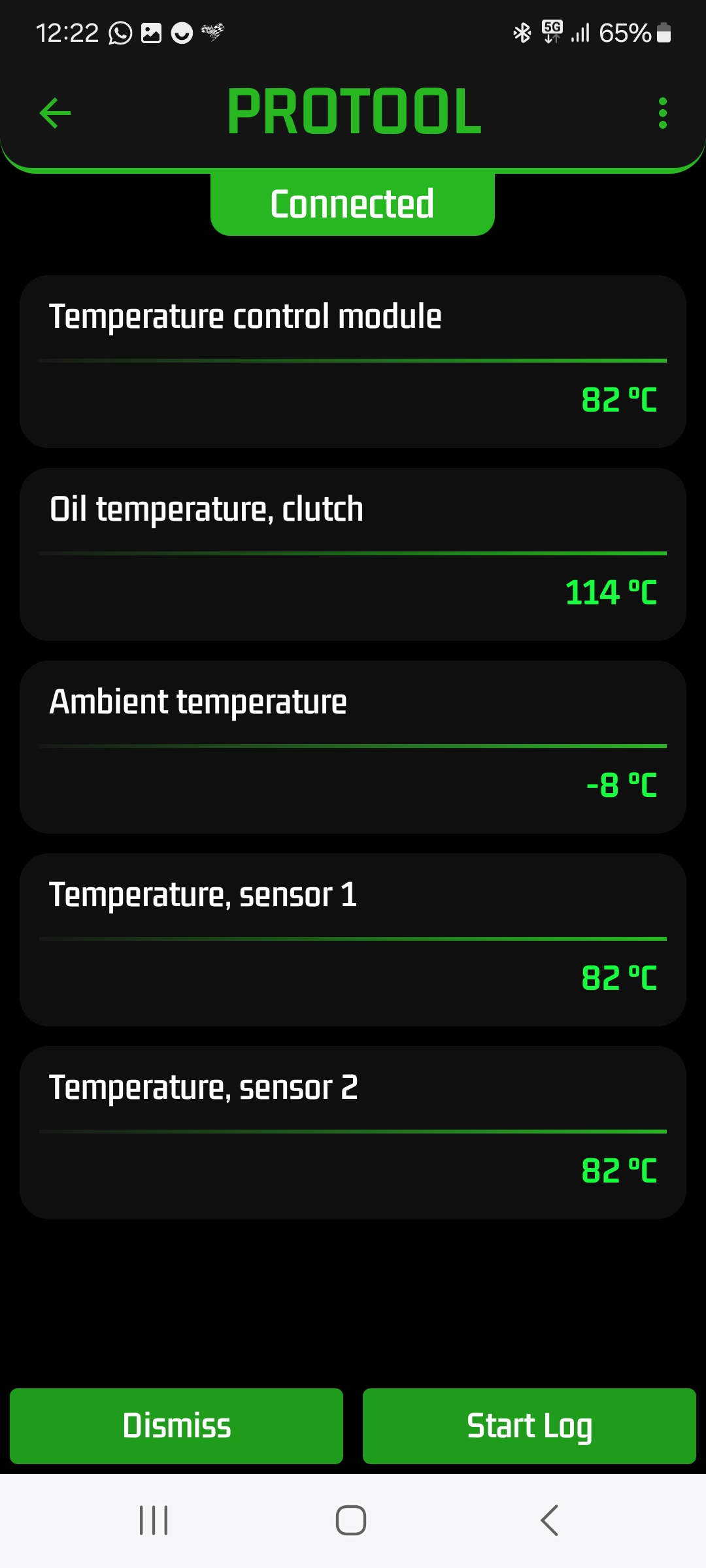

Replaced the rpm/temp sensor, seems successful. Before and after pictures below where one clearly see the clutch temp isn't aligned with the other DCT temp sensor. These 114C doesn't trig the code, but it coul jump up 150-180C when it did.
The rpm sensor are typically offset/higher with a few deg C prior everything is heated up. Guessing this has to do with that it is placed in the top of the box and get heated air rather than beind dipped in the fluid.
Anyway, first drive indicates its better than it has been for a long time, so far so good.

Sorry to update this post all this time later, but just wanted to share my thoughts as I recently had the same exact issue with my 2013 E92 M3 DCT 40K miles. Found this post super useful, especially testing via ProTool on the temps.
The warning came up three times in total before I started looking at it and seemed to get progressively worse and not intermittent like yours. When the warning does appear, it only happens after about 40 minutes of driving and when I'm in slow-moving traffic. It first happened when going into reverse and the gearbox became jerky. I immediately turned the car off and straight back on and the warning went away and did not appear again for another two weeks. Where the same happened and then it seemed to happen day after day with the same drive. Eventually it went from phase yellow, to phase red and then finally to phase black while I was trying to troubleshoot.
Reading the codes, it gave me three errors at the beginning: 5A58 - Spray-off sensor: electrical defect, A6D1 - Additional Water Pump and the Phase Yellow temp warning. Cleared the codes and never got 5A58 back.
Thankfully, I found this post and got ProTool to do some diagnosing. Checked for leaks, checked for anything blocking the dct cooler and luckily ProTool showed me the temp at idle for clutch oil was sat about 10-20 degrees c higher than all the other temps, and when I drove it somewhat hard and that difference would just become bigger as well as spiking randomly. At one point it hit over 200 degrees c.
I also got quite lucky with finding this blog post: https://www.munichpower.co.uk/bmw-an...rature-sensor/ where this specialist (Jim) actually had documented the issue and had proof of fixing this issue on multiple cars. He said 90% of the time its the temp sensor inside the gearbox. His shop was only 20-30mins from me so booked the car in. He swapped the temp sensor in a day as well as replacing the aux water pump and doing a dct service. Do note, the car already had a dct service less than 6 months ago, but since the gearbox was coming out, I thought why not.
Had the car back now a couple of weeks done the exact same drive multiple times that triggered it before and driven in 30+ degrees c weather in stop and start traffic and its been faultless. I have read the codes and even the A6D1 code is gone.
Since multiple of us who have had this issue also have had the A6D1 code first then get the dct temp sensor fault down the line. It is my belief that when the aux pump becomes faulty, it must somehow make the temp sensor inside the gearbox also become faulty. This explains why when the aux pump is replaced, it helps the issue but does not cure it as the damage is already done to the sensor. That is a complete guess though.
Anyways, I will bring this long-winded post to a close now, hopefully the next person also finds this useful and thank you again to everyone before me who investigated and wrote up their issue.
TLDR: If you have the issue get ProTool or BMW software to read the temps on the clutch oil and engine oil compare the difference at idle and under load. If there are unexplained differences, most likely the temp sensor and yes the gearbox has to come out to have this replaced.

Good thing that you got it sorted! Me? Fiddled around with trial diagnoses for bloody years before I eventually nailed it. Shame the various BMW shop didn't use Protool while I had warranty...tossers.
