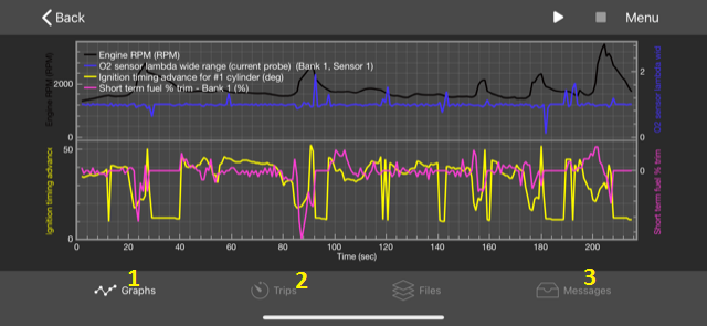

I was able to pull some data logs this morning. I think they show the problem pretty well.
In first photo you can see 3 successive pulls from 2000-3000 RPM. You can see the Lambda dip, then STFT shits the bed then they start chasing each other in gradually improving cycles.

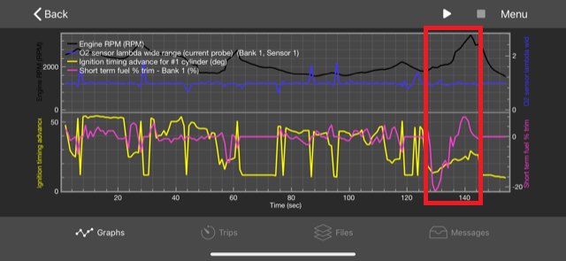

In the second photo, there are 3 pulls through the 2500-3000 rpm range. #1 & #2 replicate what is seen in the first photo. In # 3, a normal pull in the same range, STFT increases contrary to the problem pulls.

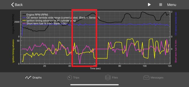

In the 3rd photo, this is a severe example where the RPM really hung due to the problem, with a couple more less severe pulls.

In my opinion you can see a X-Pipe scavenging effect and the software doesn´t fit to this.
As in the first post stated adaptions may help but the ecu can just adapt in specific ranges.
I think this effect here can be reduced with proper vanos mapping in this range.
