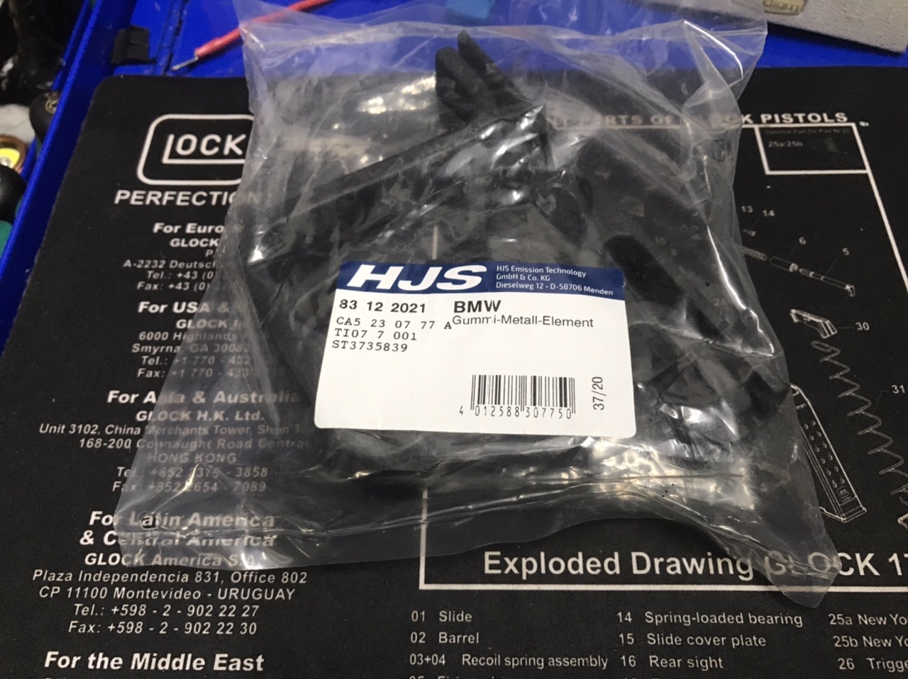

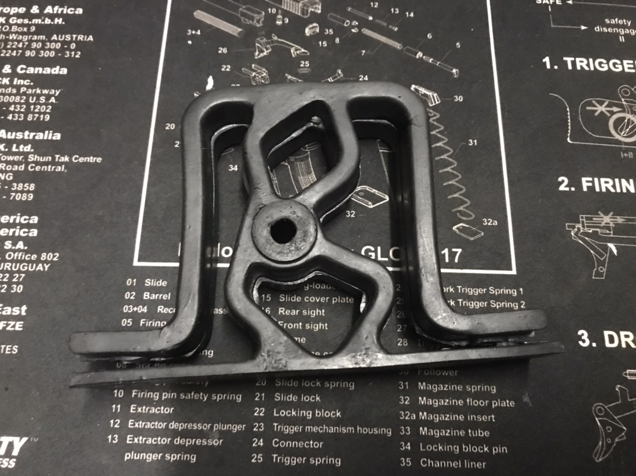

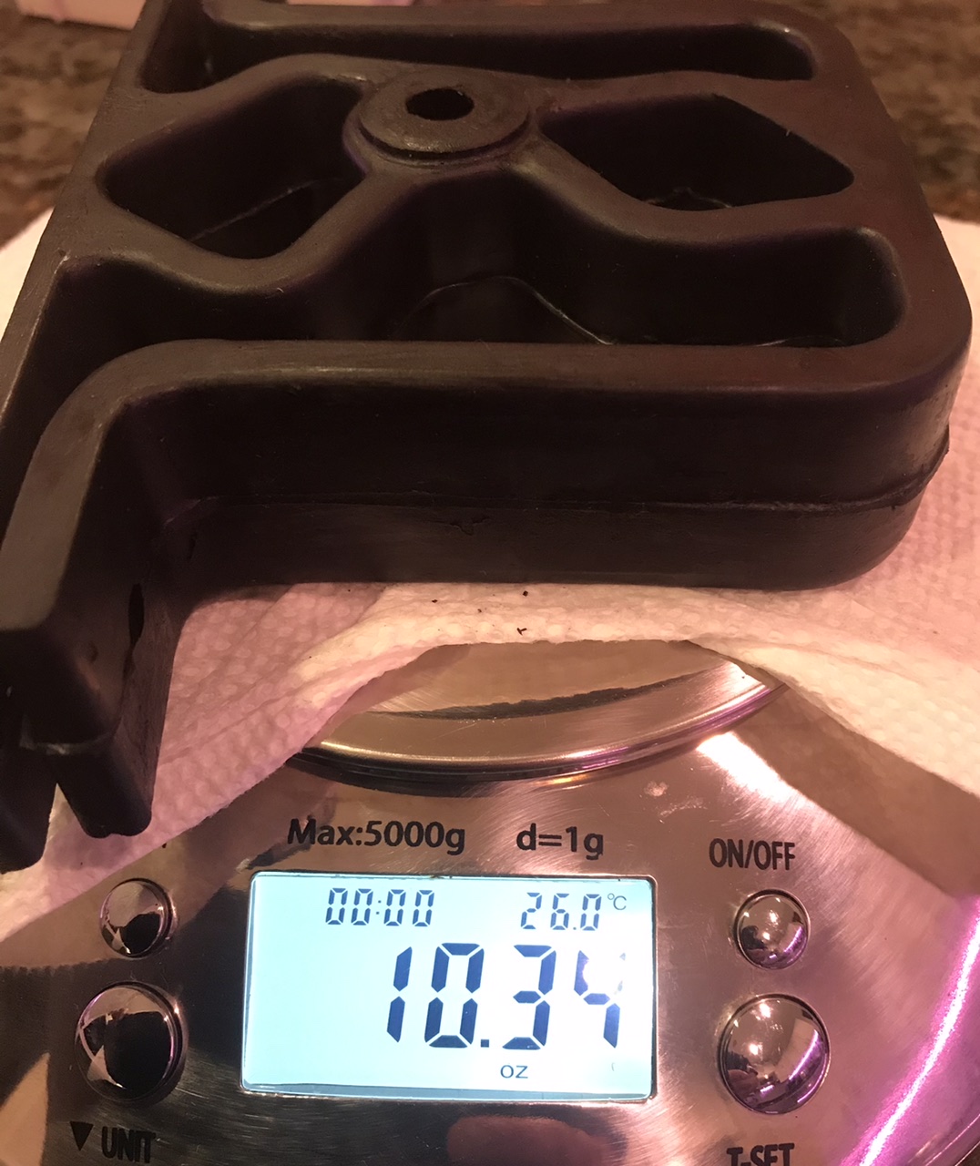

I went with the HJS hangers for $15 x 2 that weigh just over 10.3 ounces. With the weight the akrapovic exhaust, I could probably get away with a shoelace. Here are a few pics and the part number.
