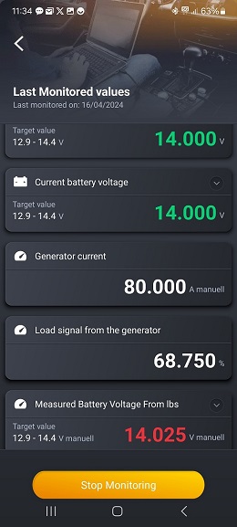

      04-16-2024, 10:25 AM   #32
Helmsman
Helmsman's Avatar
Sweden
5484
7,657
Drives: 2011 AW E90 M3 ZCP
Join Date: Mar 2014
Location: Stockholm, Sweden
Mine has been fine aside from the initial period of low voltage. Consistent 13.8-13.9V while driving now. Like u said, I think the new battery registration does more than we realize.
Meeting again on good old subjects Eric....
Replaced my battery (to a 95Ah AGM from an 80Ah acid that went crap in less than 2y...).
Measuring with Carly (an area where Protool do nothing) turns out that the alternator turns down the voltage output and subsequently the current. Not below 12V as in your case but 12.1-12.3, assumingly where a new battery would be with some load without alternator support. It seems to vary the output so occassionaly well over 14V to suddently drop again.
Previous battery always run with a good 14-14.6V.
Found some BMW pwr mgmt stuff that state that the various consumers should use the alternator output as long as possible, to only when not enought start to consume from the battery. Seems the other way around in your and mine case...always something going on with these cars...
So how did it continue in your case, voltage gradually came up and all fine?
Did you test the alternator yourself or handed it in?
Thanks
Nik
Ps. Adding mentioned desciption.
      04-17-2024, 06:44 AM   #33
Helmsman
Helmsman's Avatar
Sweden
5484
7,657
Join Date: Mar 2014
Measuring with Carly (an area where Protool do nothing) turns out that the alternator turns down the current output and subsequently the voltage. Not below 12V as in your case but 12.2-12.3, assumingly where a new battery would be with some load without alternator support. It seems to vary the output so occassionaly well over 14V to suddently drop again.
Thanks
Nik
Thought worth an update for the next guy.
Here I am thinking I understand simple pwr mgmt systems...while as usual Redd is right.
Logging some more data (using Carly) it does seems like the battery is feeding everything till a certain point when the alternator is switched on. For instance turning on the fan (big consumer, like 30 amps) the alternator is switched on.
Never seen this with previous two battery replacement but seems to be the case. It is strange in my mind that the battery is allowed down to by Redd mentioned 70% or so before being supported by the alternator, as close to full maintain life time better. Also strange that the alternator seemingly haven't shut off after external/trickle charger been on. Learning stuff after 10y with this car!
Means that the BMW doc I posted above stating "The alternator is designed to supply current to all electrical loads and charge the battery.
If the alternator is not able to supply sufficient current to the electrical loads the additional current requirement is taken from the battery", doesn't seem to apply to our cars.

When I start the car for the return trip, everything initially seems fine, with the voltage at 14.8V. However, as soon as I start driving, the voltage drops to 12-12.5V whenever I accelerate. When I coast or come to a standstill, the voltage rises back to around 14-14.5V.
If I turn the fan on full while driving, the voltage increases to around 13.5V. During steady motorway driving with cruise control and no traffic, the car seems to be running mostly on 12-12.5V, drawing directly from the battery rather than the alternator. Once I get home and restart the car, the voltage is back to normal at around 14.5V without any issues.
Could this be another faulty alternator, or is the car’s smart charging system causing this behavior since the new battery was registered? It’s strange that this only happens on the evening journey! Also last night I have another error message on the idrive Increased Battery Discharge, would this all be related ?
Scanned car, with Bimmerlink only error I can see is Glow Plug Module which I had replaced 4 years ago but the symptom was a rough idling so I don’t think it will be the Module causing all this specially in the evening only as the temputure is warmer the Glow Plug wouldn’t be cornering ?
But this morning i noticed it was doing the same thing as the evening drive so i think it is tempeture related as this morning was warmer weather. It started to rain today and i put the wipers on and the voltage shot up to 14volt solid, this makes me think its not the alternator as it is reacting to the needs.
i wonder is it the same as what you had at the start, have a done a bit of digging, it might be Brake Energy Regeneration disengaging the alternator because battery is near full?
P.s sorry to bring up such an old post again lol

The BMW power management system is pretty complex and does some weird things, especially right after new batt registration. Keep monitoring but give it a few months and see if voltage stabilizes after that. As long as it doesn't leave you stranded with a flat batt I wouldn't worry too much about it.

Originally Posted by dnbtse View Post
Hi,
I’m experiencing a strange voltage issue with my BMW E91 330D N75. Last month, I had a charging fault appear on iDrive. Mechanic diagnosed the issue as a faulty alternator, which was then replaced. However, after the replacement, I noticed a strange problem: the voltage would drop to 11.5 volts when the heating was on full blast in the morning but would slowly recover after turning the fans off. Sometimes it stay stuck the voltage stays at low voltage.
I then replaced the battery with one of the same specifications and registered it using Bimmerlink, but the problem persisted. The garage agreed to replace the alternator again after I demonstrated the voltage drop issue. With the new alternator, the initial fault was resolved, but I’ve encountered a new, problem.
For the past five days, I’ve been monitoring the car’s voltage during my daily work commute. Here’s what happens:
• Morning Journey:
When I start the car, with the windscreen heater and heated seats on, the voltage reads around 15.1V. After a 10-20 minute drive, it stabilises at 14.6-14.9V and usually sits around 14.8V. This seems normal, though 15.1V feels slightly high.
• Evening Journey (Issue):
As Redd says, the system behave a bit weird/clever, from what I read things seems ok in your case with a new battery. As discussed earlier in the thread charging is disabled when battery is judged 75-80% full. At start it gets on it but again if ok filled up the voltage/charging is reduced.
Temperature is also a factor that makes a difference where I measured higher charge voltage when cold, as it should as the battery then needs it to accept charge.
