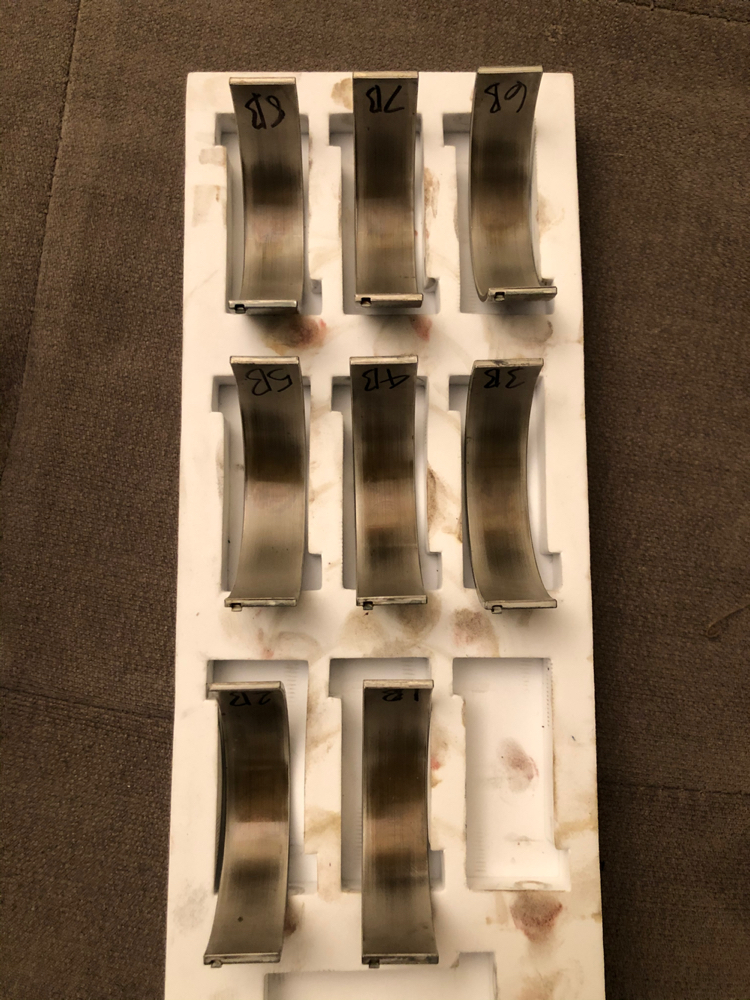

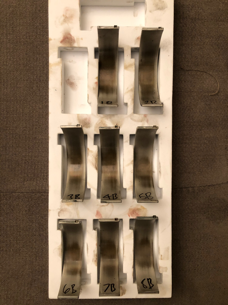

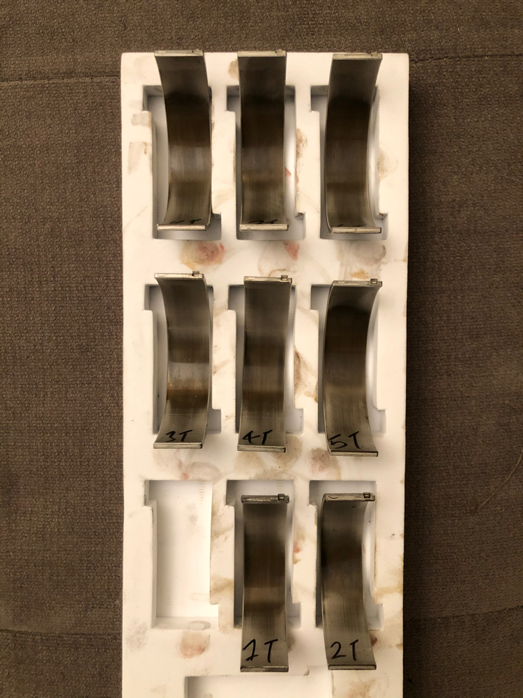

Were my rod bearings ok?
My PPI several months ago states "minor" metal shavings found in the oil filter. Long story short, changed the RB's and the shop suspected they were most likely the source of the shavings. I'm far from an expert, but these look nowhere near as bad as some that legitimately needed a change. Am I wrong?
2011 E92, 78k Miles.

Your wrong... those RB are bad... the newer bearing don’t have the copper in them like the older ones, so they don’t have the colour contrast.
They are not imitate failure bad ... but you where well on the way.

They’re not great. In a motor without known rod bearing issues, you can pull them apart at 300k miles and you wouldn’t be able to tell they were ever used. Yours were clearly having some contact with the crank, which ideally is something that should never happen.
They would have resulted in engine failure eventually. What’s harder to say is how long that would have taken.
