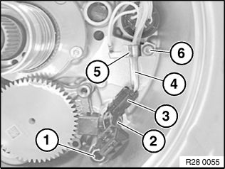

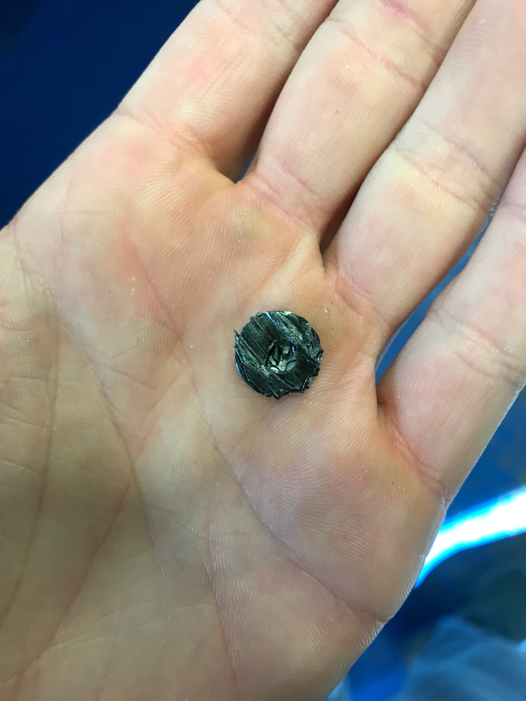

So i had the transmission out and inspected. There was a broken bolt that was found. Not sure exactly where it was but the shop is strongly confident that this broken bolt inside the dct was causing the bang off a stop. Mounts were in good shape.

I have found the cause to this problem....
This is due to a internal component failure. I've in fact removed 3 different DCT's and found this issue. If your able to catch it in time the mechatronic wont get permanently damaged. There is a way to test for this condition and further steps can be taken to permanently fix the failure from happening.
I'm glad i was able to find this post. I was the Tech that removed the DCT and Inspected the internal components and found the broken bolt. I've been doing a lot of digging into this issue and found the cause and affect. I will be removing the DCT out of my personal M3 and recording step by step on how to prevent this from happening. I believe that ALL the DCT transmission should be checked for this condition before the major bolt failure.
Wow!
Meanwhile, can you tell us where & why the bolt fails? Until then, I will continue to come to a complete stop & count to 3 when going from R to D & D to R. When parking the car my foot will stay on the brake while I pull the parking brake. I will say many prayers too.

Update: I had the broken bolt replaced and put the trans back on the car. I start her up and give it a shot to see if the bang/jump was fixed. Unfortunately, the bang was back. At this point, i was over it and lost interest in trying to fix it. Drove my way to BMW and picked up a new f80 comp. Absolutely love it but i also plan on owning another e92 down the road.

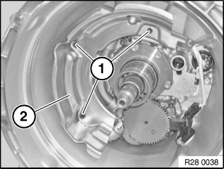

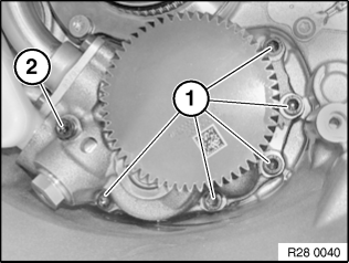

EdGomez11 is the bolt that causes issues in any of these pictures?

Just to confirm, you have tried:
Replacing the mechatronic (fully, or rebuild/refurbished)?
Replacing the clutch pack (basket as well? or only the plates?)
Addressing the stripped/broken bolt.
And a general adaptations reset + oil service for the tranny.
None of these helped
I did all of the above^
It drove me crazy to the point where i was going to buy a new dct and have bmw put it in but had the it h for an f80. Still wish i had the v8 though
