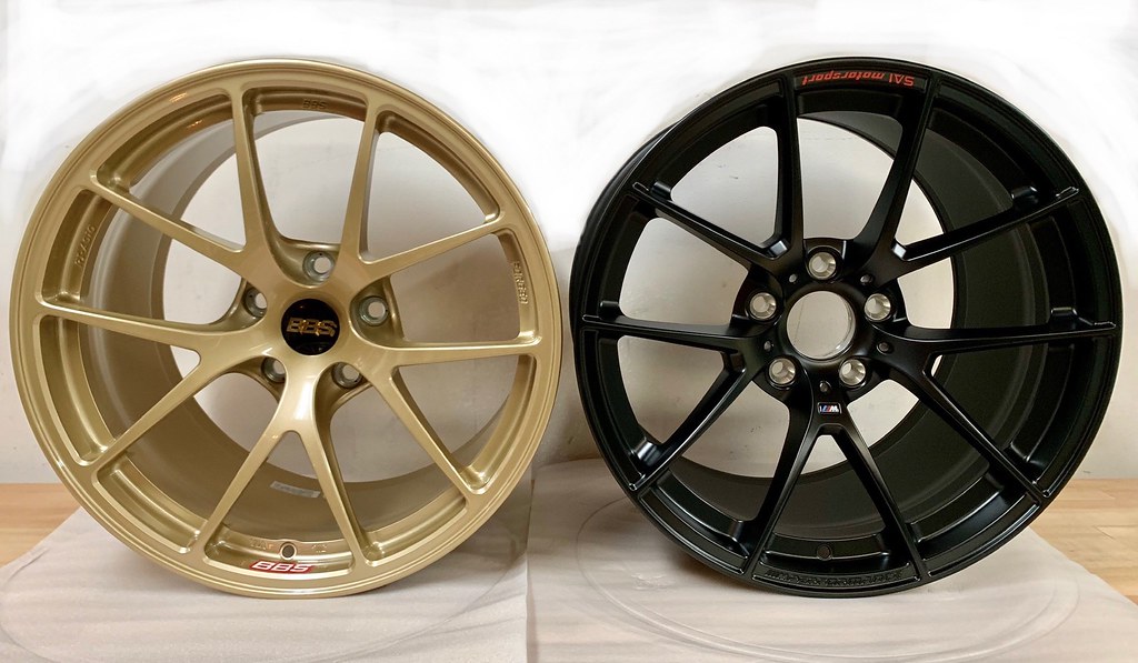

The RIA versus the GT4 wheel is an interesting comparison. I happen to have both on hand right now. The GT4 wheel is surprisingly light, great bang for buck. BBS RIA build quality is better. It simply has more details to the design, it's forged, and about 1/2 lb lighter. EDIT - I believe that both wheels are forged based on my research on the manufacturer of the GT4 wheels
Fitting 10.5 on the front is not all that difficult. Fitting an 11 on the front is possible but does require a specific setup. I don't think -4 camber is required based on my testing. I'm at -3.3 and believe I can fit an 11" wheel in front with my camber and 295's.
Pic of the two wheels side by side for comparison >>>>
RIA vs GT4 by slicerM, on Flickr
really appreciate you chiming in, I been googling both wheels comparing both(your posts come up BTW ), I did not know the GT4 wheel was not forged. So for around $1k more, the RI-A is the clear choice to go with.
So what size of spacer would be needed to clear the stock calipers on an M3/M4 with on the GT4 wheel? No one seems to be able to post an exact size.. everyone just says 25 mm. If it is 25 mm one would be at +5 effective offset and with a 11 inch rim, that is pretty aggressive... if this is the case, to gain half an inch of wheel size isn't worth it so again, the BBS wheel would be the clear choice.
and the RIA Is being discontinued.. so I was told.. is this accurate? Appreciate all the info Slicer.
You are welcome - happy to help when I can. It's not the caliper that's the issue. It's the suspension. Based on my research I believe only a 12mm spacer is needed with a 295. However I will know more after I do some testing. I will test on my e92. The e92 and the f8x have very similar front fitment / space.
You are welcome. The RIA is not being discontinued as far as I know.

Originally Posted by dparm View Post
Brake clearance looks better on the BBS wheels, but that's just me eyeballing it.
Curious who is making these for BMW. Could it be someone like BBS, or is it one of the other OEM suppliers like Ronal, Wolf, Speedline, etc?
SAI - SuperAlloy Engineering makes these wheels for BMW. Upon researching the company I believe they only make forged wheels (therefore these are forged). SAI makes forged wheels and forged suspension parts for OEM's like BMW, Audi, Porsche, Mercedes, and Ferrari. It is a Tiawanese company.
http://superalloyengineering.com/company/profile/

Post up a link??
I’ve been curious about them. The cost savings isn’t a ton, but it’s always interesting to see and hear about new stuff...
Are you a member of this group?
https://www.facebook.com/groups/680392535693234/
Louis Gigliotti bought a container full of them and has been posting a lot of great feedback and data on laptimes from his race cars.
