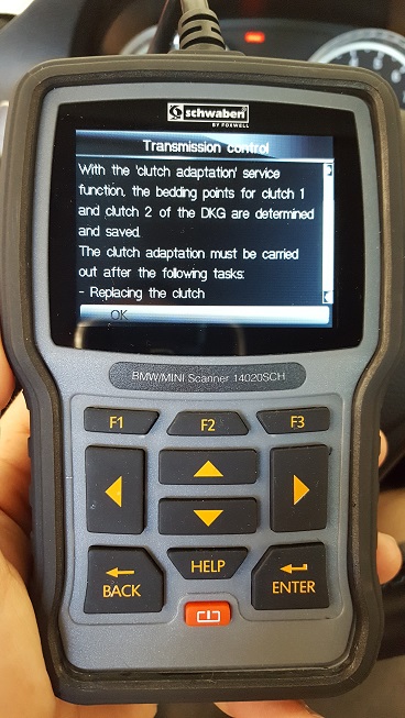

Originally Posted by spr View Post
Anywhere in sd other than dealer?
I've used the Schwaben BMW scanner to perform the clutch adaption routine. My clutches were not slipping. I just did it as general maintenance.
https://www.ecstuning.com/b-schwaben...020sch01a~scf/
The Schwaben scanner will do a lot of other stuff for your M3 like read and clear codes. It's made by Foxwell. I spent $60 on Foxwell's website to get the GM config pack so I can use the scanner on my wife's Chevy Traverse.

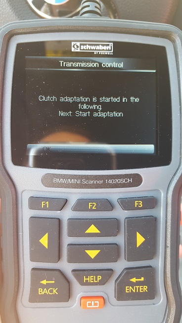

burnrbr
99
318
Drives: 2022 M3 Comp xDrive
Join Date: Jul 2015
Location: Jacksonville, FL
The shwaban and my ess software/ other tunes just reset how the transmission adapts to your driving, e.g. how soft or hard it shifts. The other actually uses a bmw computer with icon most cable which checks the thicknesses of the clutches and adjusts the entire transmissions spec to the current thickness. This gets rid of slip. It theres slup after that you need new clutches. The former just makes it shift differently based on if you've been driving it like grandma and the dct adjusted to your laziness.

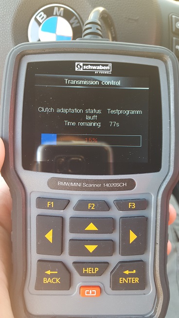

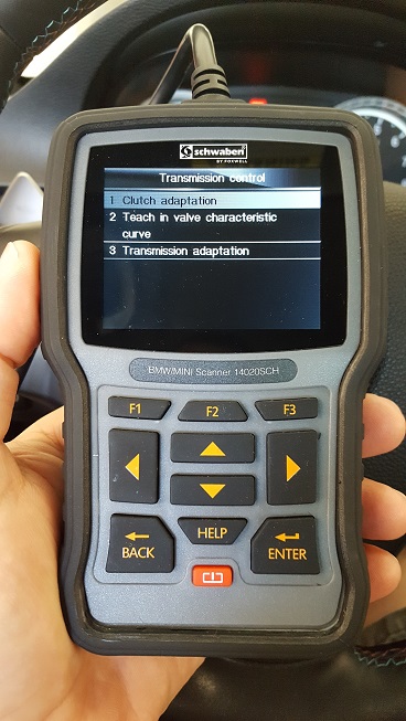

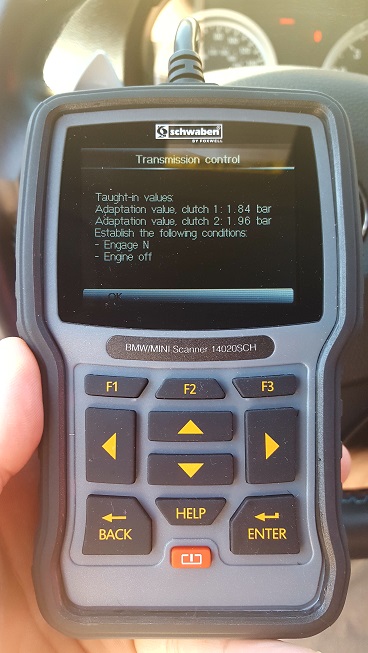

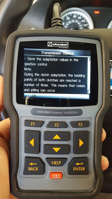

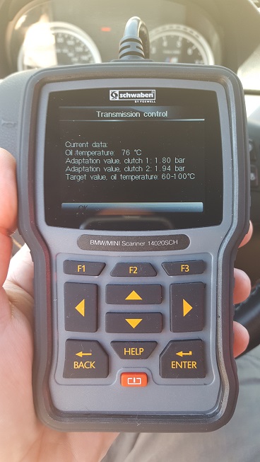

The Schwaben scanner does, in fact, perform the clutch adaption routine which teaches the TCU the thickness of both clutches. Checkout the pictures below of the scanner screens as I went through the process today. Unlike uploading a DCT tune, the car has to be running with the transmission temperature between 60 - 100 degrees Celsius, in neutral, and with the brake engaged. The car would rock/shake a bit as the DCT was engaging and measuring the clutches during the procedure.
Personally, I run the clutch adaption routine every 15K - 20K miles so that the DCT can optimally use the current state of the clutches. Having driven a manual for 19 years, I would alter my use of the clutch pedal based on the current thickness of the clutch. Thinner DCT clutches without proper calibration naturally leads to more power being applied before the optimum contact and friction point during a gear shift or launch. It's like giving it too much gas before the clutch starts to engage which can lead to either advanced clutch wear or too much slip. This, of course, is only during gear changes. The fact that the DCT can vary the line pressures based on clutch thickness can help with holding power while in gear. Please look at the before and after clutch adaption pressures in the pictures. They went up after the adaption routine.
I am not stating that running the clutch adaption routine will fix your slipping clutches. I am stating that you can run the clutch adaption routine by yourself with the Schawaben scanner and not need an indie or dealer.
Patrón560.00

Location: Massachusetts
2014 BMW M5  [0.00]
Attachment 1598889
Attachment 1598888
Attachment 1598887
Attachment 1598886
Attachment 1598885
Attachment 1598884
Attachment 1598883
Attachment 1598882
I have the schwaben and can back up your claim that it does the clutch bed point adjustment. However, if your DCT clutches are at the point they are slipping, they are already toast. This may bandaid the problem, but full clutch pack replacement will be required very soon.
