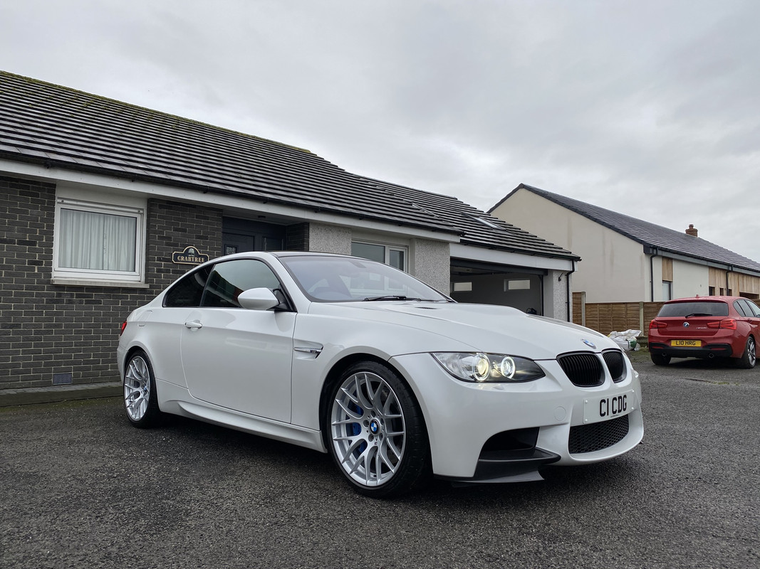

Thread bump, hoping someone can help me out a bit here.
I’ve had my e92 competition for a couple of months now, and it drives perfectly.
However I have a suspicion that the previous owner has tinkered about with the suspension at some point, perhaps for track or for his own driving style, this is coupled by the fact that it came fitted with 275/30/19 rear tyres.
As I say, I’m happy with the drive, just not so much with how it looks. Here’s a pic to show what I mean.

What's the question?
