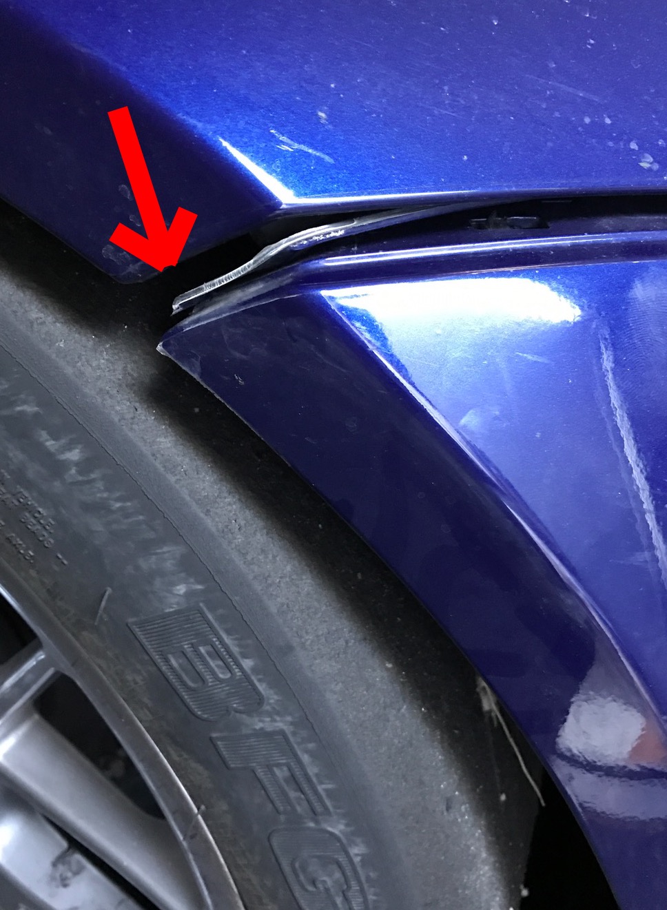

Originally Posted by warp10 View Post
Why the fender latches?
The bumper was pulling away from the fender due to the downforce. At Auto Club Speedway in 2016, the bumper pulled that flat metal hanger between the bumper and fender so far down that the sharp tip of the hanger was poking into the edge of the tire and grinding it like a cheese grater. Yuck. So we took all that stuff out and put the latches in. Problem solved. I drove at Auto Club this weekend and last weekend going 156mph (GPS) on the Oval and no issues.
Any pics of what you did. Does it make it easier to take bumper off?

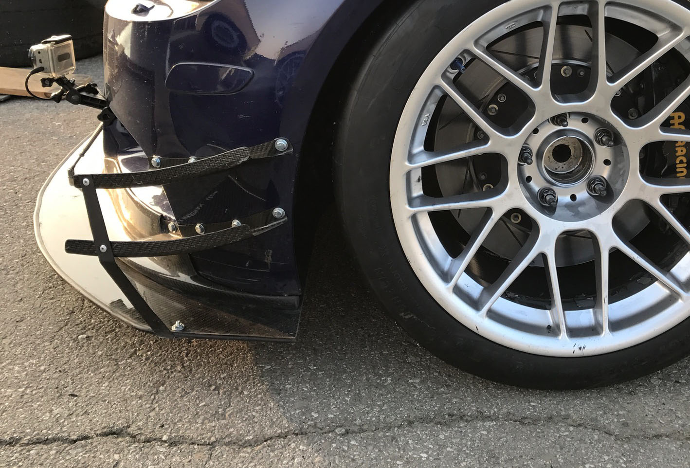

I don't have any in-process pix of the project. But here is the beginnings of that metal hanger being pulled away. That tip on the left just kept getting pulled lower and lower. At Auto Club, with the high speeds and the long banked Oval super-compressing the wheel into the wheel well, the tip of the hanger was able to touch the edge of the 285 R1S tire and grind it. I discovered it before the grinding was too much. (A narrower tire was able to sneak below it without touching.)
The latch basically removed some metal pieces on the inside of the fender and bumper. There's more room under there as a result. I'm very happy with the results.
I haven't removed the bumper since the latches went on, but since it removed some connecting pieces, I have to imagine these latches are easier to deal with.
Racewerkz Engineering installed the latches. I suggest contacting them if you have specific questions because I just don't have the answers...I'm a total end-user on this one.

I wanted to give an update on some suspension tuning I've been doing over the last number of months.
The whole process started as a result of bracing straps I had installed on the canards to stiffen them up. I've mentioned before that I was concerned that the canards were pretty flexible and perhaps could benefit from being stiffened up. The straps are a thin inconel brace that attach to the splitter.
The original design had the strap going to the underside of the splitter and being held via a screw. There was a bolt head that sat on the underside of the splitter to screw the strap into the splitter. (see pic)
The brace worked very nicely and the canards are nice and solid. However, a new issue cropped up: The head of the bolt holding the strap in place was getting sheared off because it was rubbing the ground in turns.
The question was: is the car leaning too much? And should we put in stiffer springs?
I had been wanting to experiment with stiffer springs for quite awhile. I wondered if I could benefit from less nose dive during braking, less squatting on acceleration, less leaning on long fast corners, quicker weight transition on quick back-and-forth turns, etc. The idea of stiffer springs seemed like something worth trying.
I talked to Bryan at JRZ to see if the RS Pro dampers could handle more spring rate. He said they could. He recommended going up 25%. 600front/800rear was on the car, so I purchased 750/1000. When I asked him if I should try it, his answer was very noncommittal. He basically said, "springs are cheap. There's no harm in trying." (Back in 2012, when I first bought the JRZ, he said that stiff springs on race cars was a myth.)
Let me tell you----I hated the stiffer springs. The car's ability to turn was severely reduced. The car was just SCRAPING across the ground in corners compared to the softer springs. It just WOULD NOT hold. And it became really edgy. I experimented with suspension settings quite a bit. I could reduce the edginess but then the suspension felt floaty and disconnected and still didn't turn as well. And it would bounce off berms instead of absorbing them. ugh....it was a disaster. I lost around 8 mph at the apex of Riverside at Buttonwillow.
I tried re-aligning and softening the front sway bar. Nope. No better.
Two days on track with the 750/1000 setup and I was done.
However, instead of changing springs at the shop, we decided to do it at the track. So, the next track day, I drove the first session with 750/1000---hated it, and then we put just the 600 back on the front for session 2. Holy cow, my turn in was back! Crazy! I was glad I could do back-to-back sessions with the different front springs. It really highlighted the change in feel.
And the car felt pretty good with the 1000 lbs still in back. So I drove it for awhile like that. I drove my 1:48.07 at Buttonwillow with 600/1000.
But I still felt that the rear had too much spring. So, I bought 900lbs for the rear.
I really like the 600/900 lbs combo on my car that weighs 3250lbs (no fuel, no driver). The car feels great. Turn-in grip and grip throughout the turn is solid. My suspension settings are back to more "normal" settings in the middle of the damper range, so the connected feel is back. The rear feels responsive but not overly edgy. I'm happy to have a little more rate on the rear of the car than before.
I'm glad I went through this exercise. Now I don't wonder about stiffer springs anymore. I honestly don't know why people setup race cars with super stiff springs....
And now the canard straps have been re-made to sit on top of the splitter, instead of going to the underside. I believe the 900 lbs springs give the car a bit more support, so the head of the bolt doesn't seem to rub the ground as much. I'm wondering if we can attach them without even having anything on the underside. I asked about riveting, but that didn't seem to be the answer. We'll see.
