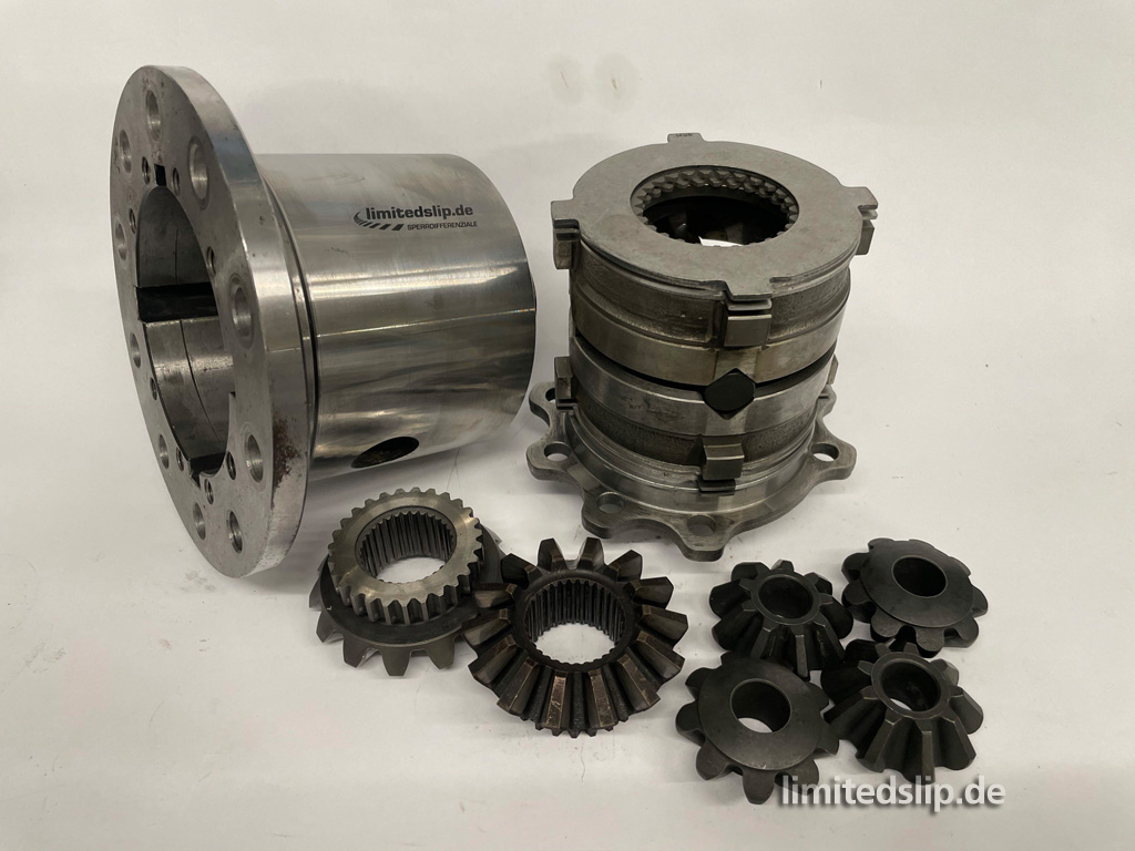

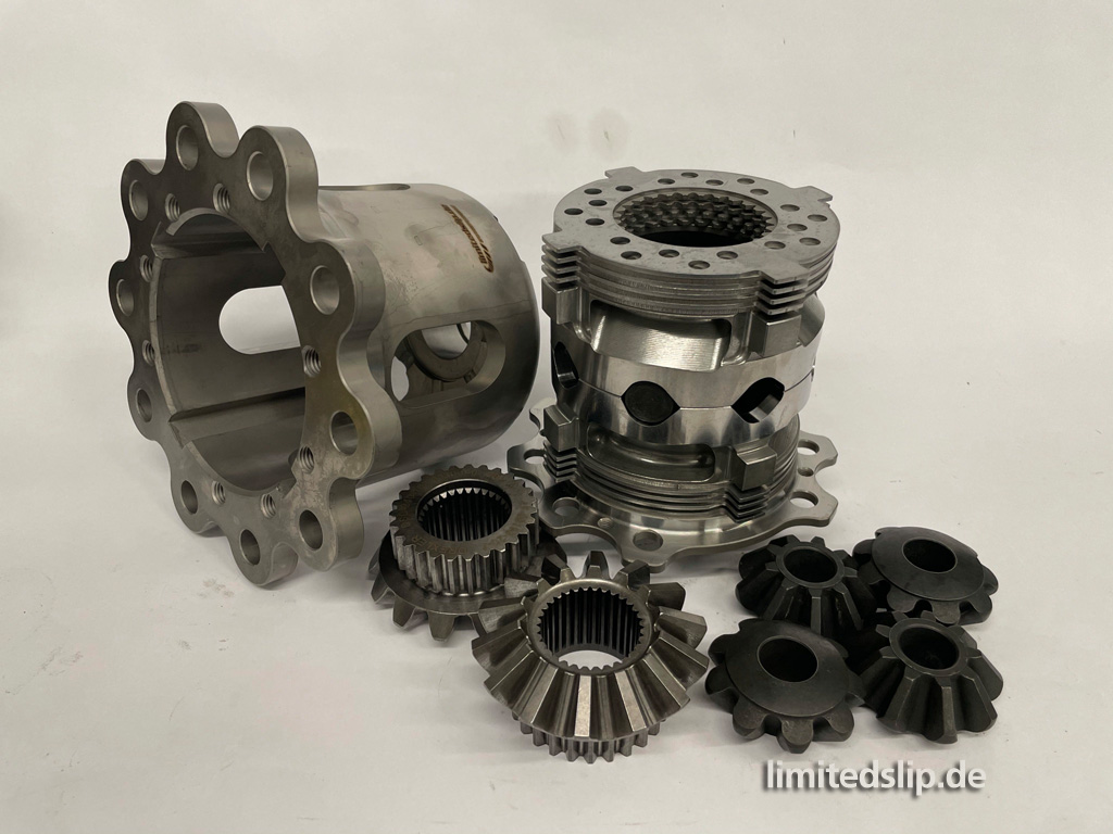

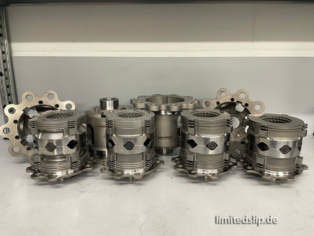

to keep this thread alive with quality content, here is a comparison of the various hardware setups i offer for e92 m3:
from left to right:
- drexler gt race light
- drexler gt race
- drexler performance
- drexler street
and a closer look to the first "gt race light" (high end, most expensive):
and the low budget alternative. a zf based lsd with modified lockup of 45% . this can be built with an old zf 25% lsd core where i offer perfectly fitting sets of new drexler internals to rebuild to a fresh 45% setup. this will perform very close to the drexler street setup:
and a little warning: i just saw in another thread here that a lsd core was built by some unexperienced guys that did not understand the direction of the power and coast ramps. this poor customer got a setup that is the exact opposite of what he bought/expected (plus the parts itself that were used there will not perform as expected either).
this is basic knowledge and i would call setting up lsd cores as "diy-stuff".
if many shops (i get such ill-working units on a regular basis to get them fixed) even fail to do this correct, the ball bearings setup is a completely different level... and the reason i encourage everybody to have this only done at very experienced shops!

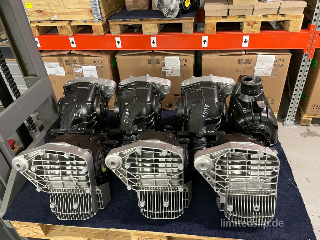

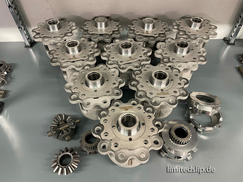

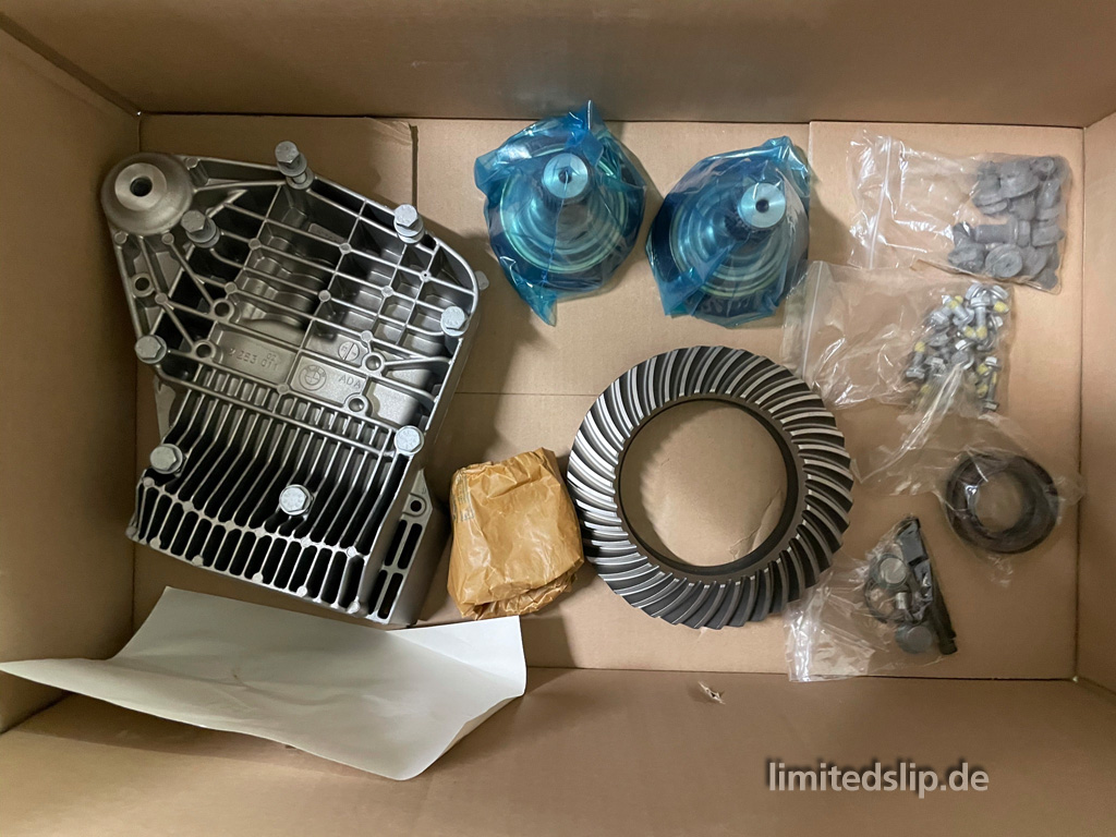

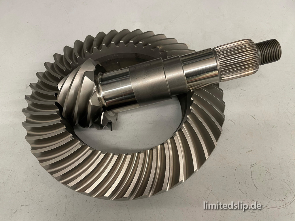

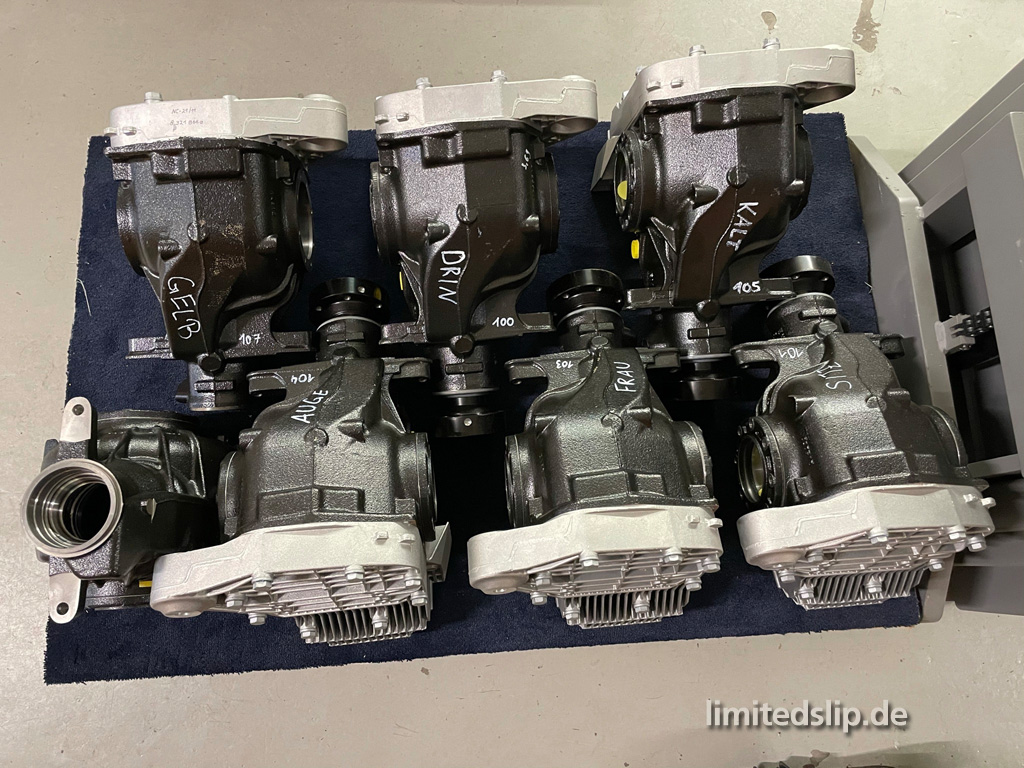

this month i also filled my stock with brandnew bmw ms e92 m3 gt4 pumpkins and according new bmw ms gearsets and drexler lsds:

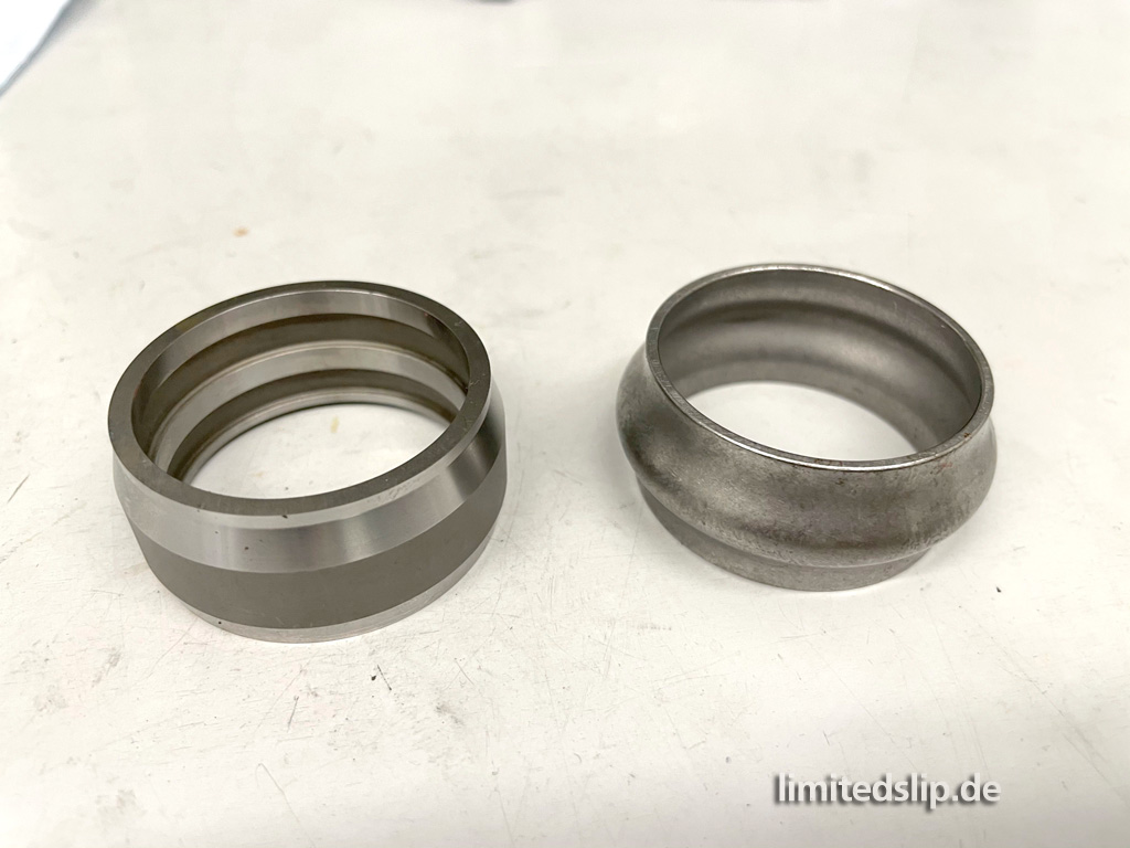

nope! you can use the drexler gt4 lsd core in any e92 pumpkin (if built correctly depending on flanges used, see below)!
the gt4 case itself is identical to the normal ones.
differences are:
- solid sleeve instead of crush sleeve for the pinion (if installed correctly, less stress on the ball bearings... but much more complicated to install properly)
- side flanges are screwed instead of just clipped in (so if you want to use gt4 side flanges i need to put the according nuts in the axle bevel gears of the drexler lsd... this means these gt4 flanges can only be used with a drexler lsd with nuts installed... but the drexler lsd can be used with any diff-version, if built without the nut).

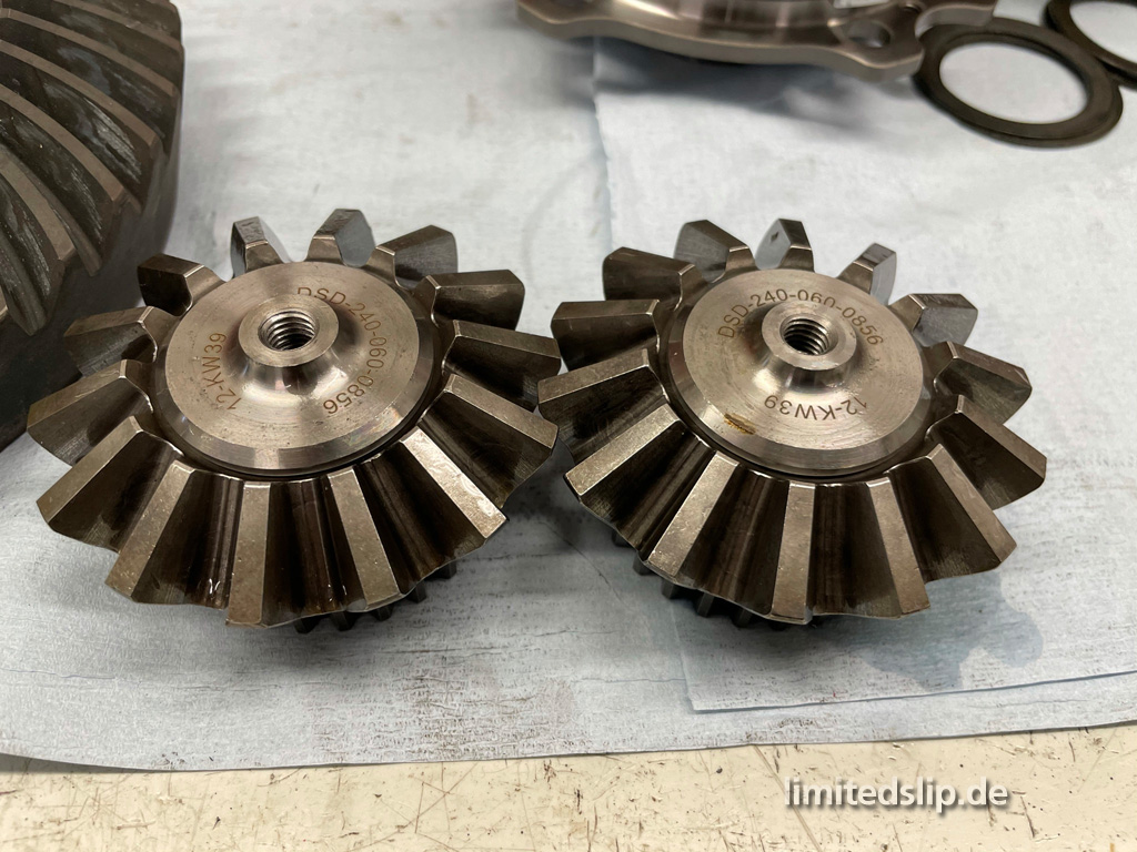

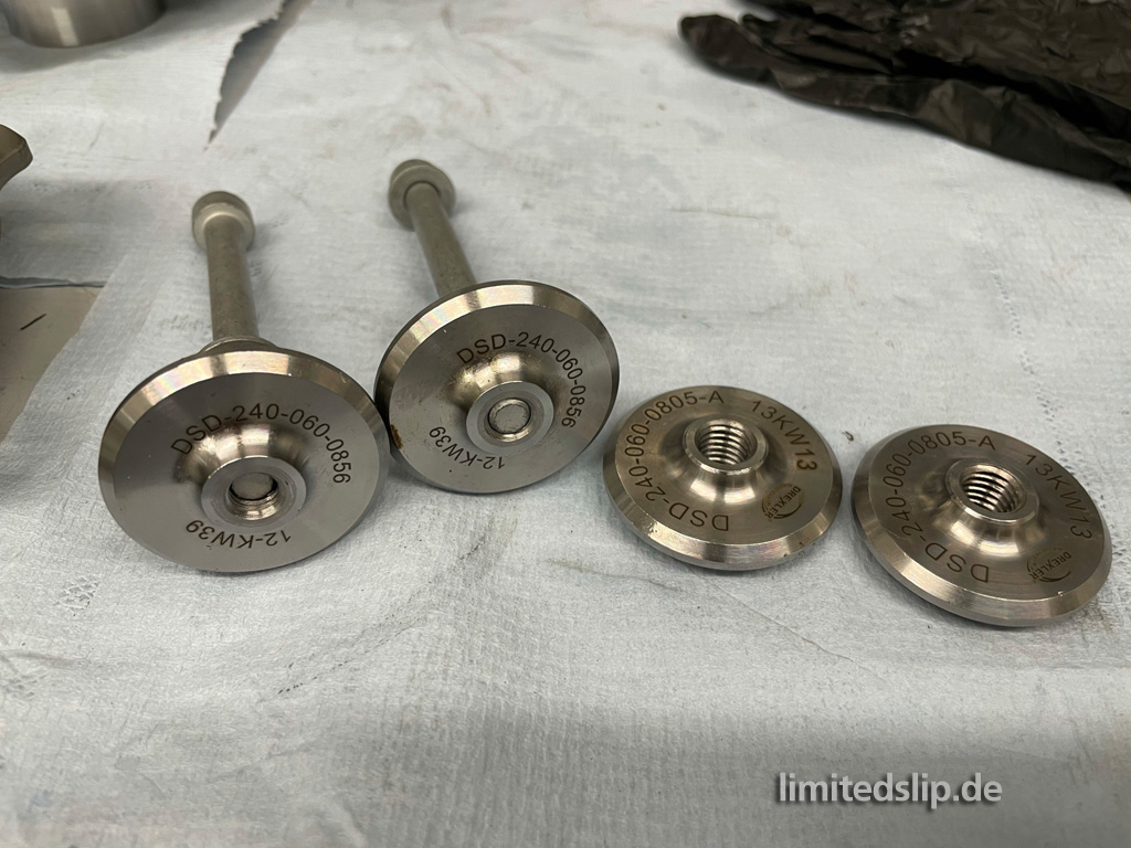

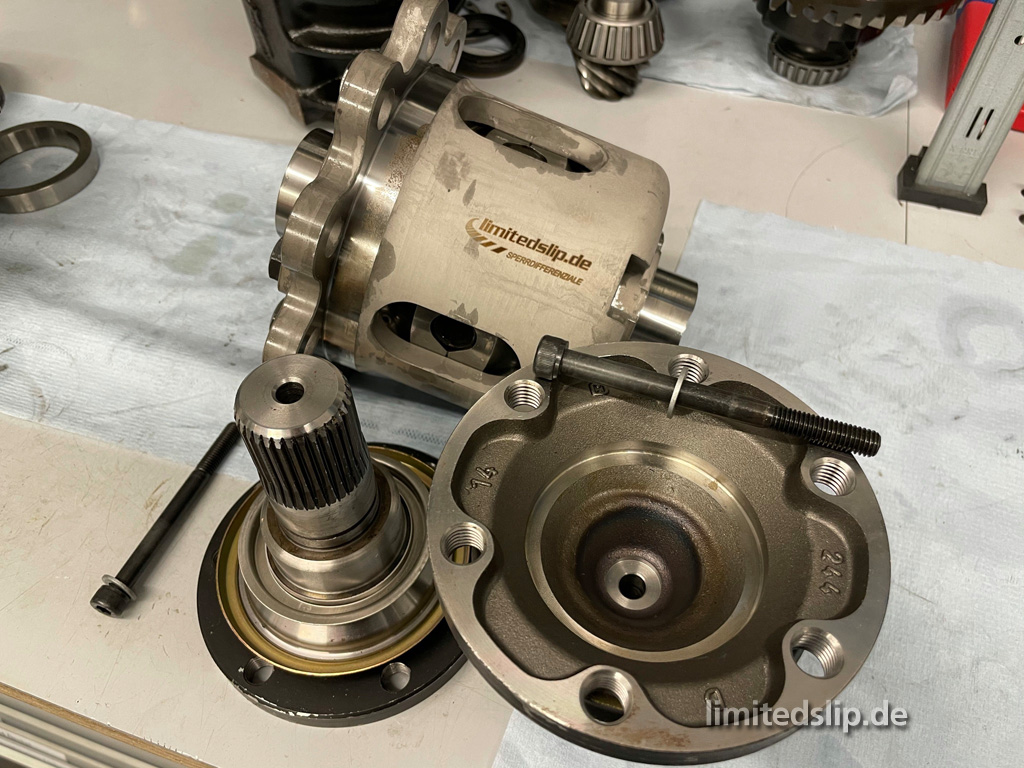

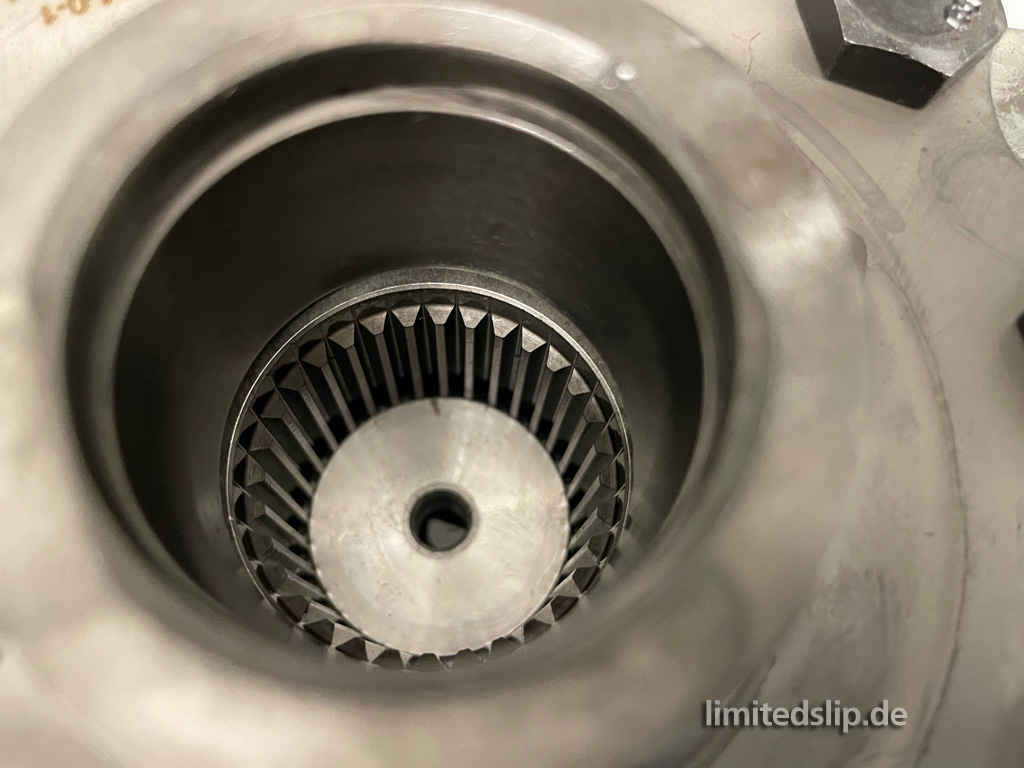

as promised here are the pictures of the gt4 goodies:
here you see the round nuts that sit inside the lsd core and the screws that hold the flange in place. in the left the GT4 version with M8 threads. on the right another bmw motorsport version with M10 threads!
here you see the nuts pressed on the axle bevel gears
all parts together with flanges with holes, screws with washers and the lsd core with nuts installed.
here you see the nut in place inside the lsd core
and finally, here is the solid sleeve for the pinion on the left and the standard crush sleeve on the right. the solid one is much harder to properly install but if installed correctly will lead to less stress and pressure on the bearings.

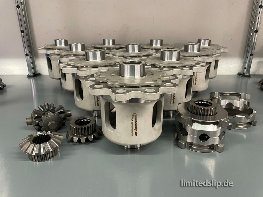

some interesting projects are in the making as well:
there will be a new high-end lsd core for m3 e92 available soon. it is my very own development (based on the zf/drexler architecture but with a special eye on weight and maximum performance with supersmooth engagement) and now it is close to a first prototype :-)
more infos and pictures here once it is ready! i am really looking forward to present it here!

i am busy building m3 diffs ;-)
if you want regular updates just check my instagram account:
https://www.instagram.com/limitedslip.de/
some interesting projects are in the making as well: there will be a new high-end lsd core for m3 e92 available soon. it is my very own development (based on the zf/drexler architecture but with a special eye on weight and maximum performance with supersmooth engagement) and now it is close to a first prototype :-) more infos and pictures here once it is ready! i am really looking forward to present it here! furthermore i am developing and installing the first drexler based G8x lsd core soon. the first diff is disassembled and there will be a GT4 like unit that i am currently trying to improve together with drexler concerning installation requirements to make it as easy as possible to get this into a G82. stay tuned...
