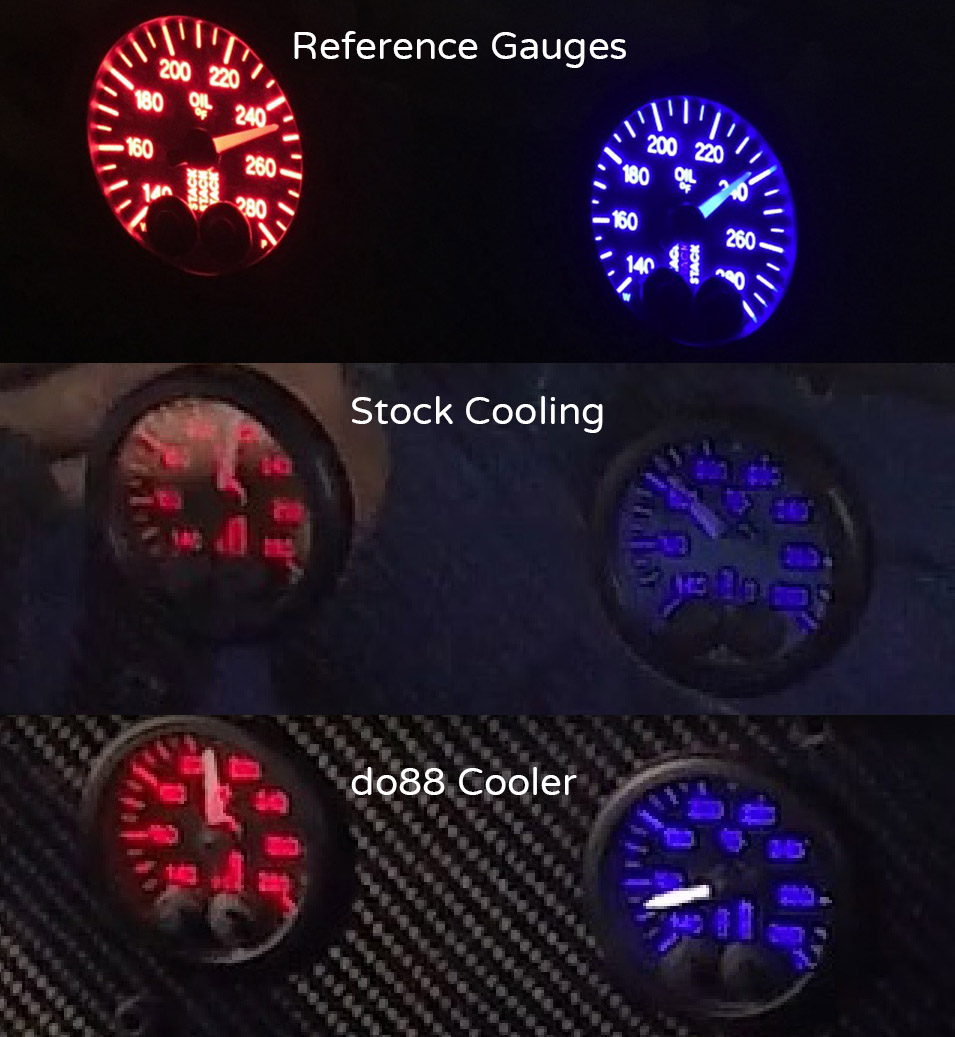

I wanted to give an initial update on the do88 DCT cooler.
I've been able to drive the new do88 DCT cooler a few times at Buttonwillow.
From looking at the temp gauge data, I can say that the do88 cooler is sending significantly cooler oil back to the transmission than the stock DCT cooler. It's coming back from the cooler in some cases 30+ degrees cooler than the stock cooler. As a result, the hot oil is leaving the transmission around 5-10º cooler than with the stock cooling unit.
In the image below, I've comped together three images. The top image is simply so you can clearly see the gauge numbers. The lower two images use the GoPro recordings inside my car to compare the stock cooler to the do88 on two different days at Buttonwillow during mid-60ºF winter air. The ambient air of both sessions was virtually the same temperature both days---only 1º different according to the AIM. And I ran decently quick hot laps in both sessions so the car had a chance to heat up in both cases. The images I captured were the max temps of the cooled oil in both sessions while running hard on track. (It's easy to quickly scroll through a GoPro video and see how the temp gauge needles move. I ignored temp readings when I wasn't running hard or was coming back into the pits because the cooled oil could get hotter since not as much air was flowing in and those temps don't matter.)
Results:
Stock OEM DCT cooling:
Hot oil leaving: 218ºF
Cooled oil returning: 185ºF
do88 cooler:
Hot oil leaving: 210ºF
Cooled Oil returning: 153ºF
Hot oil 218-210 = 8º cooler
Cooled oil 185-153 = 32º cooler than stock cooling
During this winter time driving, I'd say the do88 cooler seems to give you on average around 25ºF cooler oil returning from the cooler than the stock unit.
It will be some time before the air temps get hot again. I'll be curious how it performs when it's hot out.
As far as the vehicle's performance--I haven't noticed any changes in the car's driving yet. Honestly, it's only been a couple days. I'll drive it more soon, but I wanted to give everyone a head's up that I am satisfied that the do88 cooler seems to be having a positive effect.

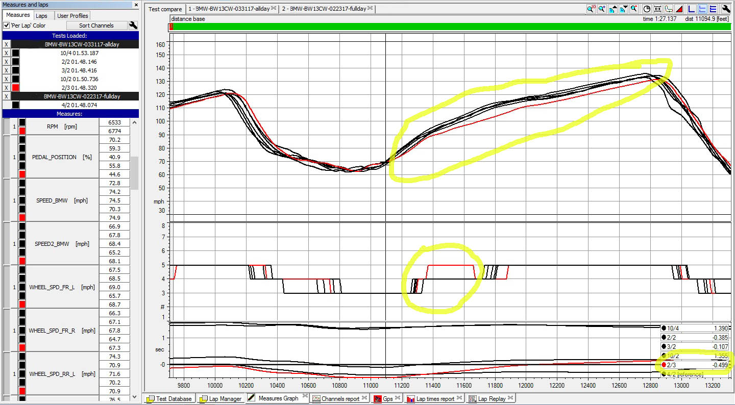

      04-04-2017, 12:12 AM   #384
dogbone
dogbone's Avatar
5564
2,863
Drives: '09 E90 M3 - IB
2009 BMW E92 M3  [0.00]
2009 BMW E90 M3  [0.00]
hehe let's file this latest installment under Analysis, but really, we should put it in the crying-in-my-spilled-milk folder.....
I hate to be the guy blaming the hardware, buuuuut.......I gotta blame the hardware on this one.......
On Friday, I was driving with Speed District at Buttonwillow 13CW, and I exited Sweeper 0.5 seconds faster than my fastest 1:48.07 lap from February. I was on a 1:47.6 pace with less than 3000 feet left. I exited Sweeper, started heading up the Esses in 3rd gear, shifted to 4th----and the DCT double upshifted to 5th. Argh! The acceleration was killed off. I battled the car back into 4th gear and kept going as quick as I could, but it was a mess. In all that stupidness, I lost about 0.6 seconds. The lap ended up as a 1:48.3. Up until that shift, I was on the fastest single lap of my life.
I took a screenshot from the AIM software to illustrate the mess. In the picture below, the lap in question is colored Red. For comparison, I included 5 other laps, colored Black. Some of the laps were done on slower tires just to illustrate how lame this moment was. The AIM software cursor is set at the exit of Sweeper at 11100 feet down the track.
The reference lap in this picture is a 1:48.07. The first thing to note is the Yellow circle in the bottom right corner. You can see that where the cursor is, the Red lap is 0.499 seconds faster than the 1:48.07. So, it would be fair to say that I am on a 1:47.58 at this point.
The next thing to look at is the small Yellow circle in the middle of the picture. This chart shows the gear that the car is in. To the left of the yellow circle, you can see that ALL laps are in 3rd gear as I finish Sweeper. Then at slightly different times on all the laps in the Yellow circle, I shift to 4th gear. But then on the Red lap, you can see the DCT shifts again to 5th gear. ARGH! It does this on it's own sometimes. I am QUITE certain that I am not pulling the shifter twice. You just never know when it will happen. It is quite maddening. So then you see I try to get it back into 4th, and then I finally go up to 5th.
The last thing to look at is how the speed was affected. The large Yellow oval at the top of the picture shows the comparison of the speeds going up the Esses. You can see that at the moment of the double upshift, the speed line flattens out and doesn't keep up at all with any of the other lines----even the speed profiles of 1:50 and 1:53 laps on slower tires......
This lap was the second 1:48 lap in a row, so the car had been under a fair amount of stress already. The DCT double upshifted earlier in this same lap while exiting Off-Ramp. I was able to get it back into 3rd gear quickly. I definitely lost a little time there too, but not like after Sweeper. I am finding that when I push the car very hard for a couple laps in a row, I get some unpredictability in the gear shifts. I don't know whether to blame the VF tune on the supercharger, or blame the GTS-DCT software......whatever it is, it's damned annoying. Does this happen to anyone else?

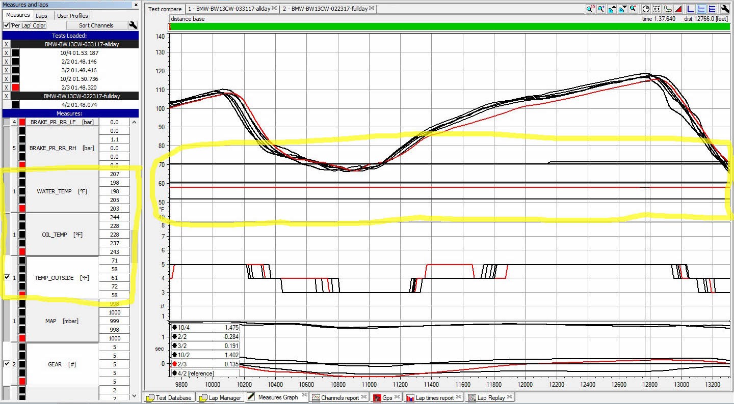

Originally Posted by M3 Number 86 View Post
can you bring in various temp readings into your graph? maybe there is a big change there?
Here's the chart with the ambient air temps included. I've highlighted on the left side not only the ambient air temps for the March 31 laps, but you can also see the oil temps and coolant temps. There's no smoking gun there.
The offending lap was 58ºF which is the lowest temp shown from March 31. The 1:48.1 was also 58ºF since it was the same session. (The lap from February was 51ºF, so on the graph you can see one more black temp line below the Red line.) And the oil and water temps were not outrageous.
On my DCT oil temp gauges, the hottest the hot DCT oil leaving the transmission got was right at the end of the second hot lap, which was 210ºF and the hottest the returning cooled oil got was also right at the end of the second hot lap, which was around 160ºF. These are also not high temps. They can easily be 225ºF-hot/190ºF-cooled on a warm day.

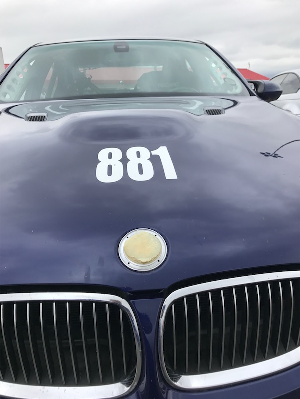

OK, let's file this one under "Badge of Honor".........
While I was at Auto Club on Sunday, I---uhhhh----lost something while I was on track. You have EXACTLY one guess to tell me what's missing.... (It was on there at the beginning of the day!)
Start of the day pic: It's on there! hehe----so does this give me some sort of bragging rights? Damn, now I need a new one.....
