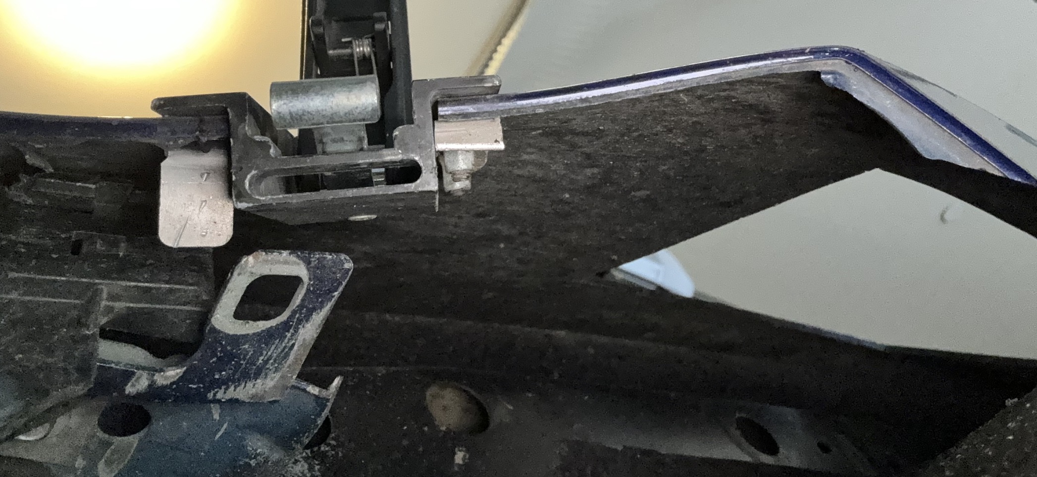

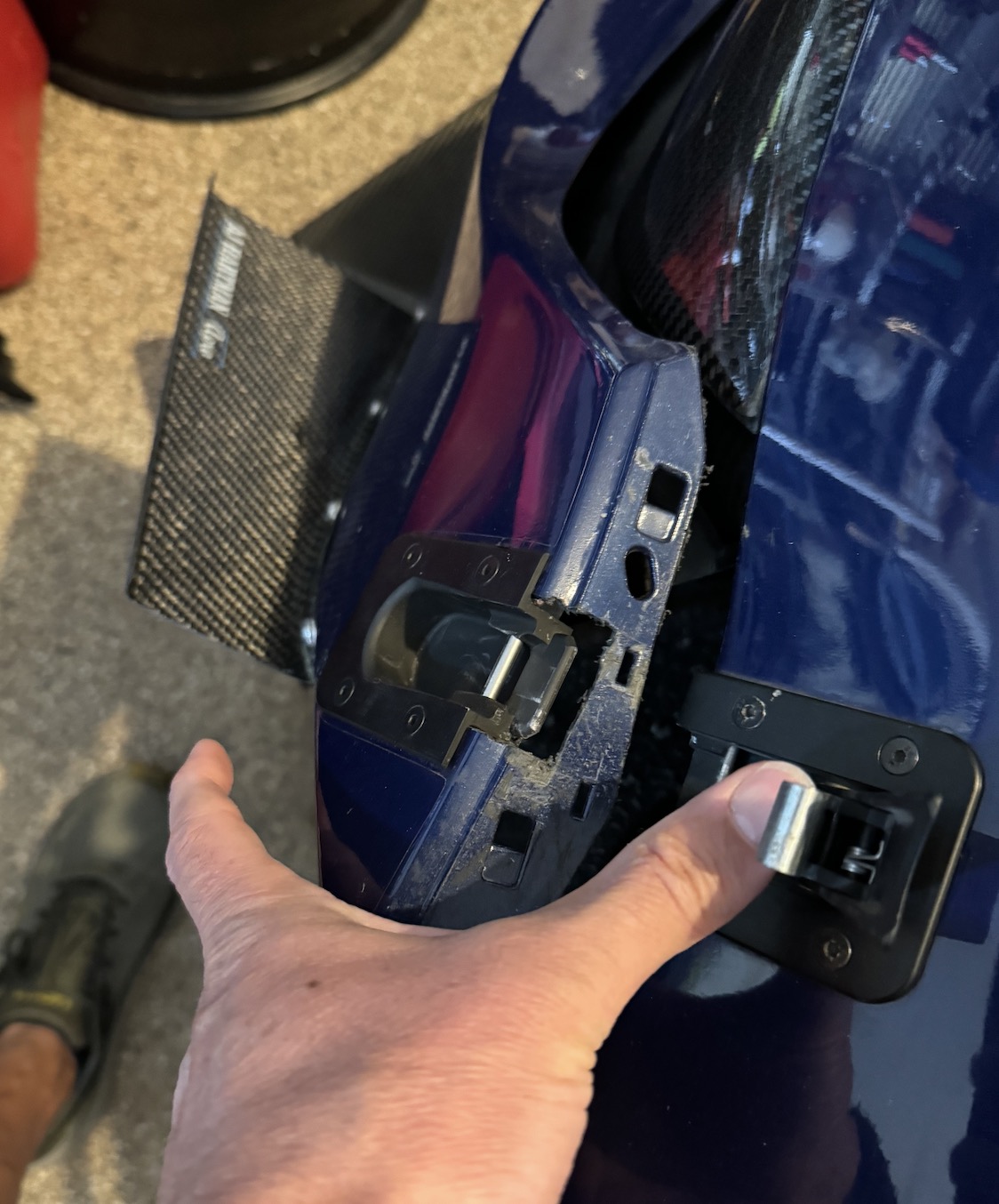

I just wanted to give you a HUGE thank you, dogbone ! If it wasn't for your detailed journal with the chapters, I wouldn't have found what I needed for the work I'm pursuing.
My fenders have literally stripped completely, so I can't "screw" them in anymore. I was going to just use some M8 rubber riv nuts (rubber riv nuts are better for applications that see a lot of vibration) and M8 bolts to repair it that way. But I figure since I have LW FRP vented fenders, I might as well install those once I figure out what to do.
Anyways, whether or not I use the FRP vented fender or my OEM plastic ones and add vents myself, the Aerocatch 3 (above panel) you listed and showcased in your build helped me decide on a mounting method that would allow me to remove the bumper easily. I did not want to deal with getting under the fenders and unbolting it, especially if I am now adding a front splitter.
Also I wasn't sure if you had any detailed images of that set up?
I personally don't mind hacking up my car to make small things like this easier...
Glad the thread was able to help!
On page 85 of the thread, I made this posting that shows several pictures of the latches: https://www.m3post.com/forums/showpo...postcount=1866
Is that what you were looking for?

yes that was perfect ty.
I think I have a general path of what to do now. ty. i think asking for how it looks like with the bumper off would be too much to do, since all i wanted to see was how it fits and what expected modifications to do.
When the car is in the garage (versus sitting at a shop for a year), it's easy to take pictures!
Here's a couple pix of the underside of the latch setup:
oh perfect. this is exactly how imagined it in my head, just a basic notch of the fender to fit the latches and call it a day
Thanks Gabe!

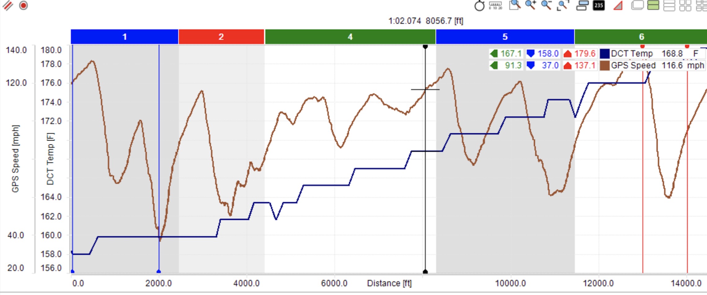

Sorry your tread came up when I was searching for DCT temp logging.
Did Aim ever get DCT temp working on the Solo 2 DL on E9x M3s? I found mention of it not working back in 2018, but when searching didn't see any updates of them ever fixing it, wondering if it's still an issue or not? Thanks!
It works. It's the dark blue line in the pic below.
rhyary was able to acquire the necessary info and get it to AIM, and AIM implemented it a couple years ago.
As it turns out, at least in my car, DCT temps are not an issue. (I do, however, have the Slon pan and the Do88 DCT cooler.)
