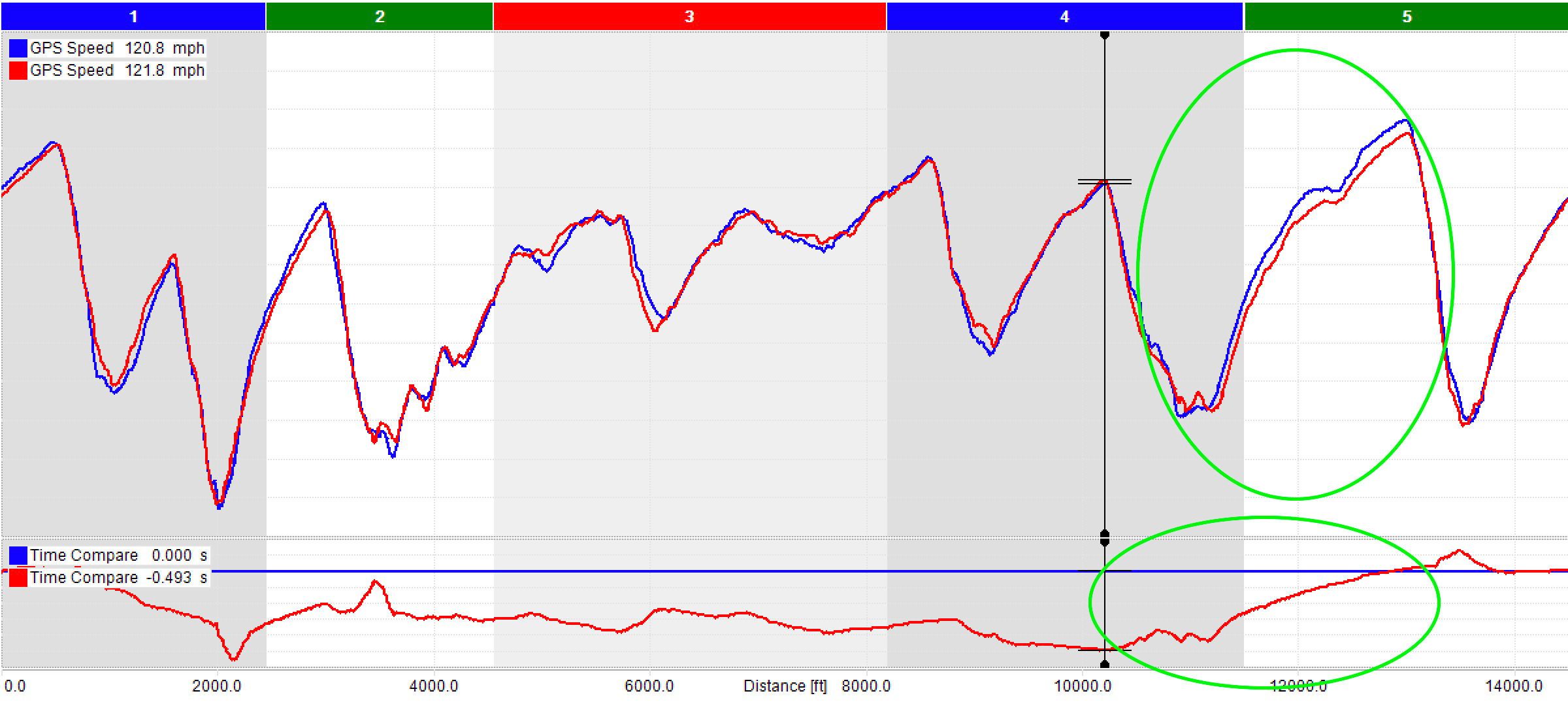

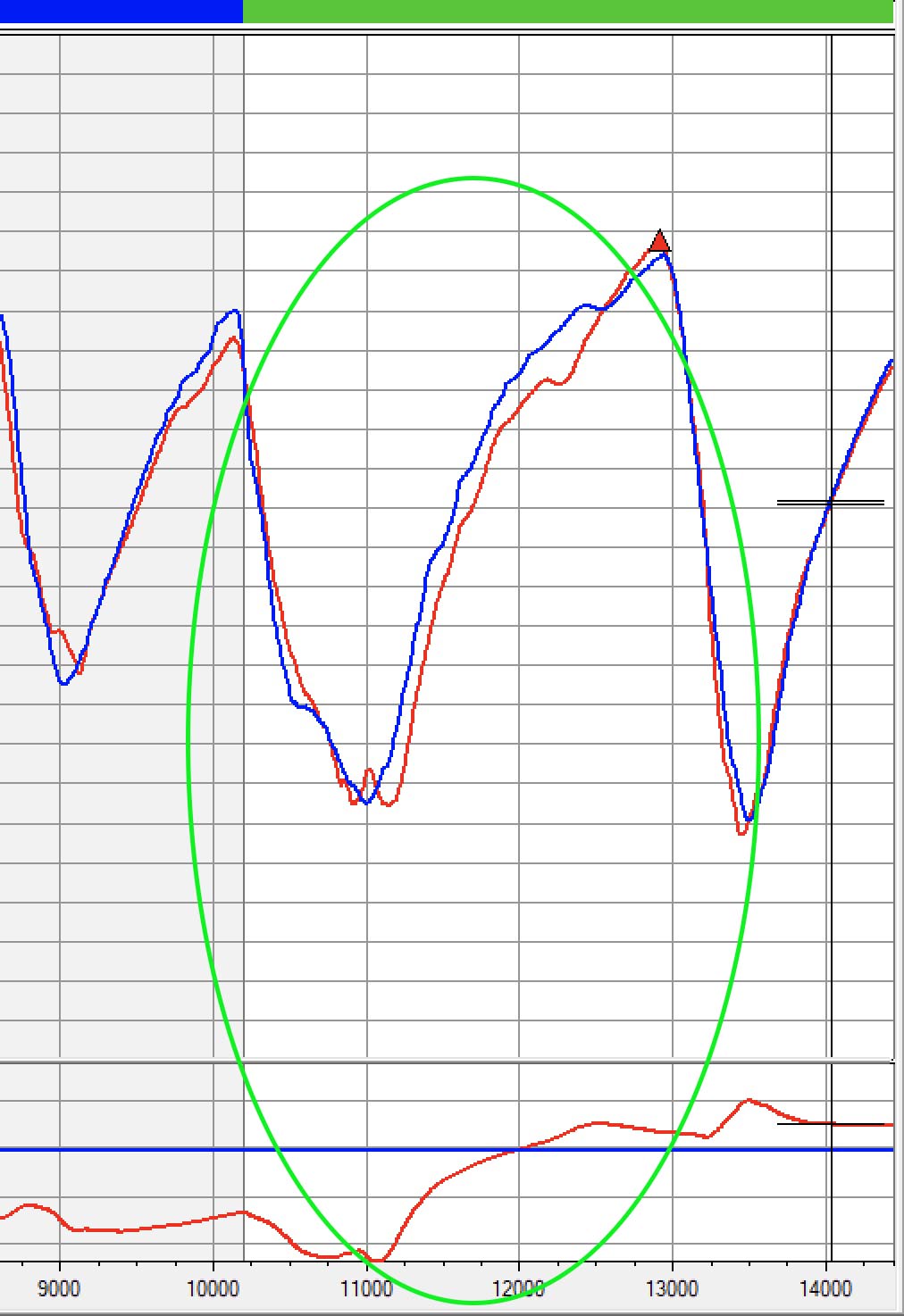

ok, let's look at a little data----Below is a screenshot comparing the two 1:47 laps that were in the video. The blue reference lap is the first lap 1:47.3, and then red lap is the 2nd lap that was 1:47.2---the one where the Sweeper exit was not my best moment.
What we can see here is that red lap's time delta line was below (faster than) the blue reference line for most of the lap. And where I have the cursor at the braking point for Sweeper, it was 0.493sec faster than the previous 1:47.3 blue lap. This puts me squarely in 1:46 territory for most of the lap. However, I got impatient in the middle of Sweeper and it cost me. You can see at the minimum speed of sweeper inside the green circle, I tried to accelerate a bit to keep speed up. But all this did was create more understeer and force me to have to wait to get on the gas at the exit of Sweeper. You can see in the speed chart that the red acceleration line is quite a bit to the right of the blue acceleration line, which means I got on the gas noticeably later. This is what cost me the time. And in the lower chart in the lower green circle, you can see all that 0.493second advantage vaporizes as I go up the Esses.....
My takeaway from this is that I need to enter Sweeper with as much speed as possible, allow the turn to scrub speed, and then stay off the gas so that my weight balance keeps weight on the nose, so that when I want to do the final turn-in to exit Sweeper in that decreasing radius moment, I have steering grip, and then I can get on the gas as early possible for the exit. The data seems to show that keeping speed up in Sweeper by pressing the gas creates understeer issues that force you to wait to get on the gas at exit. And since that's the beginning of a really long full-gas pedal section, getting on the gas as quickly as possible is the best choice.

Was great fun following over the weekend livestream.
Was really pullin for you on that 46 on Sunday, but I understand now how and why didn't quite happen.
In the sweeper on the red lap, it looks like you pick up a little bit of mid corner speed, was it maybe grip on that lap was a little better and it wouldn't take that throttle on the blue lap?
Love the data !

You may want to add steering angle to that section so you can see if you are steering more, but the car turn less
Love the data !
Thanks for checking it out! Yeah, on Sunday, it was cold and cloudy---no sun to warm the track at all. I did one warm up lap and then was on a hot lap. Just touched (didn't hammer) the inner berm on that left to go up to Phil Hill and as soon as I touched it, the tail stepped out. Been around that corner hundreds of times. Never had an issue. I chalk it up to the combo of cold track and relatively high pace. I think I just need to do two warm up laps when it's cold and it's the first session of the day.
On the lap where I lost the time on the exit, basically, I was dabbing the gas mid-corner trying to keep speed up, but what I ended up doing was creating more understeer since I was in a turn which forced me to wait 75 feet more feet to get on the gas....and that little hesitation cost me half a second. Just another example of how little things on track can have significant impacts on a lap time.
Yup, I looked at all that---steering angle, Lat-G's, gas pedal. My steering angle went up and the G's went down.....so I had to wait another 75 feet to get back to gas compared to the previous lap.
And the delay is even more obvious when comparing to the fast lap from 2018. In 2018, I would say I did a good job of bringing the speed down consistently and then getting the heck out of there quickly. I mean, look at how much further to the right (later) the acceleration red line is than the blue line. And that nets a result of being over half a second faster than the 2022 lap just in that exit......apparently I need to go back and watch my own videos more.....hahaha
You've made the comment before that I dab the gas mid-turn. I get impatient. This time the result was a notable time loss.
